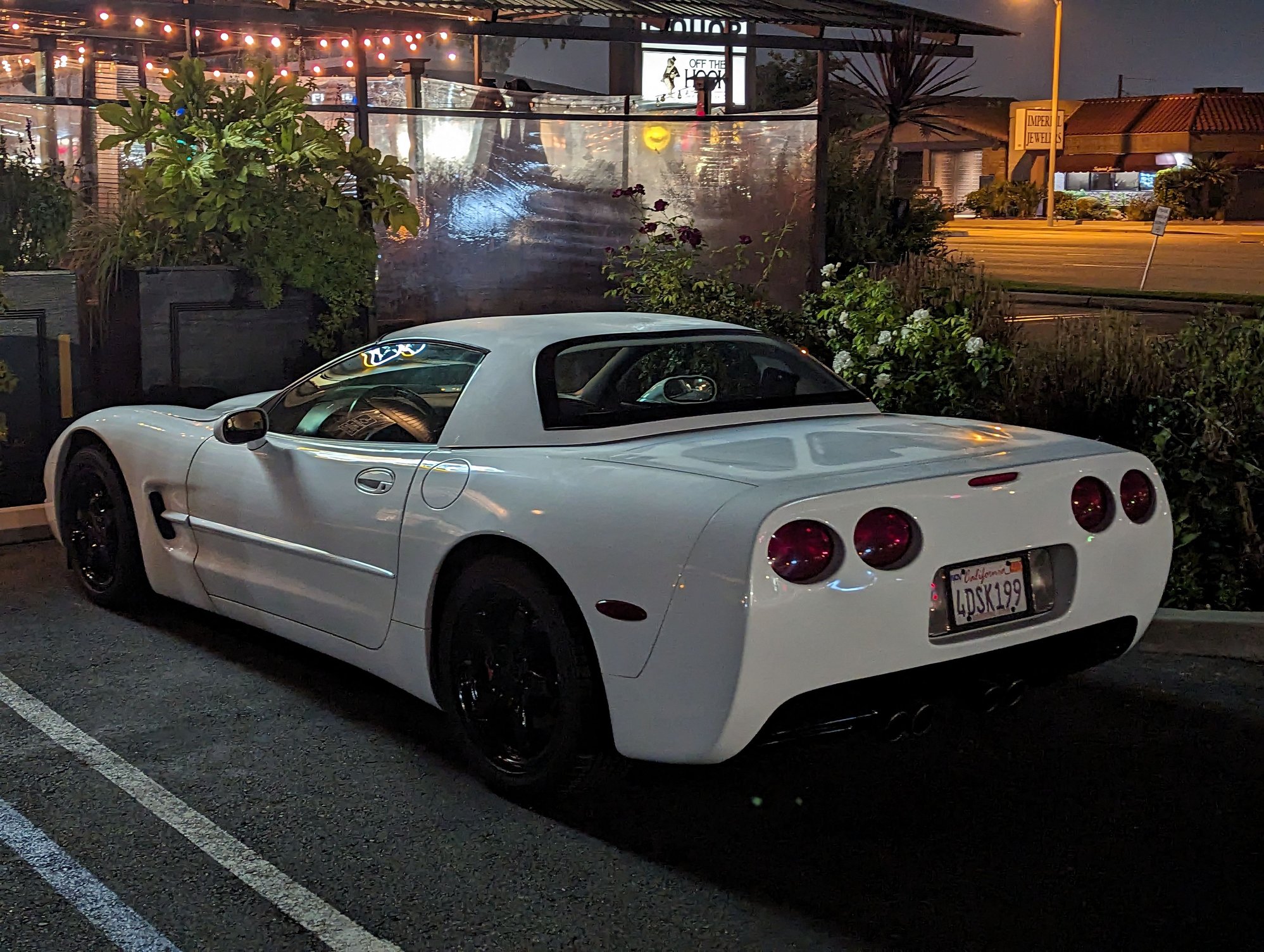

175000 miles on my '99. ECBM, no problems. Tanny, rear end never opened. Torque tube bushings beat up, rubber under the chassis, and other suspension links replaced Overall, not a lot of maintenance over the years. New seat covers and carpet a few years ago. Need to fix the passenger power door lock now. '99 last year to have key locks in both doors. Only reason engine replaced was to make it go a lot faster. I have no regrets having bought the car. George.
