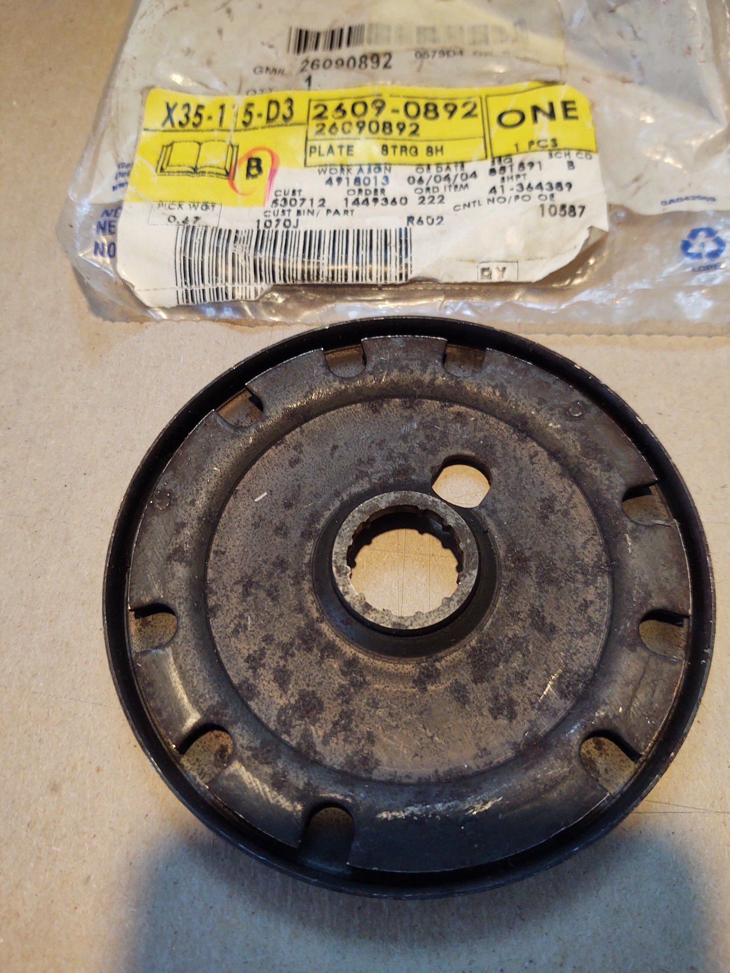

I find it rather interesting that people either swear BY the LMC5 or swear AT it...... FWIW, I installed one on my C-5 about 3-4 years ago, and have had no issues with it.
This is a picture of the backside of the C-5's steering column "lock ring". The "cutouts" around the perimeter of the part, are the places where the lock pin can engage, and lock the column. About 18-20 years ago, I purchased a second lock plate, checked it in a lathe, and trimmed off the area where these cutouts are, then installed it on my car.. Between this mod, and the LMC5, I no longer have to be worried about my column locking up.
