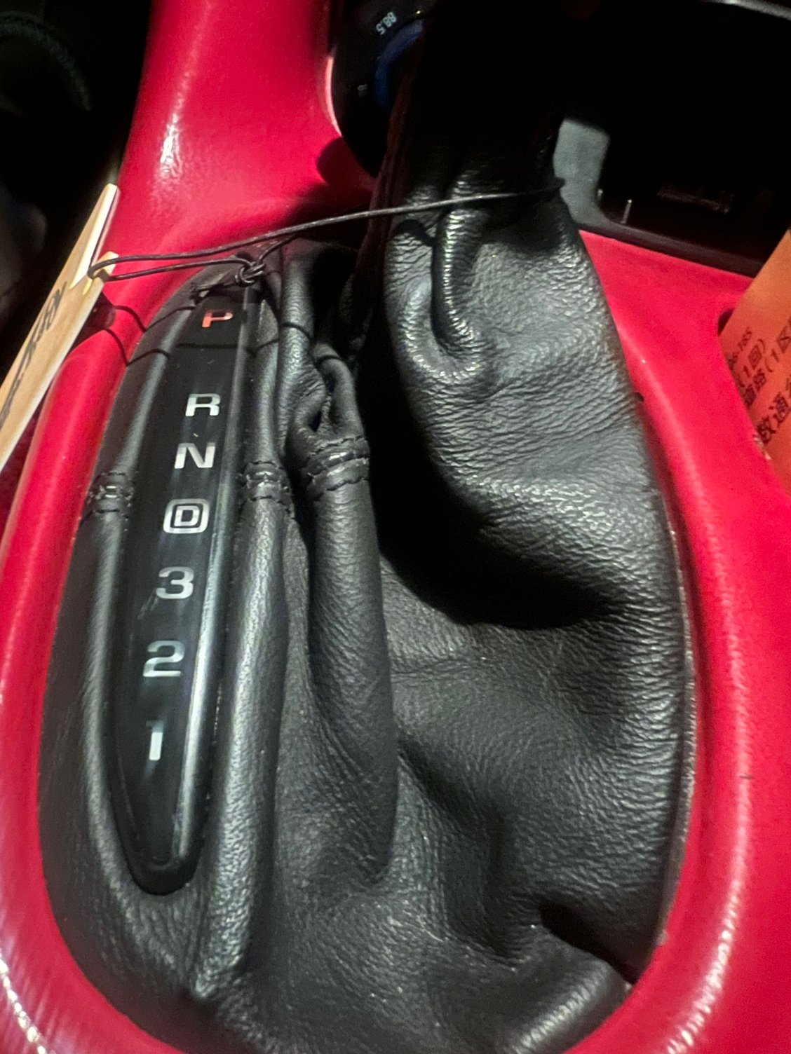

I recently discovered this 1,2,3 numbers on the left. This is a automatic C5 but when I tried it out it looks like a 3 speed manual mode. Does it mean that this 1,2,3 numbers can be used as manual mode on my automatic C5??

3 speeds and a lockup converter = 4 speeds

Agree it is a 4 speed. If you put it in 3 (which is D in other cars), the tranny should shift normally but not go into overdrive (OD). Place in 1 or 2, the tranny should remain in those gears.

In 3 it will not go into 4th which is considered overdrive, but in 3 or D it will downshift to 1 or 2 or 3 depending on speed and engine load.

does that mean I can use it in manual mode?
I can shift it to 2,3 anytime while I’m racing or just race dragging correct?
If I used the 1,2,3 gears.

this is pretty standard.
If you put it in 1, it will stay in 1, and not upshift to 2.
You can start in 1, and then shift into 2 ... if the rpms are high enough, the car will shift into 2.
And so on.. if you start the car in "2", the transmission will start in first, then shift to 2 and stay there.
So yes, you can kind of use it in "manual" mode, just realize it's not really manual. What it really gives you if you're using it in drag racing is the ability to upshift at higher rpms -- i.e., hold a lower gear longer.

Also note what may work in some cars may not work in others.
Most in 3 will just stay in three. Some will just have an L and that will put you in second gear for low tractions conditions.
Some in a manual mode will down shift if you have not already done it.
Read the owners manual in what ever you are driving as there are a number of things that can happen depending how it is programed.

On a C5, like many GM models around the 2000 model year, they had a feature called 2nd gear start. For low traction situations. You will find that if you put the trans in 2nd gear at a stop light in a C5, it will leave the stop light in 2nd gear, and stay in 2nd gear......

If you start the car in "2", the transmission will start in first, then shift to 2 and stay there.
If you start moving while the transmission is in "2," it will start in "2." No start in "1."
1,3, and D.........start in 1
2.....starts in 2

The fact is that the A4 when in 1st will stay in 1st to the rev limit. It will not shift out of 1st.
Same with 2nd.
