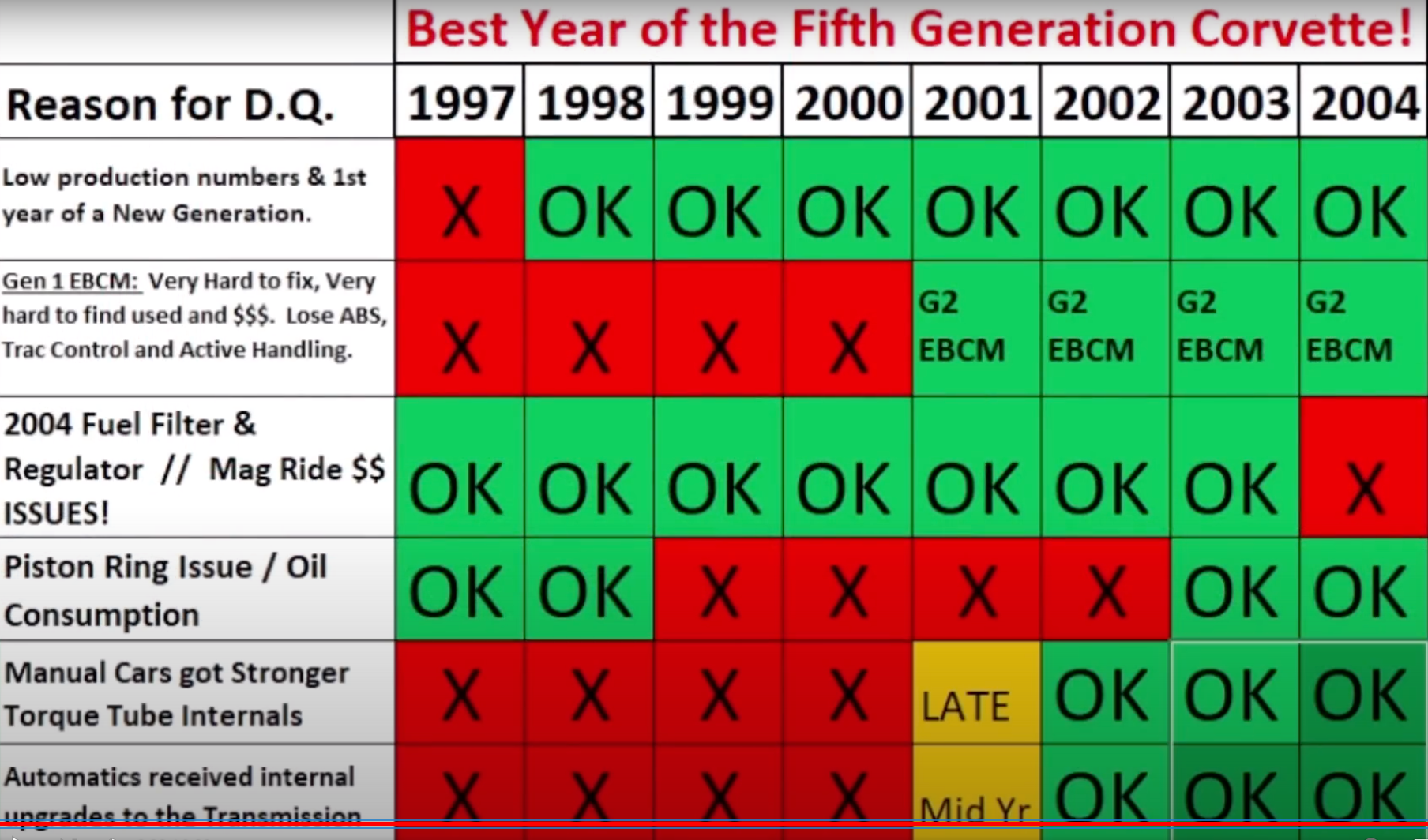

I've been interested in buying a c5 Corvette and know that 01-04 is preferred. But other than the ebcm issues on the pre 01s is there any reason to not consider one of those?
​​​I think my goal would be to buy a 03 because it seems like that may be the best year. But I would like to hear first hand experience on the others. but some issues I hear about the 99-02 is oil consumption due to faulty piston rings. Have any of you experienced this? I don't really want to buy my first fun car and have to tear into it due to issues.

Welcome to the forum! I think you are the right track as far as model years to look at. There were several updates done to the car over the run. The newer car has more power, and there a several parts that are cheaper and easier to find than on the early year C5s. As such the newer C5s are worth more.
As far as modding is concerned, the C5 is a great platform. If you're going with an automatic, I would limit your search to cars with the performance axle option. This has a rear diff gear ration of 3.15. This will make a big difference over the 2.73 that comes standard with the A4. Either way, the stock $L60E will be absolutely reliable up to around 450 wheel horsepower. You can get lucky if you push beyond that, but you're probably living on borrowed time. As far as performance mods for the street, it's hard to beat an A&A supercharger kit. This will give you an easy 500RWHP. Unfortunately, you will want to look at aftermarket transmission options at that point. When I had mine installed, 3rd gear shredded on the dyno. The advantage to a supercharger is that (unlike a cam swap) the car is still great on the street. You can drive the car like normal (with normal fuel economy) and it is smooth and docile just like if the car was stock. However, if you want it to, the car will go like a bat out of hell. It's the best of both worlds. Smooth and sensible for when you're in traffic, but a beast for when you want to fly.
