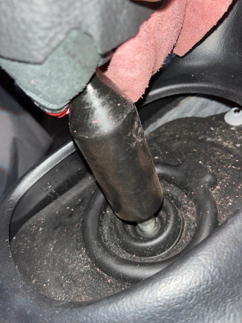

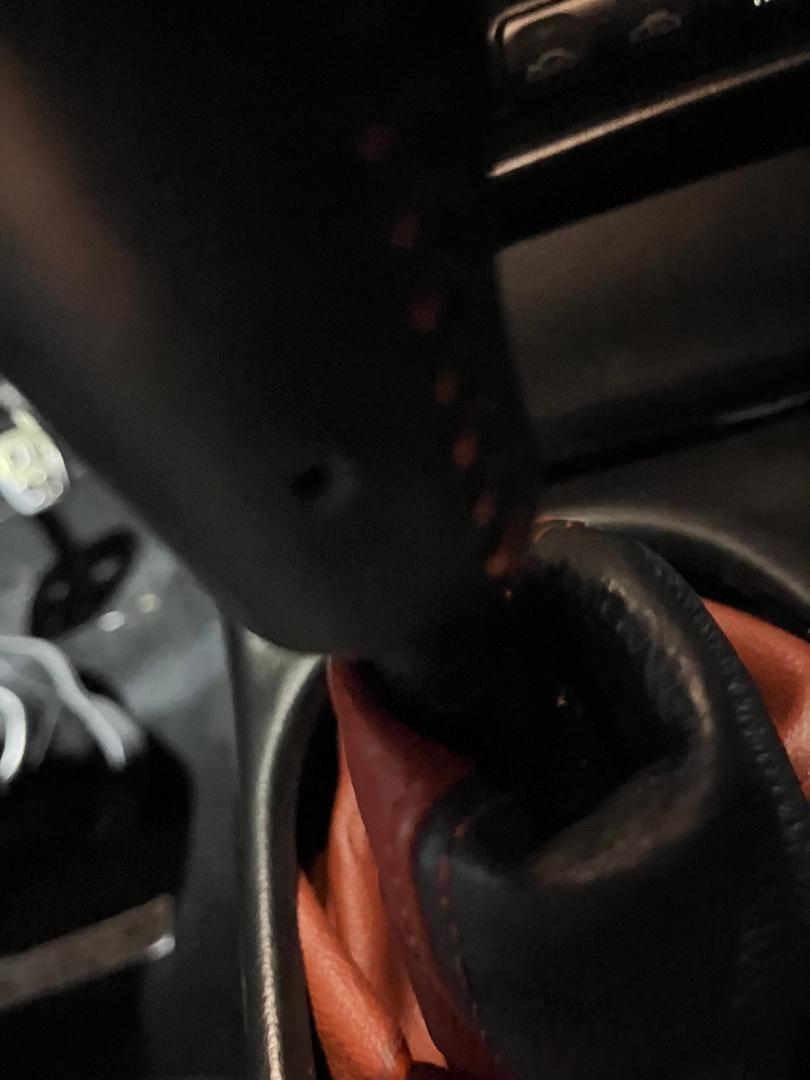

Uploading photos as requested. I am trying to change my boot and I cannot get the shift **** off. I embarrassed myself in front of my 12 year old ( as we are working on car together). My guess is a GS creations C6 shift **** on stock C5 shifter. My new car is 2003 C5Z. See photos please help.

Yes didn’t budge. It it a c5 or c6 shifter? See the little Allen wrench bolt in c6 **** handle ?

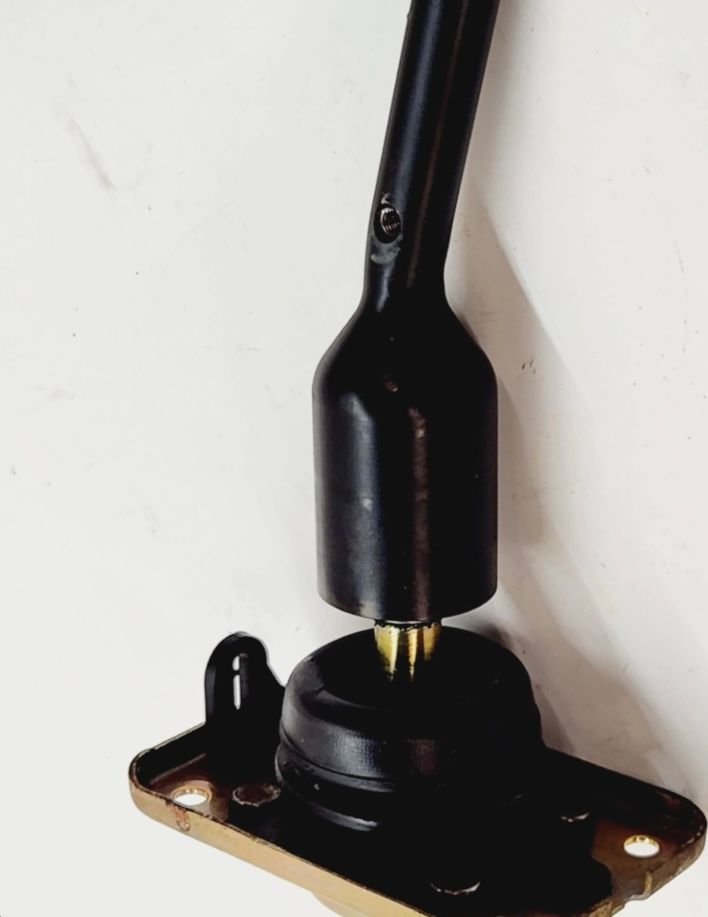

There are only 2 differences between C5/C6 shifter:
  • C5 shifter is straight up, C6 has a "kink" at the top
  • C5 shifter shaft is threaded at the top, C6 is unthreaded but has a shaped section the shift **** slides onto with a hole for a screw
To me that looks like a C5 shifter.
Yep, the C6 shift lever has a smaller (shorter) insulator, with as you say a kink in it vs. straight.

so guys- you saying all I need to do is turn counterclock wise? I did take the small allen screw out of shifter.
I didn't notice this screw & its location in the pictures you've already shared. Can you photograph where the screw came from? Just wondering if that screw was used to keep the **** from rotating (on the threaded **** shaft) or otherwise.

Yes, the C5 shifter lever is only a threaded rod, that's the only possible way your **** is still holding on so tight...maybe it's got red loctite on it!

see small hole in C6 **** for allen screw (which I removed).

^ that's because the C6 shifter shafts have a thread for Allen to screw into... the C5 shifter does not
I'm telling you man just twist it off
