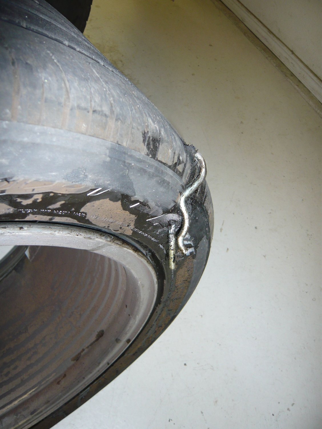

As long as it is not in the sidewall, most tire manufacturers would say yes.
Here is one that cannot be fixed-
