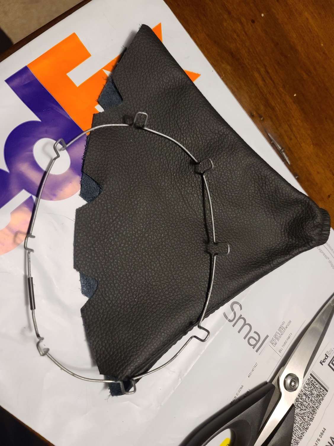

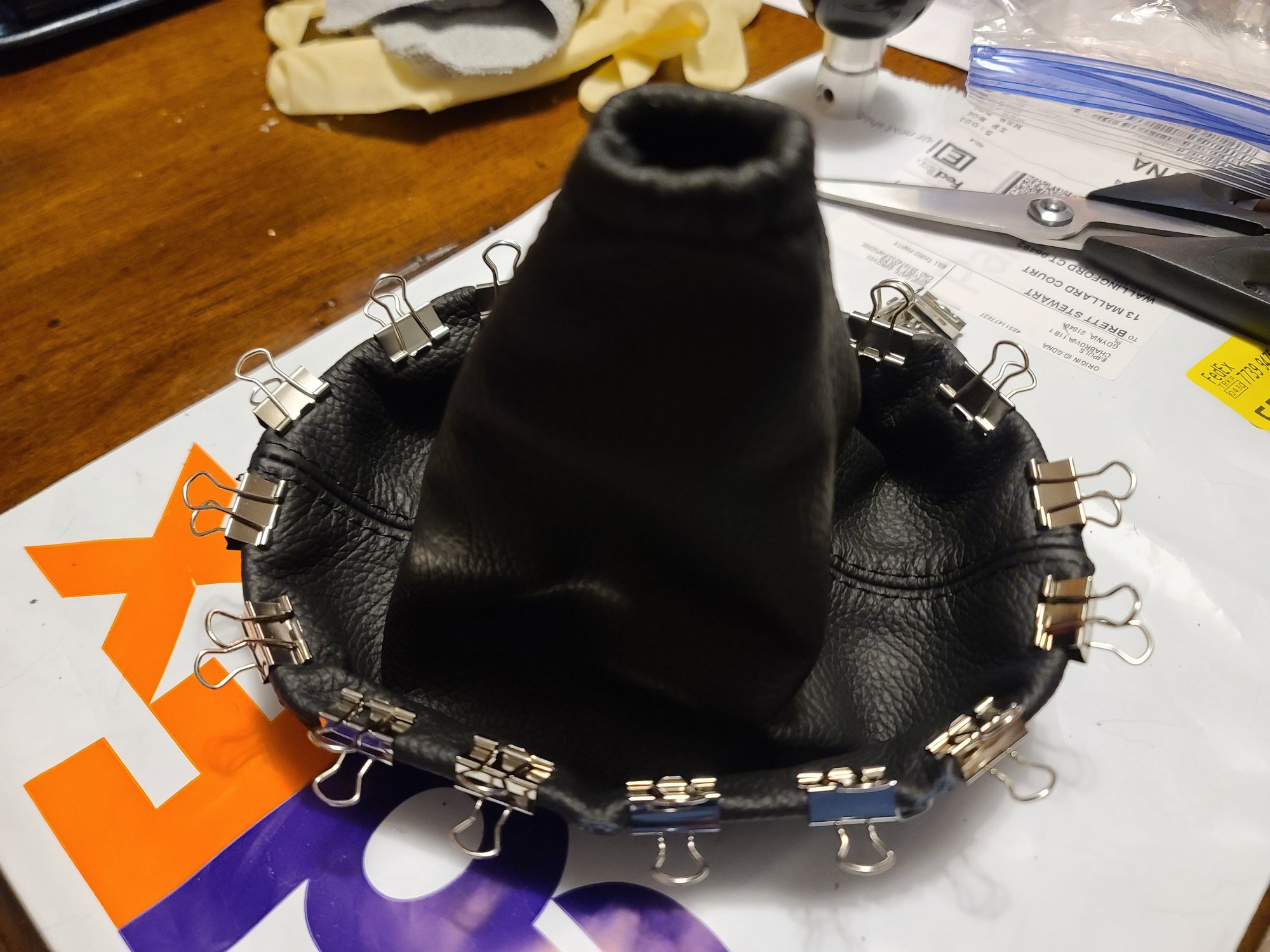

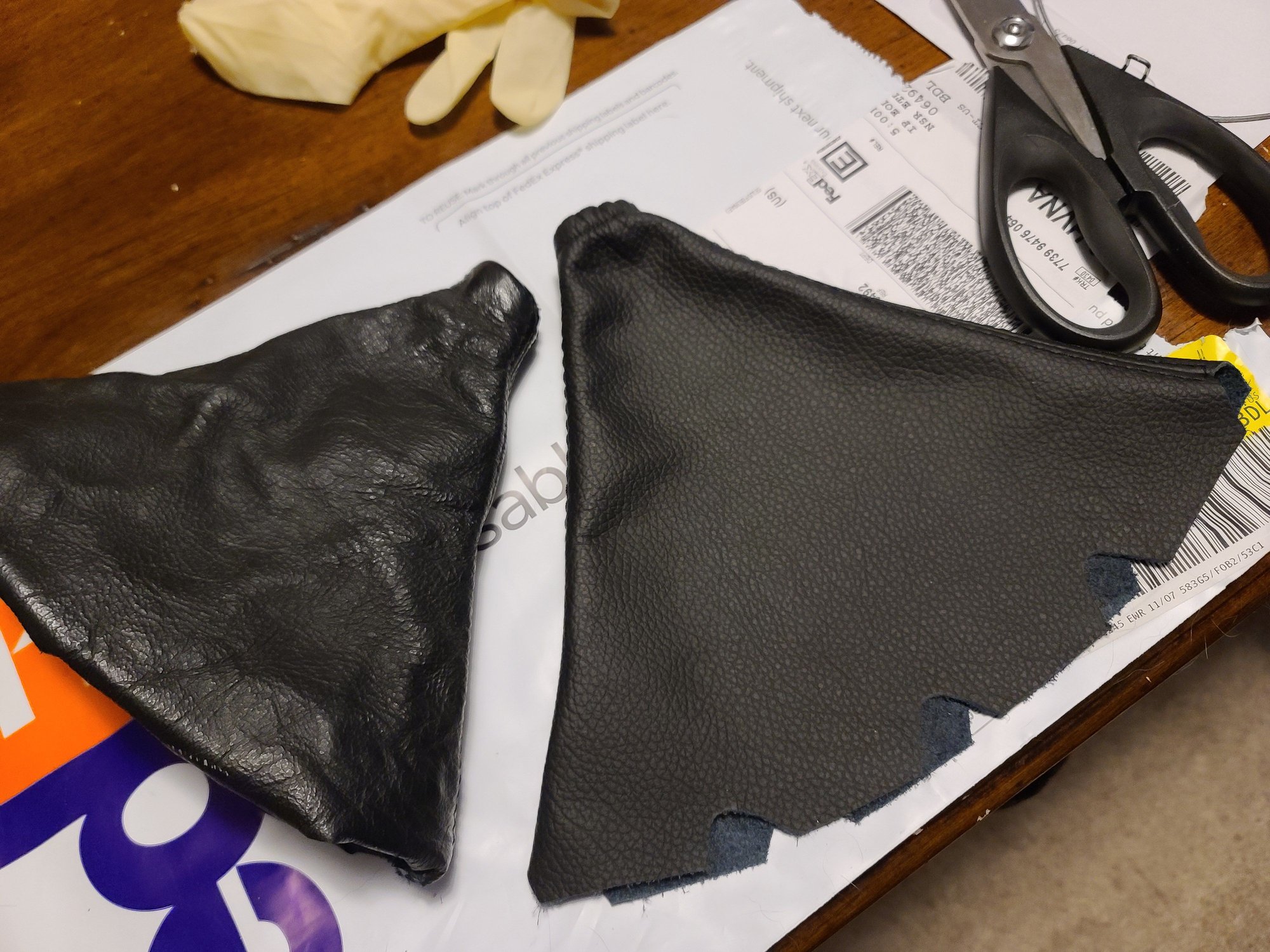

Here are some quick pics as I sliced the ebay metal ring out of an oem leather C5 boot to reuse in the new boot intended for the C6 Z06 shifter I'm mounting in the coupe.

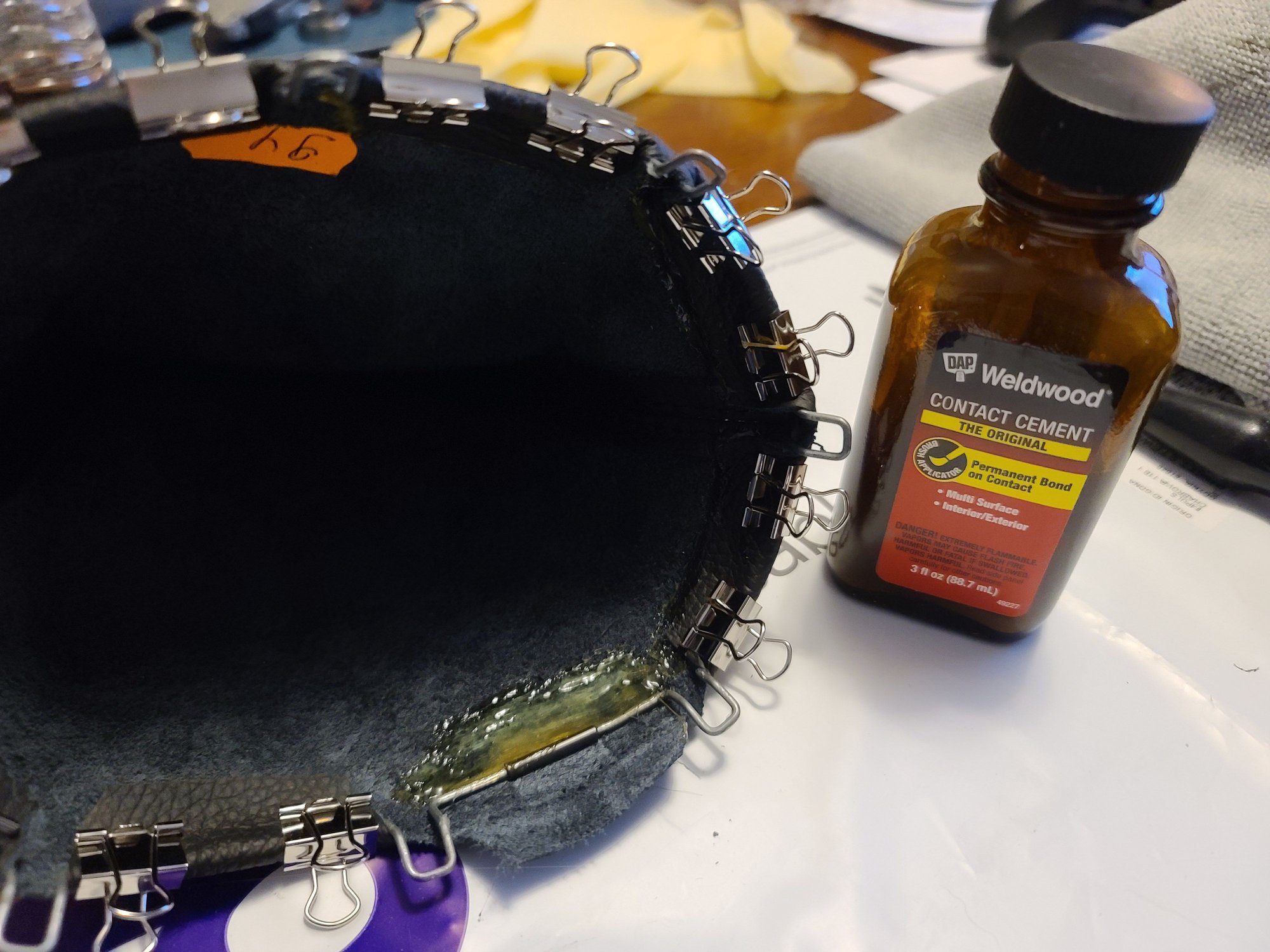

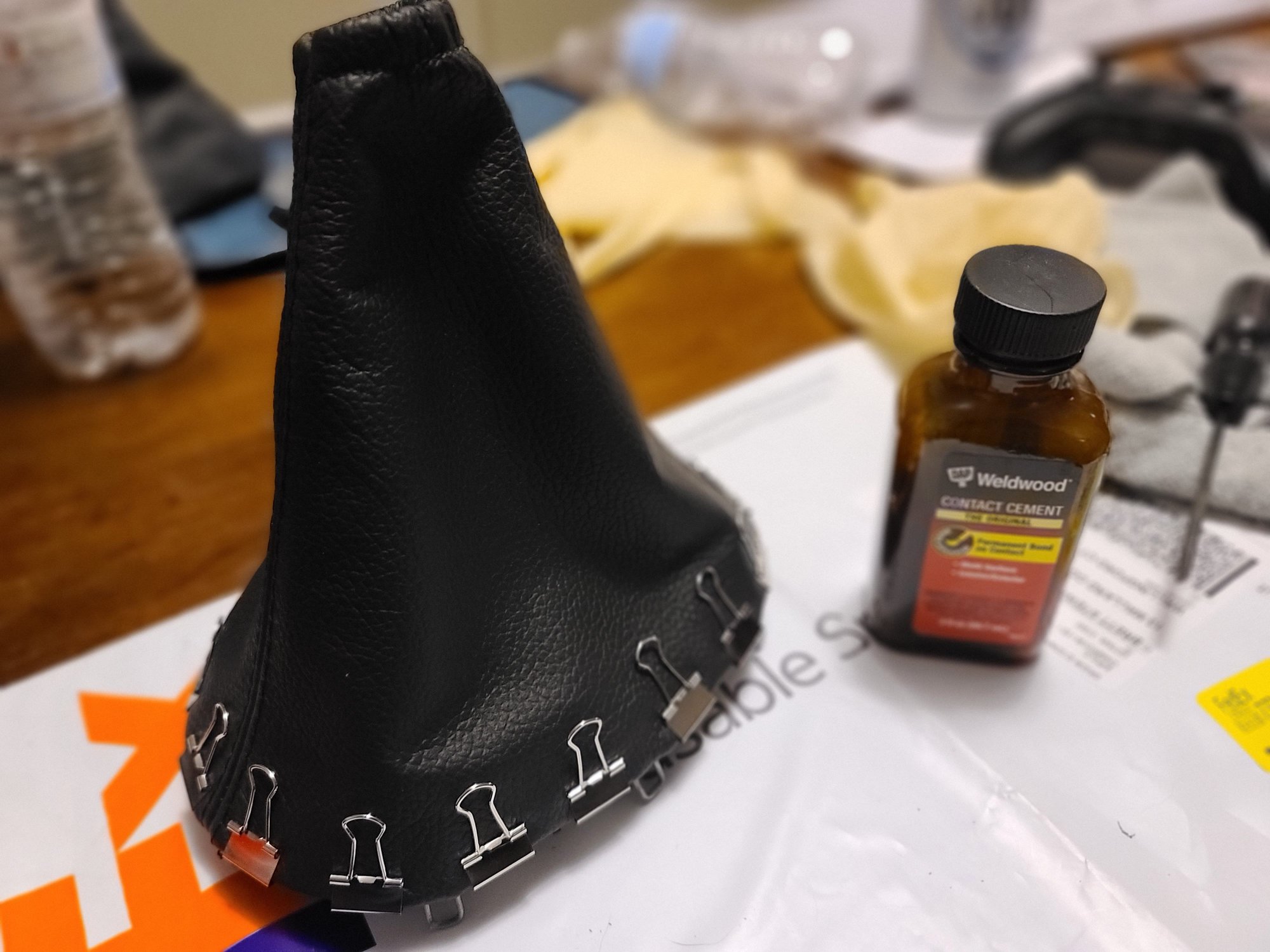

Glue of preference is DAP Weldwood contact cement. Well shaken. And some dollar store gator clips to align and hold the leather in place. I've done with eith JF-Customs suede for the Z06 and here is regular black leather for the coupe to roughly match the arm rest I had installed a decade ago.

The finished product looks great. I see one spot I'll want to go back on later to adjust slightly where when you press the boot down into the cavity it rotates inward and exposes the edge near one of the metal prongs, but that's all and it's a minor detail.
Good product. Easy project.
