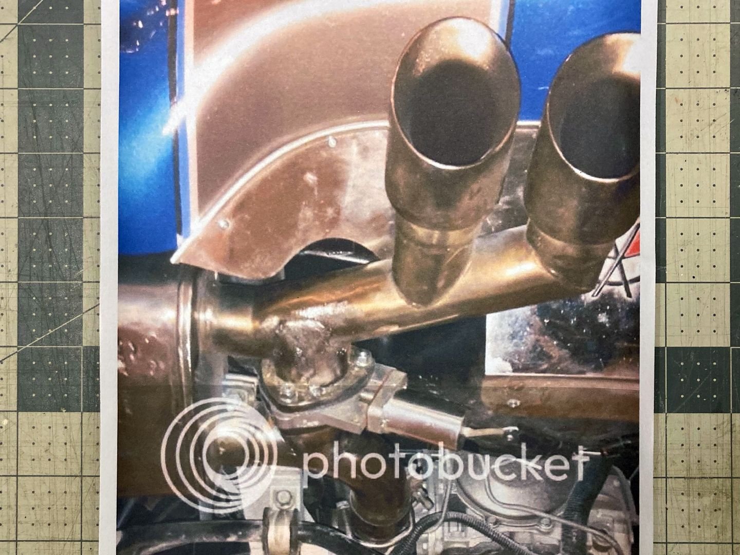

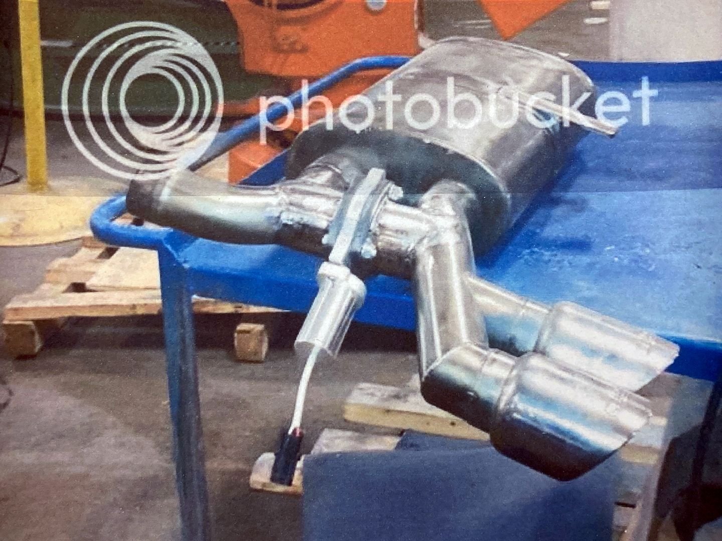

4) An exhaust-bypass with valves at the muffler makes the most sense, but the pictures of this mod "StrangeglovesM6Vert" had posted on CorFor are now missing: https://www.corvetteforum.com/forums...t-cutouts.html
Seems this would be easy on Corsa Extremes, but he did this on Corsa Tourings (I had printed them out, so here they are, so you get the idea):
I was thinking of trying to do what Strangeglove did, but I'm not that good a welder, and wasn't sure I could position my Corsa tips just right afterward. I was planning to use a vac & valves off Amazon, shown here:

Use the old bypass trick - as in the video above, but use full size tubing. That's the ideal place to put a bypass actuator. When it is not in use you have a standard quiet exhaust. When it is in use, you have an open pipe.
