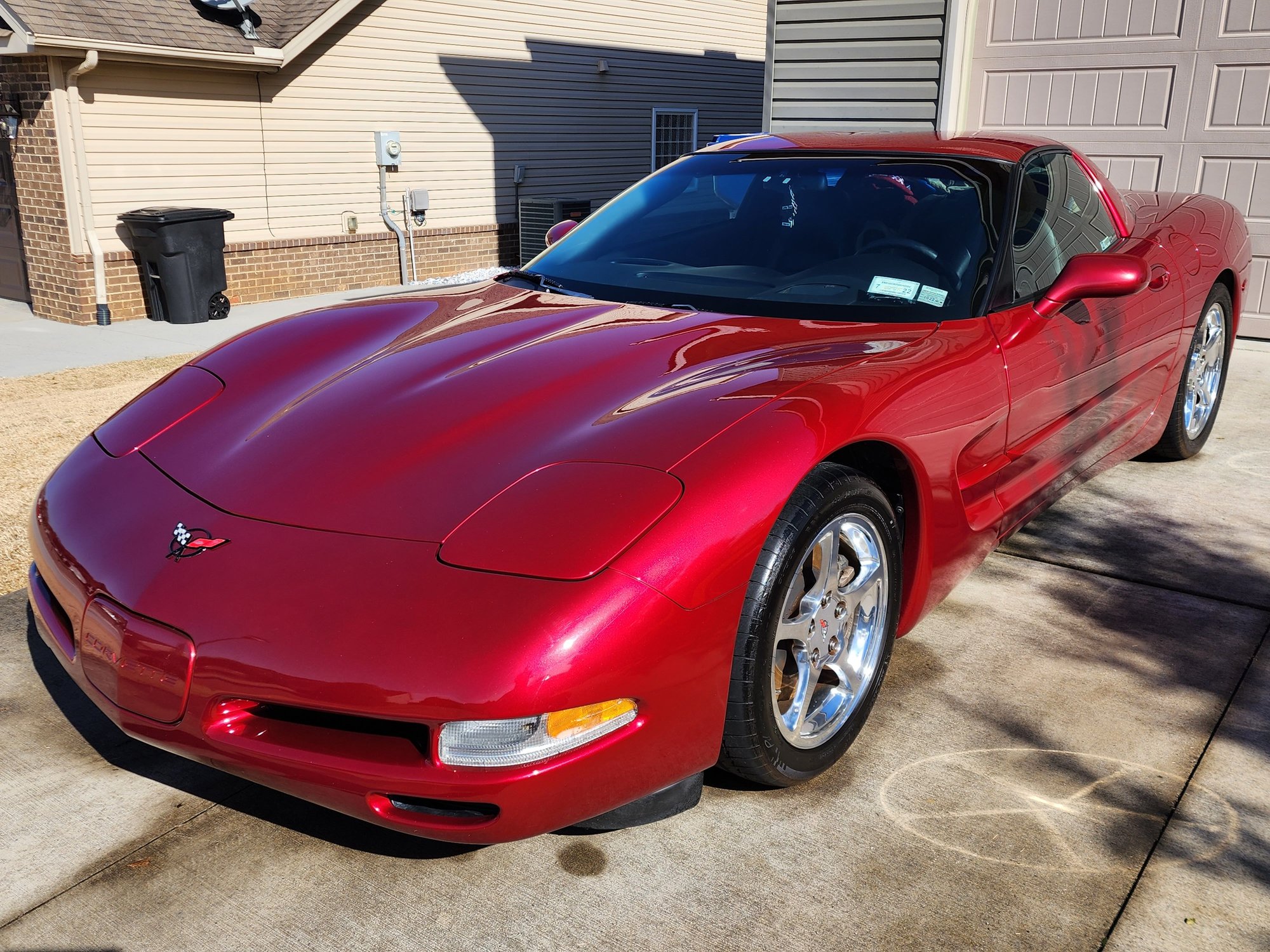

Greetings again everyone!
I need to change all the fluids out on my 2004 Vette I inherited from my dad so I have a proper basepoint to move on from. What I would like to know is what kind of brake fluid and gear oil (manual transmission) you have used and have proven themselves to be a reliable investment. I'm running everything stock at the moment except after market exhaust, K&N CAI and a basic tune when those were installed. I assume prestone dex-cool 50/50 will be okay for coolant unless there is a better option available? Being it's an older car I'm wondering if there are things that would work better for this car. Currently at about 31k miles. Thank you for your time and I am open to any and all suggestions
