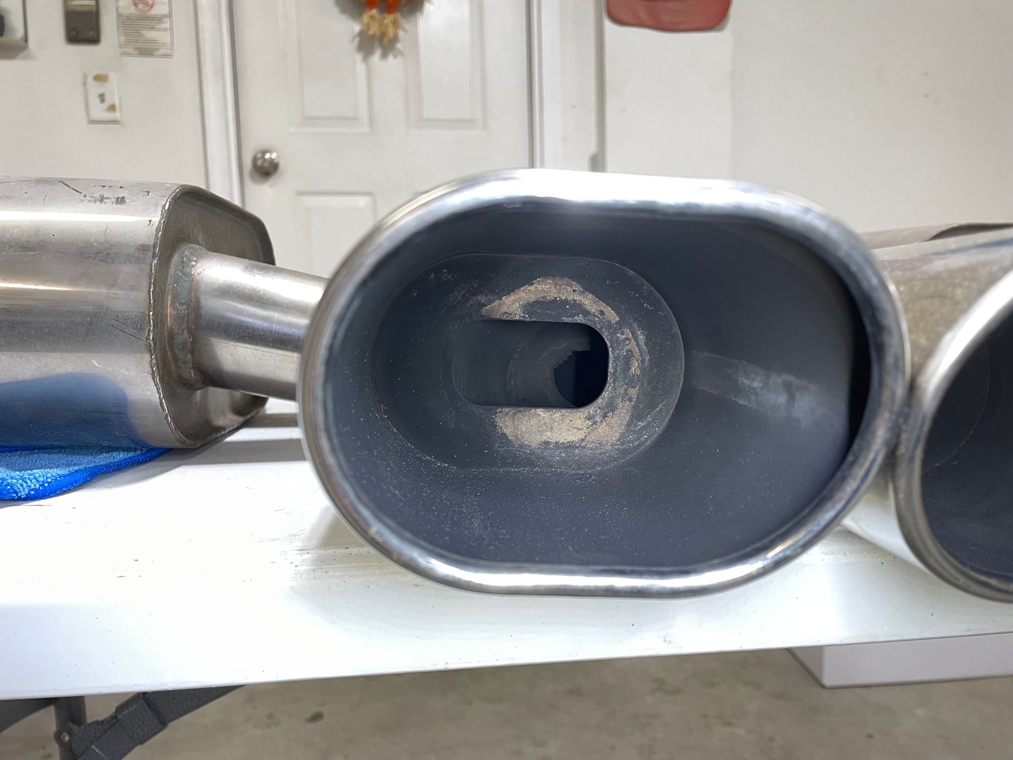

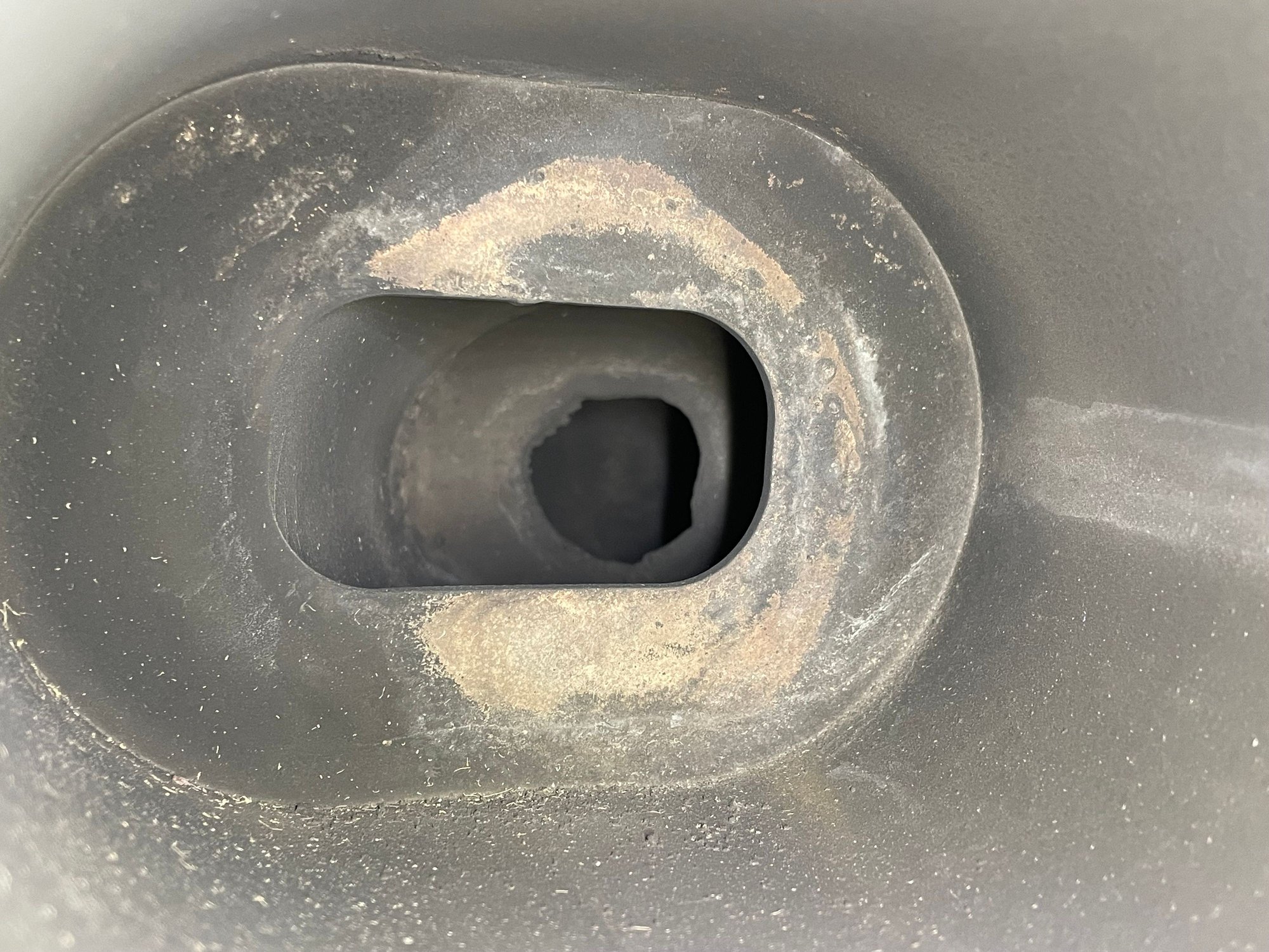

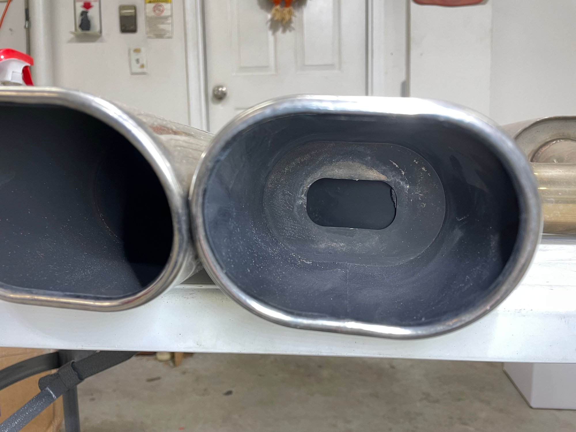

I always wonder what makes things tick so I took some pictures of them before cleaning them up. Some interesting use of baffles/diverters to control the sound.
The tips have oval baffles:

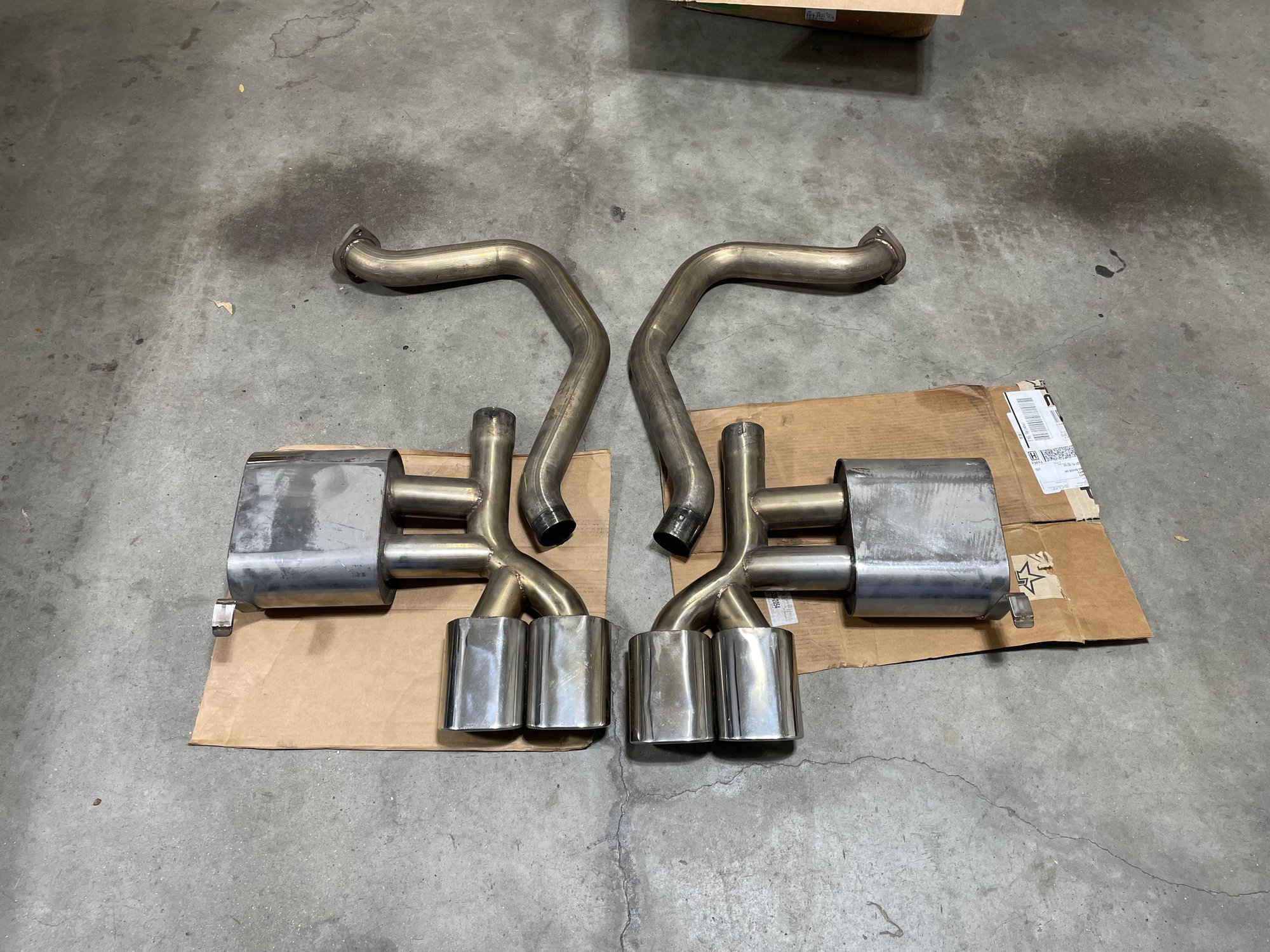

Looking at the inlet side, there are some cut/bent diverter tabs to direct some flow to go into the muffler case. If you look close you can see daylight through the tip:
I like the oval tips more than I thought I would. They fill up the rear bumper nicely.
Overall these are a good sound. They offer a much deeper tone than I thought they would given the design compared to Corsa (which is very raw/high pitched). They don't go from a deep tone to a high pitch tone in the upper RPM's They maintain a linear tone as RPM climbs. I would like to try Corsa Extreme to have a apples to apples comparison in terms of drone to the PRT's.
