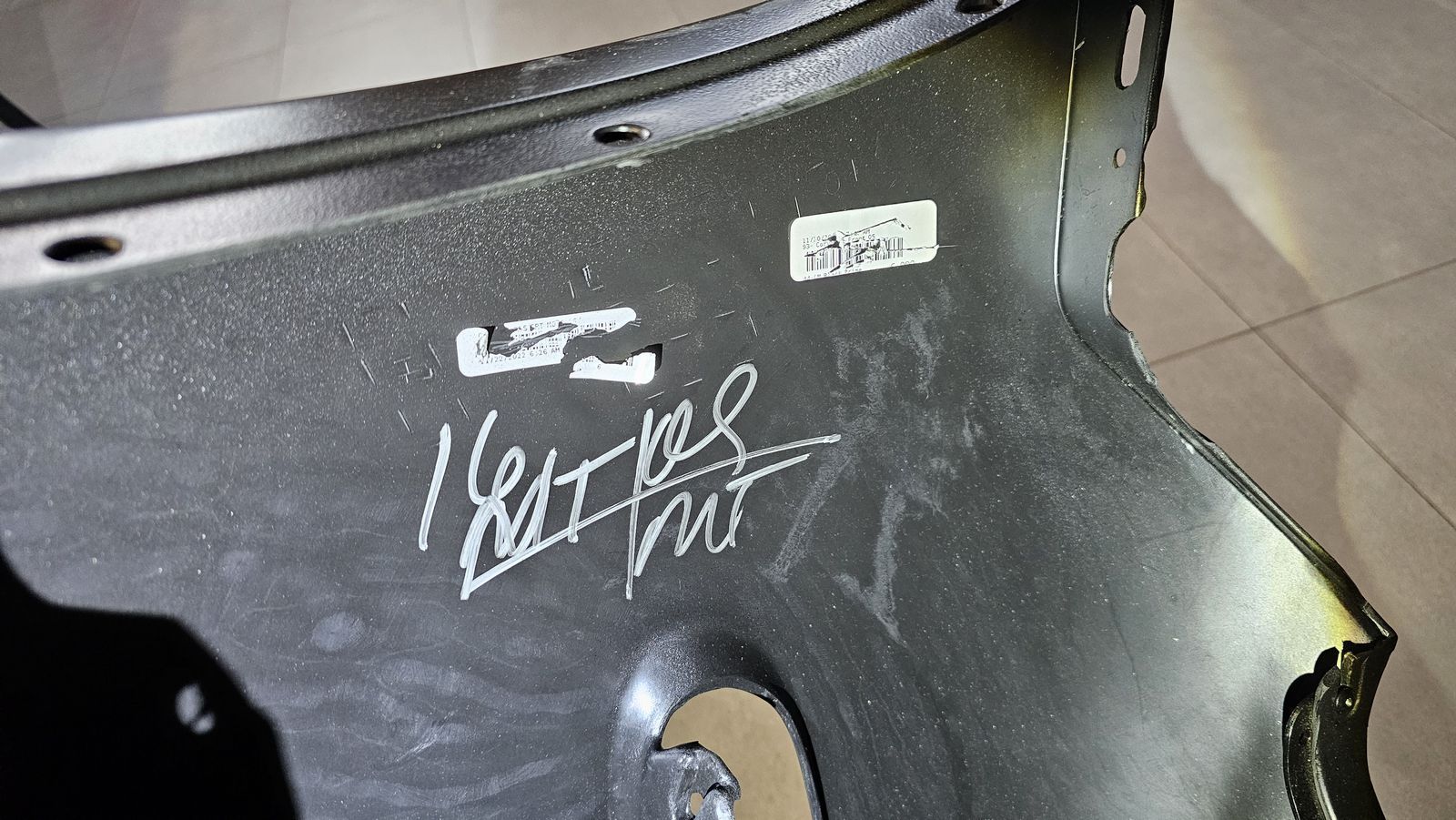

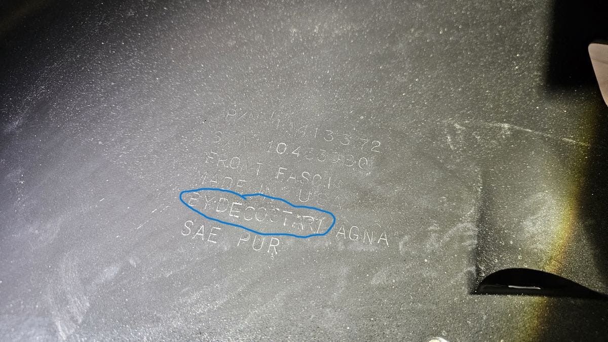

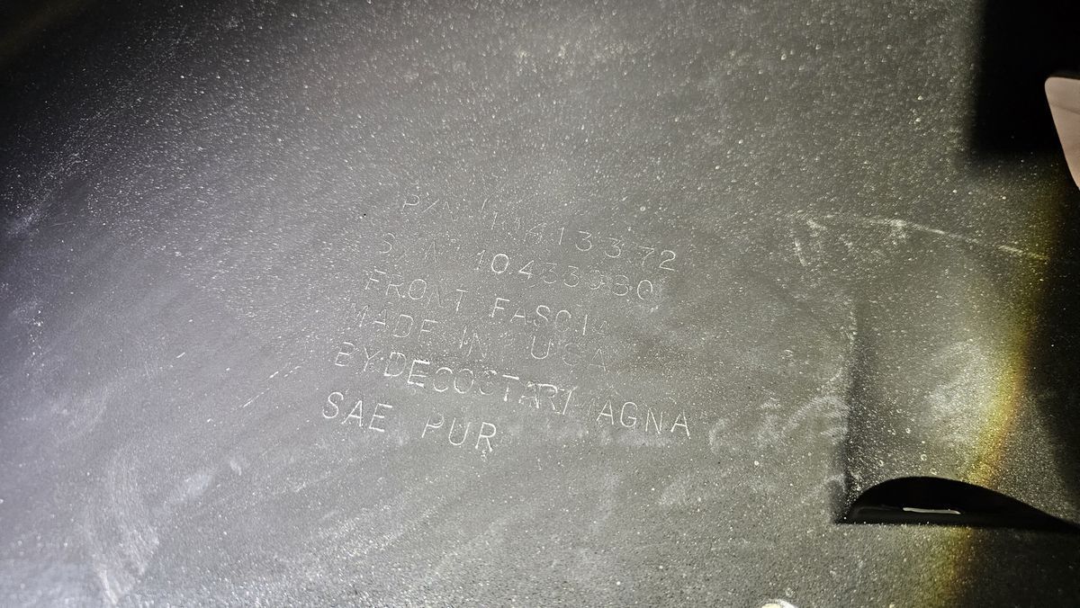

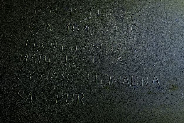

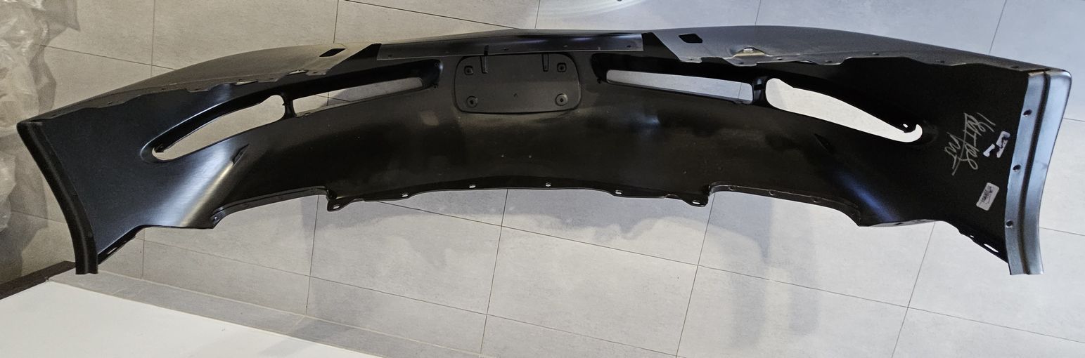

Today I was to see the bumper, I could not find the GM marking, but there is PN 14033080, I upload pictures with the markings, is it ok?

I am not an expert on body parts to know if it would have GM stamped on it. It does have the correct part number and says Made in the USA. Does the dealer have the box it came in? The box will have the GM part number and GM Logo.
Old Dec 13, 2023 | 04:48 PM
Trickskier's Avatar
Trickskier
Joined: Jul 2021
Posts: 2,354
Likes: 571
From: FLORIDA
Look closely - It's made by Decostar Industries in Carrollton, GA. Not sure if they are an authorized GM Parts Supplier. Probably not a genuine GM Part.

Searching the Internet (BYDECOSTARMAGNA - this is the inscription on the bumper)... Decostar is a brand owned by MAGNA , on the Magna website I found information that they are an OEM manufacturer for GM, I do not know how much truth in this, but trying to find an explanation.
https://www.magna.com/company/compan...tion/customers
Old Dec 14, 2023 | 01:15 PM
slavo_s2k's Avatar
slavo_s2k
Joined: Dec 2023
Posts: 48
From: Poland, Skoczow
I had an old damaged bumper from my C5 in the basement, and on it the markings look the same and there is no GM logo either. Perhaps this is the way it is supposed to be, and I am unnecessarily looking for a problem....
Old Dec 15, 2023 | 08:10 AM
grinder11's Avatar
grinder11
Posts: 12,859
Likes: 4,658
Perhaps there is no "GM" on it, but the part numbers I posted in post#5 are correct.....
