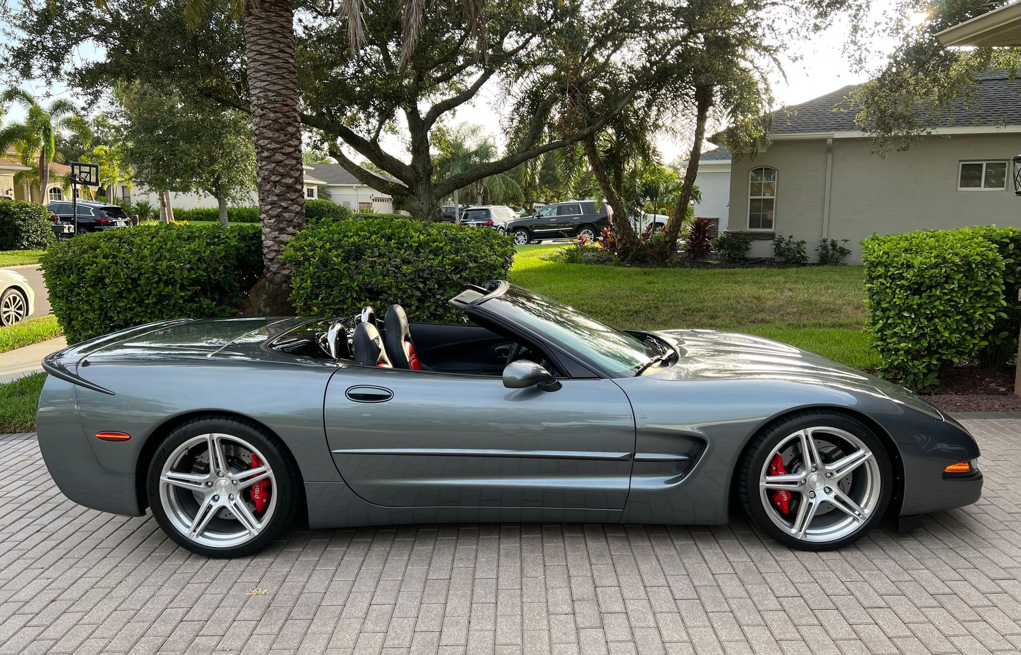

Many quality options available. I installed a set of LG GT2 coilovers earlier this year. The below thread provides more detail. In the end, I'm very happy with them and they have really helped improve the performance of the car. I can drive over the dips and uneven areas on the local area roads I navigate with confidence when before I would scrape or bottom out the wheel with the OEM leaf springs and my Koni shocks. Car feels a lot more tighter and firm now even after lowering it. Just be ready to fine tune and adjust them after installation. You will also probably need an alignment if you lower or adjust the height settings with the coilovers.
Current stance - lowered with the LG GT2s.
