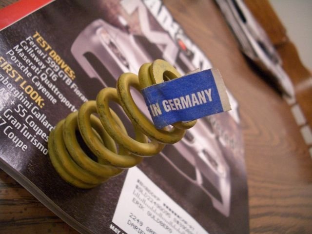

2002 C5 Z06: I replaced my original yellow springs in 2009 at 25,000 miles This was mid way thru my 5th season of doing autocross & high speed timed events. Springs were replaced because I was getting nervous about reported valve spring failures on 2002 & 2003 cars. I looked at aftermarket springs, but went with GM yellow springs. The yellow springs were made in Germany, have a variable rate (beehive) design using elliptical wire that has been shot peened. That's just what you can see visually so its a pretty sophisticated design.
I continued to run track time events until 2017 with the replacement yellow springs. They are still in the engine, but the car is now only a daily driver.
