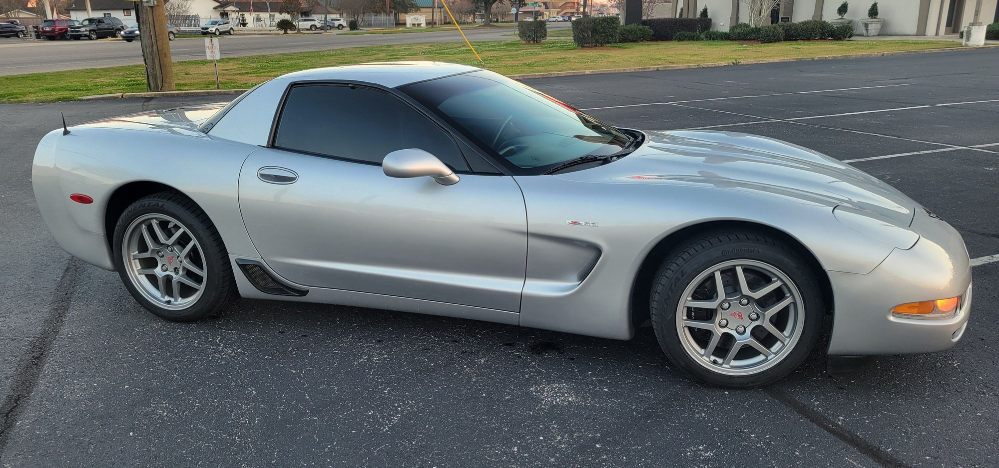

I have a 2003 Z06 and I recently ran into this same problem. I went with Continental's Extreme Contact Sport 02 tires: Front 275/40-17 and rear 295/35-18.
No regrets; they fit just fine.
Same as I did, no issues.

I just got Continental extreme contact DWS 06 plus installed all around.
255/40-17 up front and 295/35-18 on back. Loving them so far. Preferred the look of the 255 over the 275 up front.
255/40/17 = 25" tall
295/35/18 = 26.1" tall
Excellent combo
