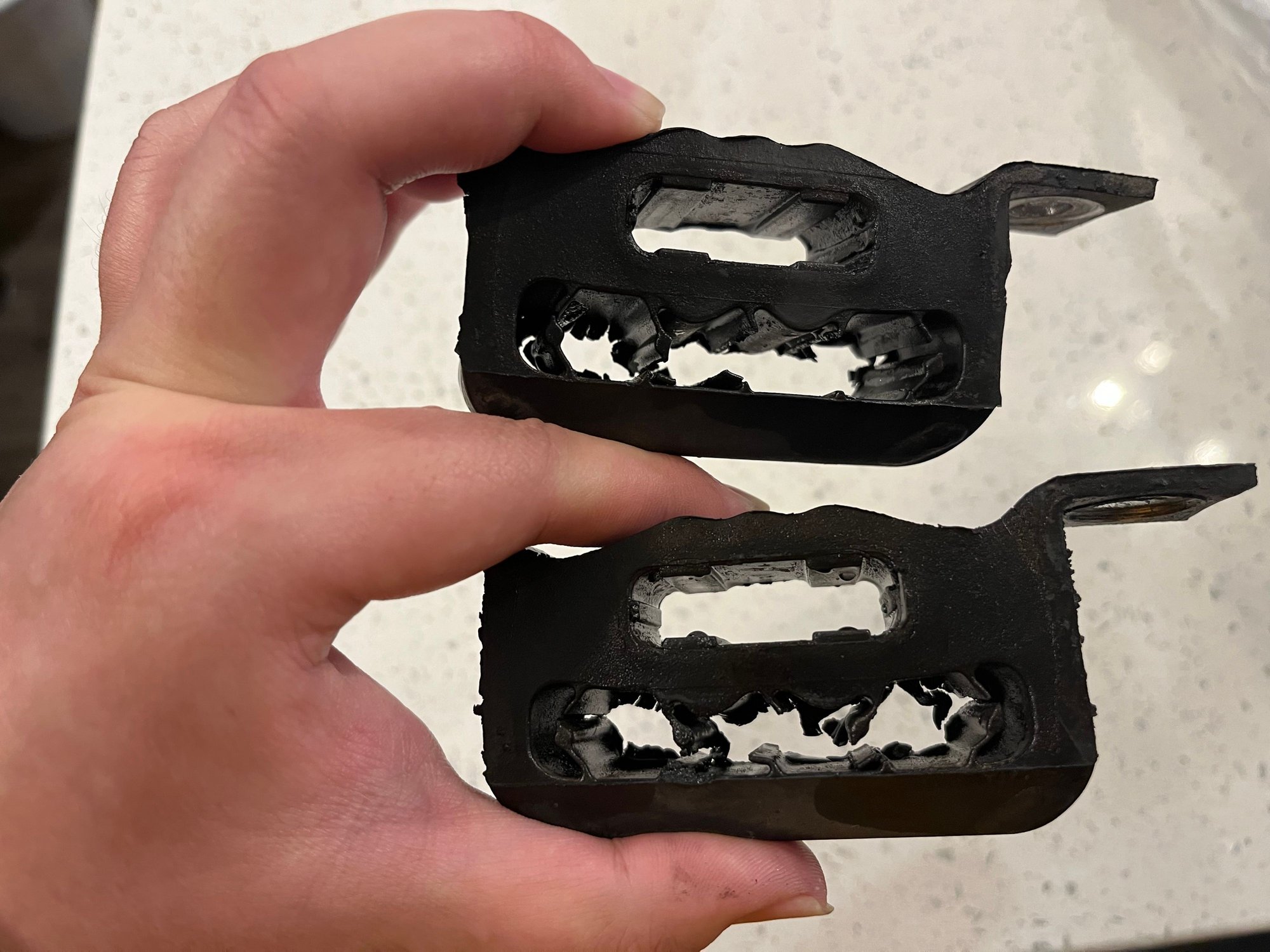

After replacing my cat back exhaust with a Z06 Ti version, I found that the tips are uneven. I tried the leveling with a floor jack trick. It did level it with the support but once you tightened it up and removed the support, the tip fell back down…I noticed it was due to the one hanger bushing being ‘softer’ than the other and unable to hold one tip higher than the other. I took them out and took a picture. Are they bad?
If so, does the Corvette clip hardened insert fix this problem?

You can try wedging a piece of flat stock under the muffler hanger in the rubber bushing to allow it to sit higher.
Or you could bend the hanger bracket a little to make them sit level.
They don't look worn to me.

They don't look too bad to me, either. I had one that was real bad, so I called Vettenuts and got a different set. Much better. One thing I did to help equalize the heights before I got the new set was I used a piece of 3/32" thick rubber I had laying around the garage to shim the low side higher. CAUTION!!! GM just inserted a short bolt into the support-before they assembled it-that holds the brackets up with a nut screwed to it. If you're not careful, you can push the bolts up inside the framework, because they weren't welded in place and theres no retaining clips, either. Proceed with caution!!!
Where are you referring to?
Like the upper smaller hole in the rubberized part?

Muffler hanger goes in the small hole. Put some metal or rubber between the rubber isolator and muffler hanger. Or again, bend the muffler hanger down to raise the muffler.
