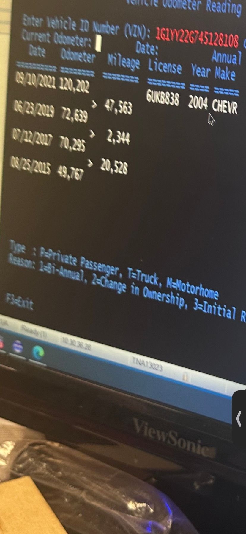

Hi, a bit of a last-ditch attempt, I bought a 2004 Vette in 2021 with 74,000 miles. When I smogged it this year I found out the odometer had been rolled back at least 30,0000 miles. I'm trying to find the previous owner of the car to confirm the dealership did the rollback. Any help as far as how to find him would be appreciated. Or if the previous owner is on here by chance? The vin is 1G1YY22G745128108 for a 2004 Lemans Blue coupe

It looks like the idiot tech had the odometer in kilometers. 120202 km = 74690 miles. So you can sleep easy.

Tech showed me a log, here's a picture I took, I bought the car in October/November 2021. It was advertised as 74,000 miles

Not so fast.... I would want to know who did that smog test and have them prove the mileage. Carfax does show an inspection happened on 9/10/2021, but it also shows it was sold on 8/26/21 by Maita Chevrolet with 74,652 miles and then offered for sale by the guys you got it from (presumably), Hawthorne Motors Express, at 74,653 miles.

I'm with a few others, I wouldn't immediately think rollback when seeing that. I immediately think user input error.

Agree with last 2 posts. Either someone who shouldnt be working for the DMV, or its shown in km. Either way, sounds like the DMV "tech" screwed up big time. Big question is how to rectify? Hard to talk sense to state or feds......

in NY and CT the inspector enters the milage. could easily have been a screw up.
Happened to me on my '67 vette, and it was a royal pain in the *** every year to explain to the tech that the milage was incorrectly entered at one point.
It is not trivial to roll back the odo on a c5. FAR more likely that this was a mistake.

Scan tool should be able to read the mileage from the BCM. Hook up the tool, read it. Then change to km, read again.

Easy to figure out, as one member posted. 1km=.621 miles, IIRC. So, .621 × the 120,202=74,645......
