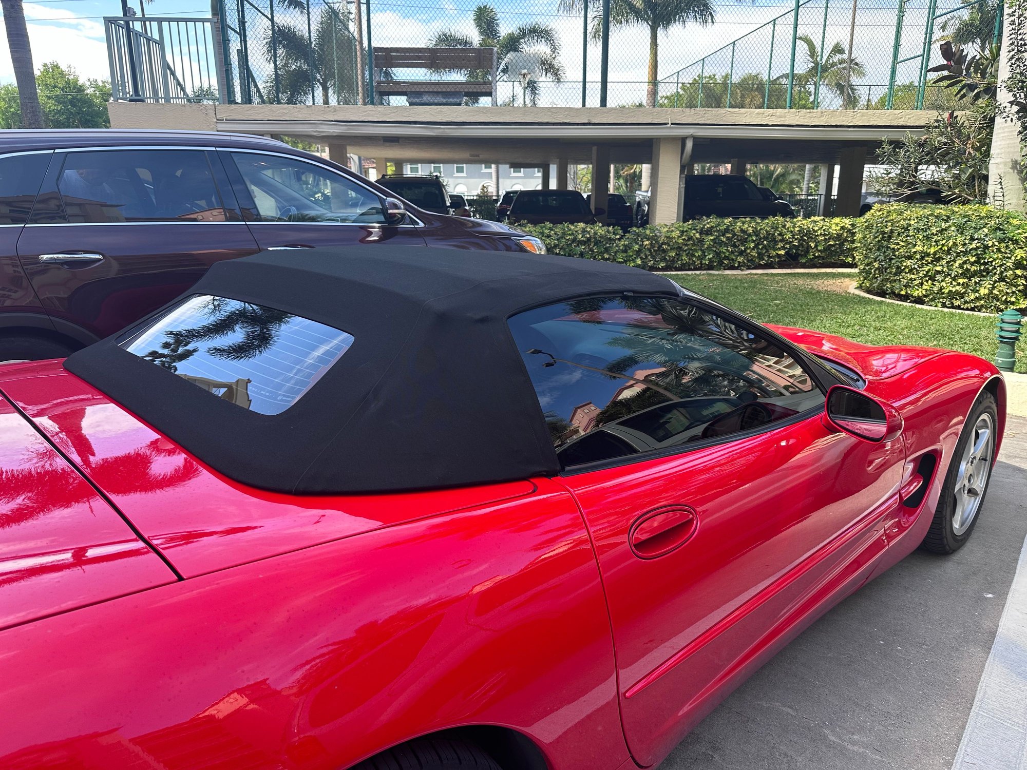

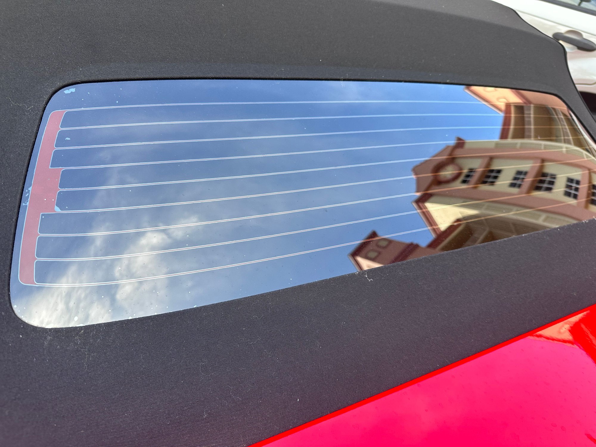

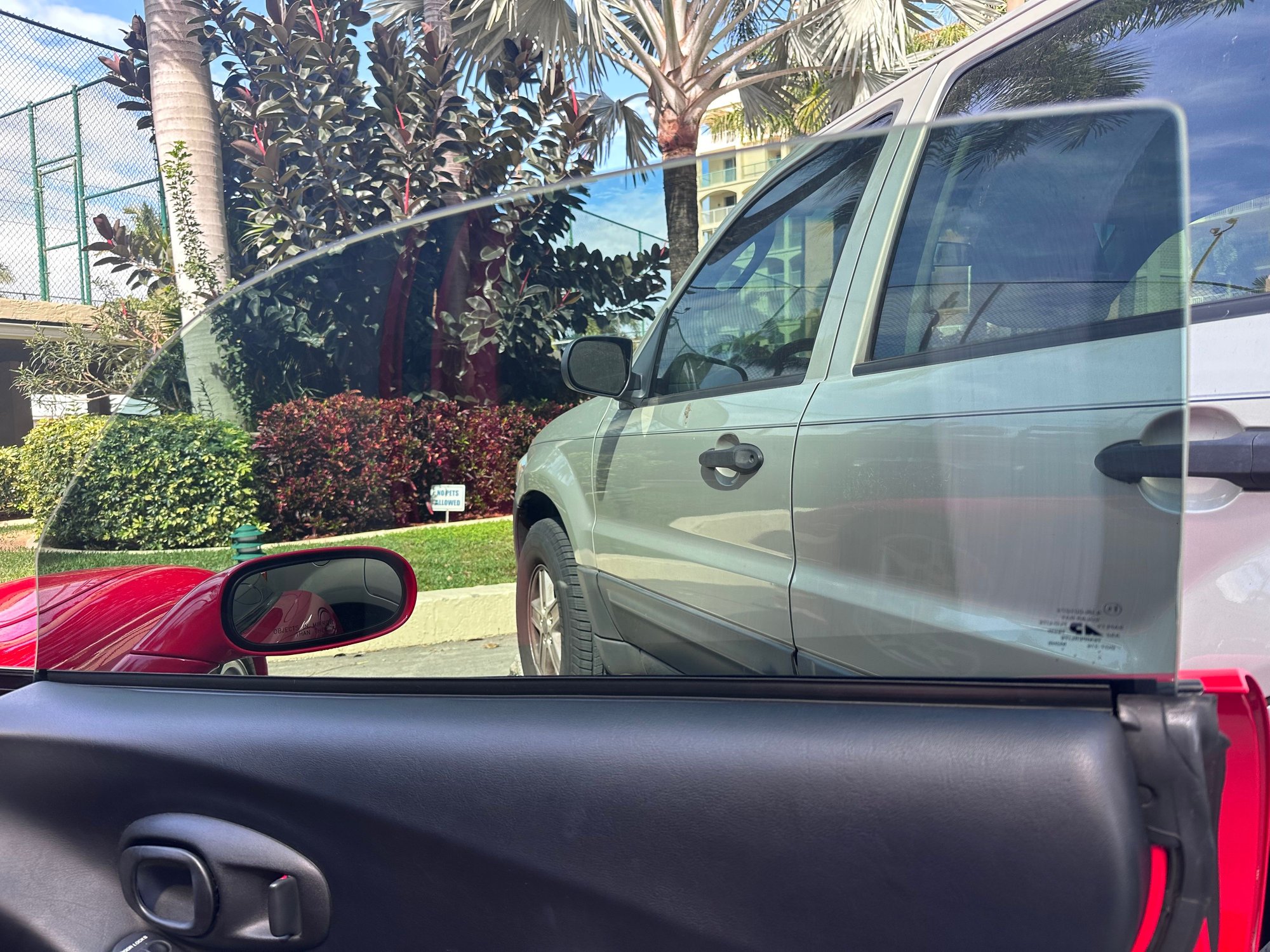

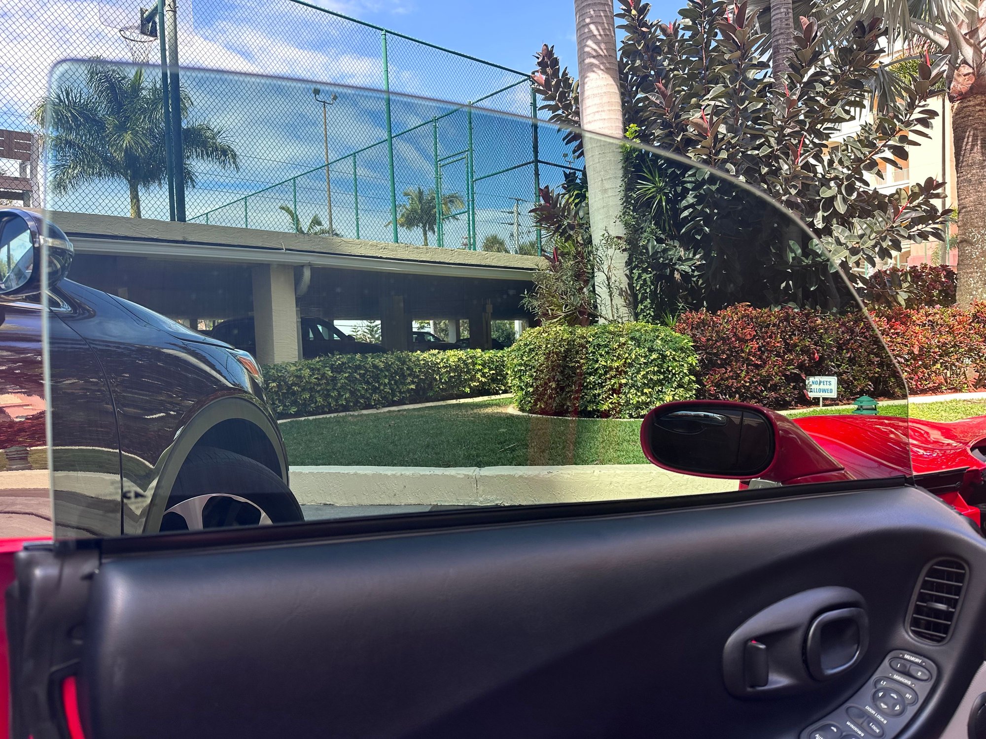

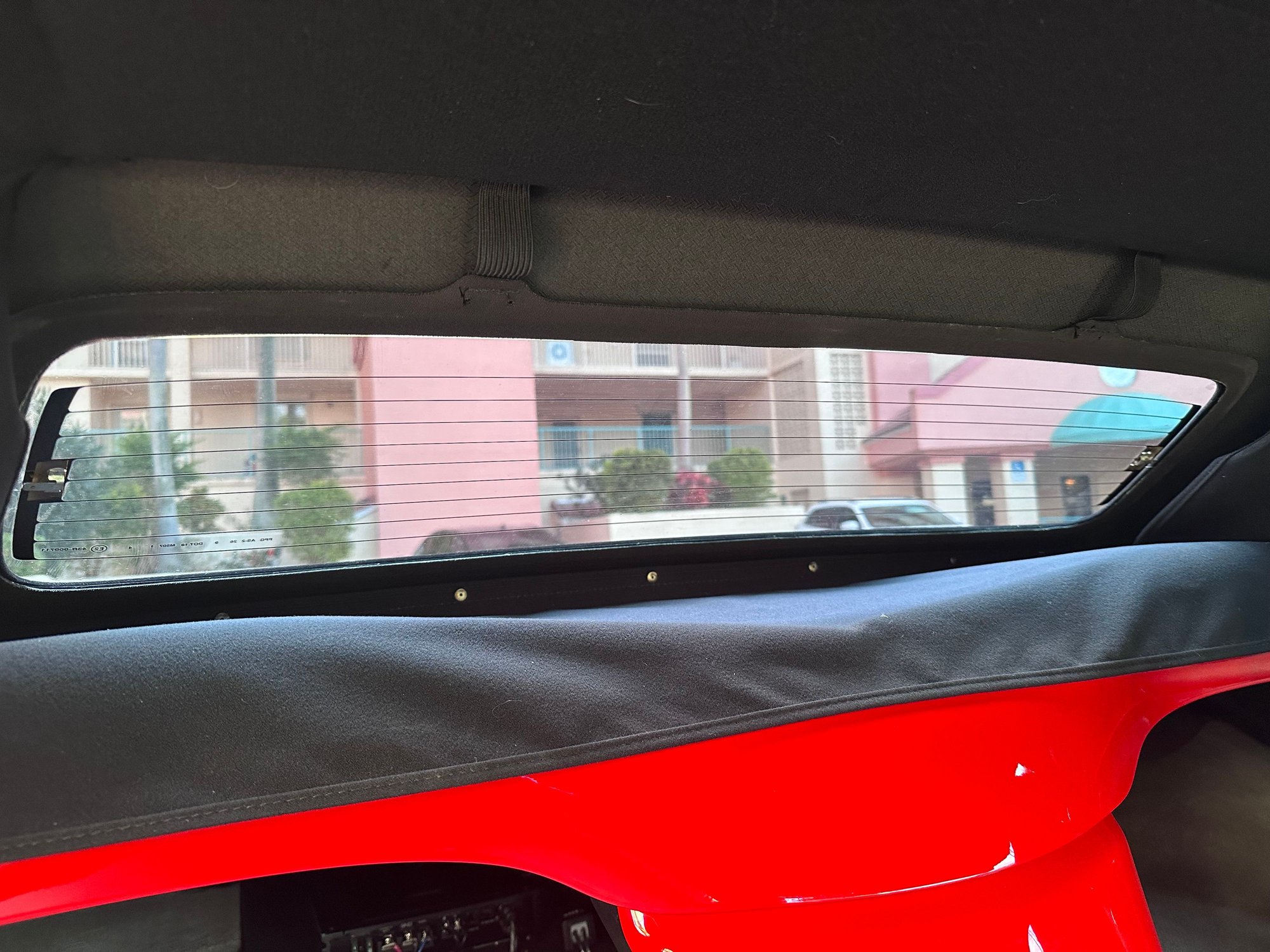

I have a 2000 vert. Bought a set of precut films off eBay a few years ago for like $30.
After a series of mis-shipments (seller sent me coupe tints instead of vert tints) I ended up with 4 films for the doors and 2 for the back glass. That meant I had several attempts to get it right.
I tried the driver door first. Watched a few you-tube videos, got a heat gun and a cheap tint installation kit from Amazon. Used baby shampoo and water for lube. It went… ok. I had a wrinkle near the side mirror, because I was dumb and tried to tint with the door panel on. Drove around with one window tinted for a while, due to life getting in the way.
Fast forward a few years… yes years, lol!
Now retired. Decided it was time to finish this project or admit defeat and take it to a pro. Decided to completely gut the Bose system as well, so the door panels were coming off anyway.
On my second attempt at the door glass, I learned that tint can only be shrunk in one direction, horizontally. So for a compound curve, you have to set a horizontal anchor line in the middle of the glass, then shrink the top and bottom to mold to the glass. This is done on the outside of the glass with the protective liner still attached to the film. I burned/warped the second film trying too hard to shrink certain spots. Then I realized, the top and bottom need to be shrunk evenly across the width, not just where the “fingers” pop up. You can get much more contour that way.
The third attempt on the driver door went great. No bubbles, no wrinkles.
The passenger side took two attempts.
i was feeling great since I got both side windows done with a couple of extra tints still in the roll. On to the back glass, but with only 2 films available. I needed to get this right.
Although the vert back glass is small, it does have a compound curve, so shrinking is required. I was a bit nervous about burning the top around the edge of the glass, but got it molded correctly. The install was tricky because I did it with the top mid fold from the back (upside down). The only snag was the cutouts for the defroster weren’t exact, so I had to cut a slit at each end. Once it got squeegeed out, it looks pretty good.
The precut film fit perfectly except for the defrost connectors.
i think it looks very good, and it cost me less than $40 all in. Plus I learned a new skill. And learned a ton of respect for the guys that do tint.
I also learned there is no way, NO WAY, I would try a coupe rear glass. That is sorcery!
Not sure I’d pay $500+ for tint though.

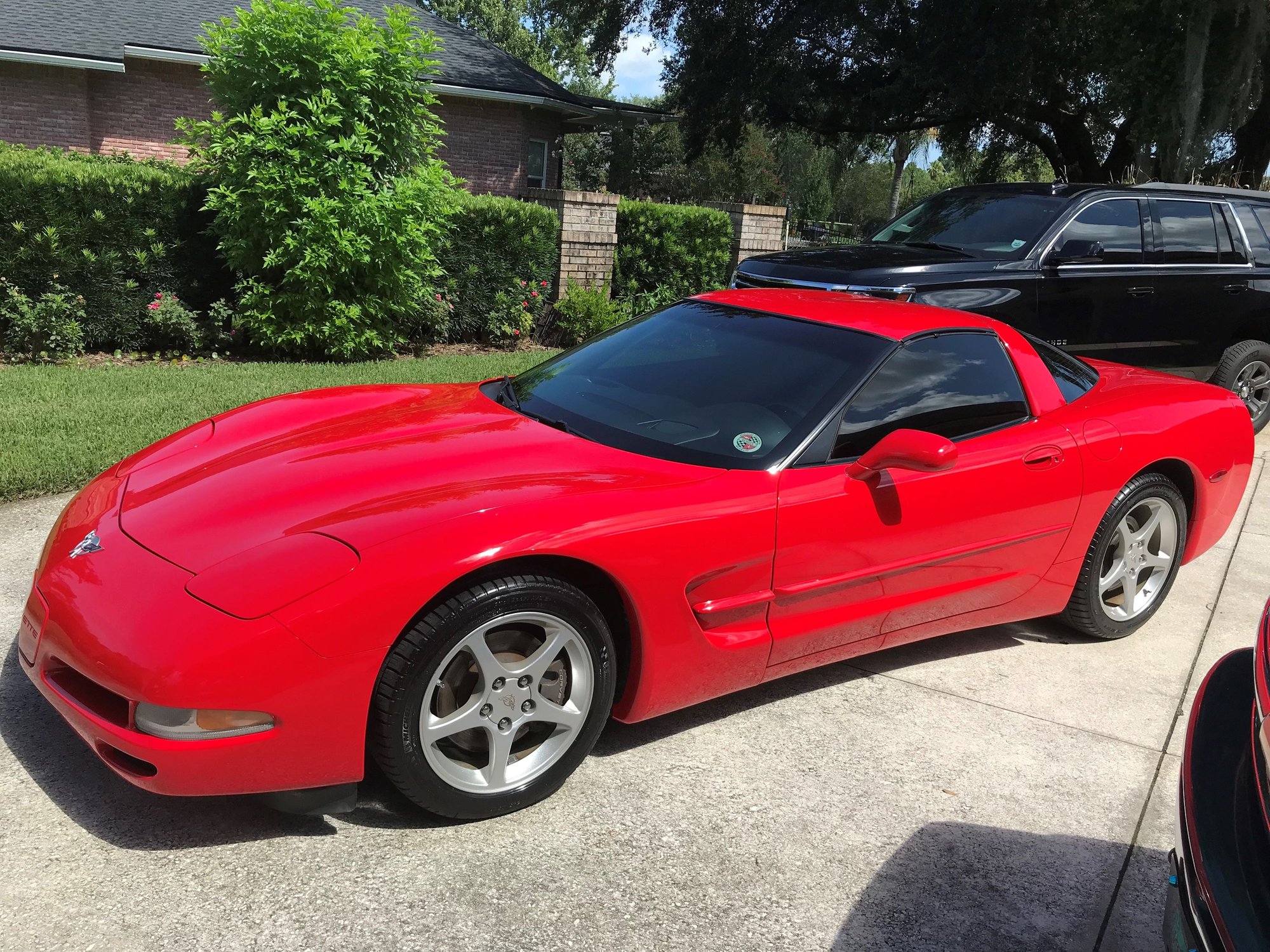

Old Mar 3, 2024 | 11:00 AM
Cherry3m's Avatar
Cherry3m
Joined: Oct 2014
Posts: 110
Likes: 30
Above post needs PICS!!!!
Here you go.
Sorry, no pics of the install.
I paid $26.xx for the films. The guy still sells them on eBay, but they are $32.xx now.
With no experience, it would be a miracle to do it good with one attempt.
