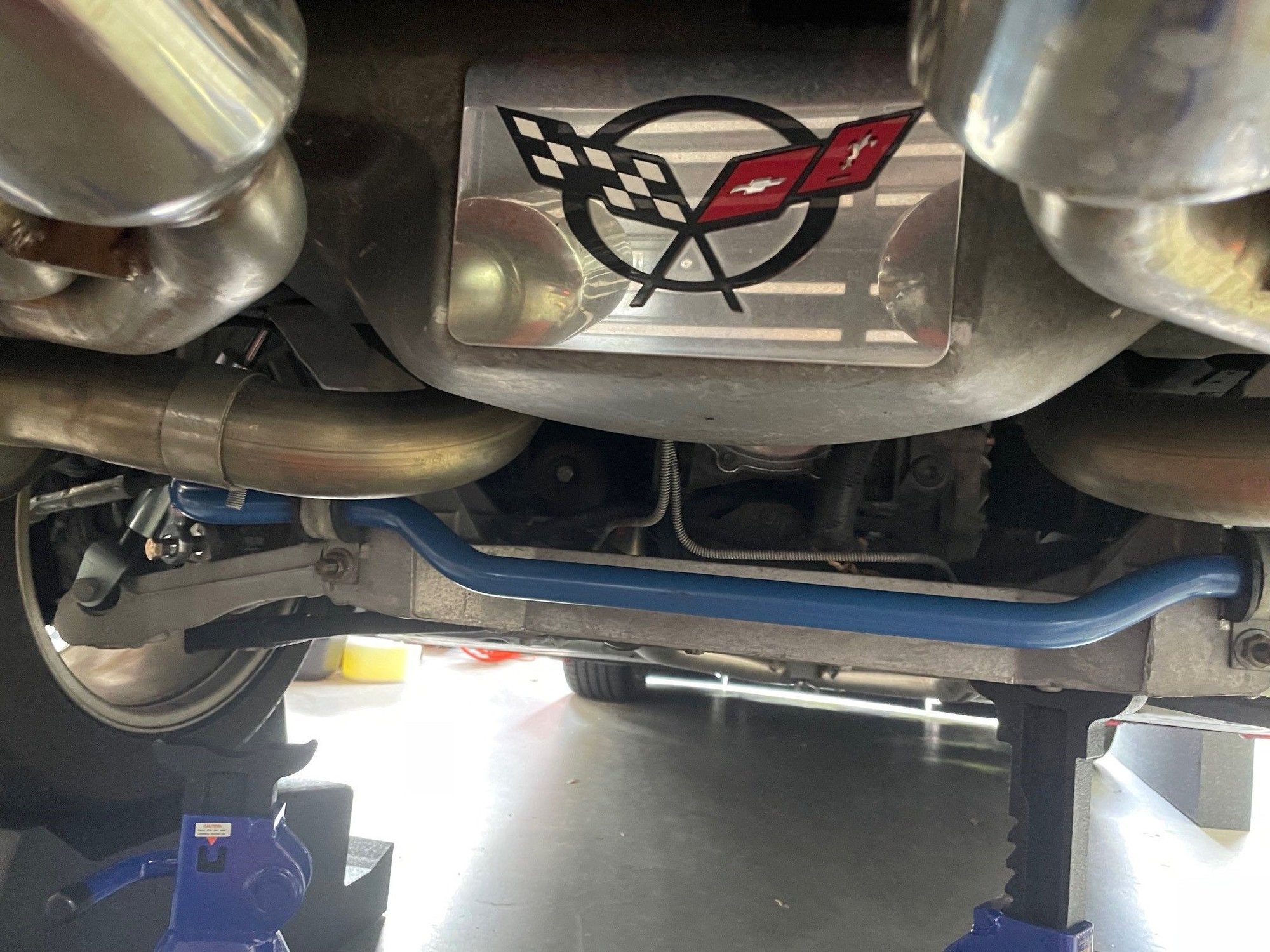

I did the steinjager bars last year. They are cost effective and the fit and finish is fine. They are C6 Z51 equivalent. Cost me about 430 for front bar, rear bar, new bushings, new adjustable metal end links. And I did bilstein B6 shocks, which were 100 a piece. Very cost effective. I can drive the car daily if I want to, I also drag at Byron dragway, IL or union grove, WI. I’ve done HPDE as well. Great upgrade for a daily driver or just wanting a little more at a track event. The polyurethane bushings don’t make any noise, use all the grease supplied, and the end links don’t make noise either, make them really tight.
I also did the install myself on a set of quick jacks last year, upgraded my brake pads too to Hawk HP plus, fronts squeal like a mother, but it stops faster then any car I’ve ever driven. Upgraded brake lines and brake fluid too.
Good luck on your sway bar search. If you want the thickest bar out there, I think check out LG or Johnny O’Connell.
