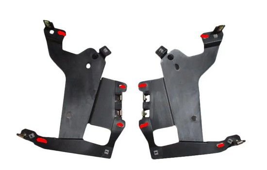

The adjustments you can make to the headlight covers position is endless, tedious but endless. The cover attaches to these brackets which can be loosened at the red points to adjust the gaps. The tedious part is having to remove and check your work. Get a chair.......
