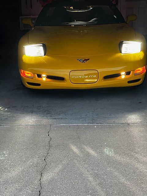

I recently installed these:
https://sharplightinnovations.com/sh...aca-headlights
Pricy, and the instructions could use some adjustments, but no regrets, would do it again.
The low beams alone are significantly brighter than stock setup, and have a defined cutoff so it illumintes the road ahead, but you don't blind oncoming traffic. Then when you go high beam it's night and day different, pun.
