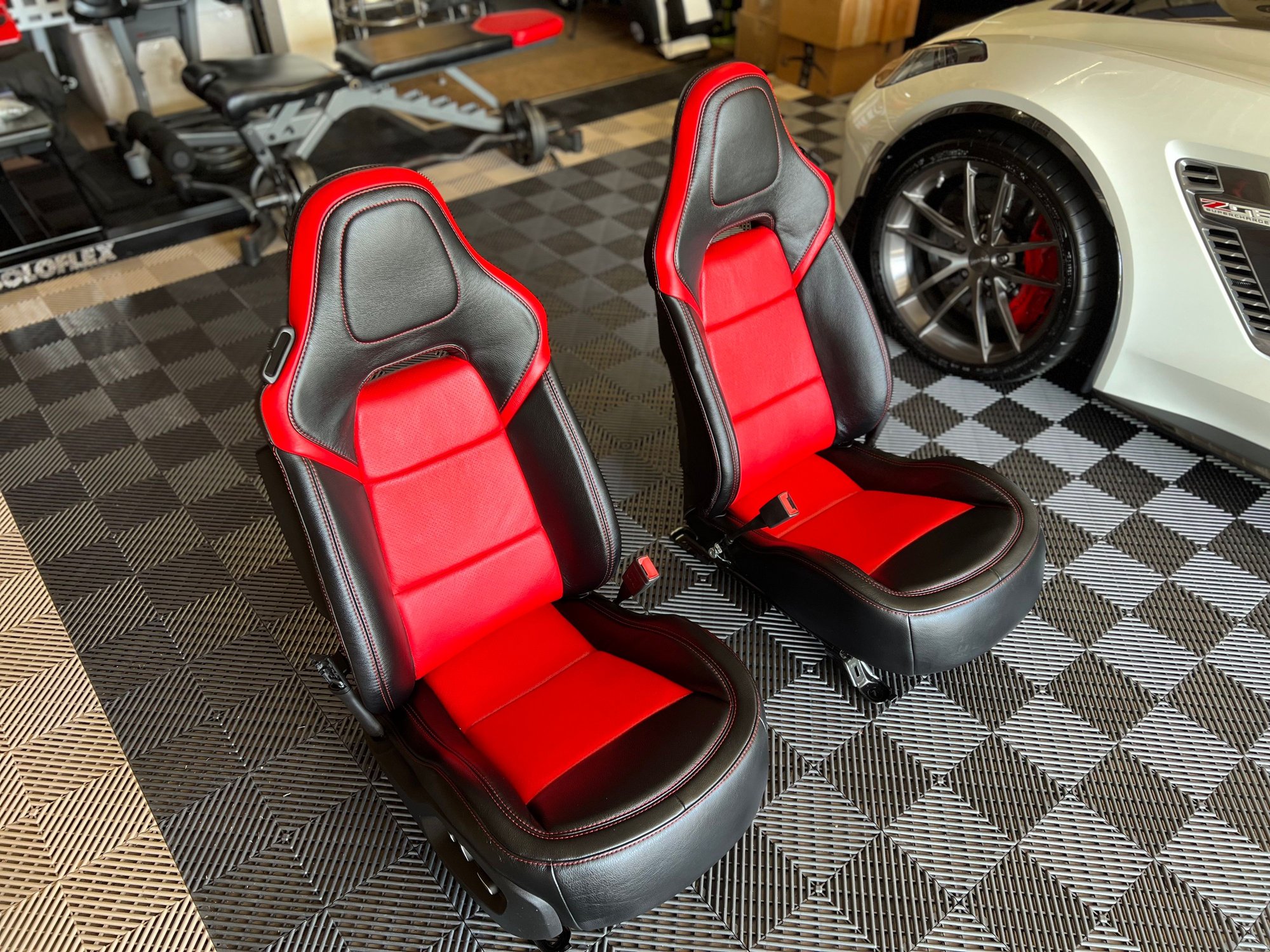

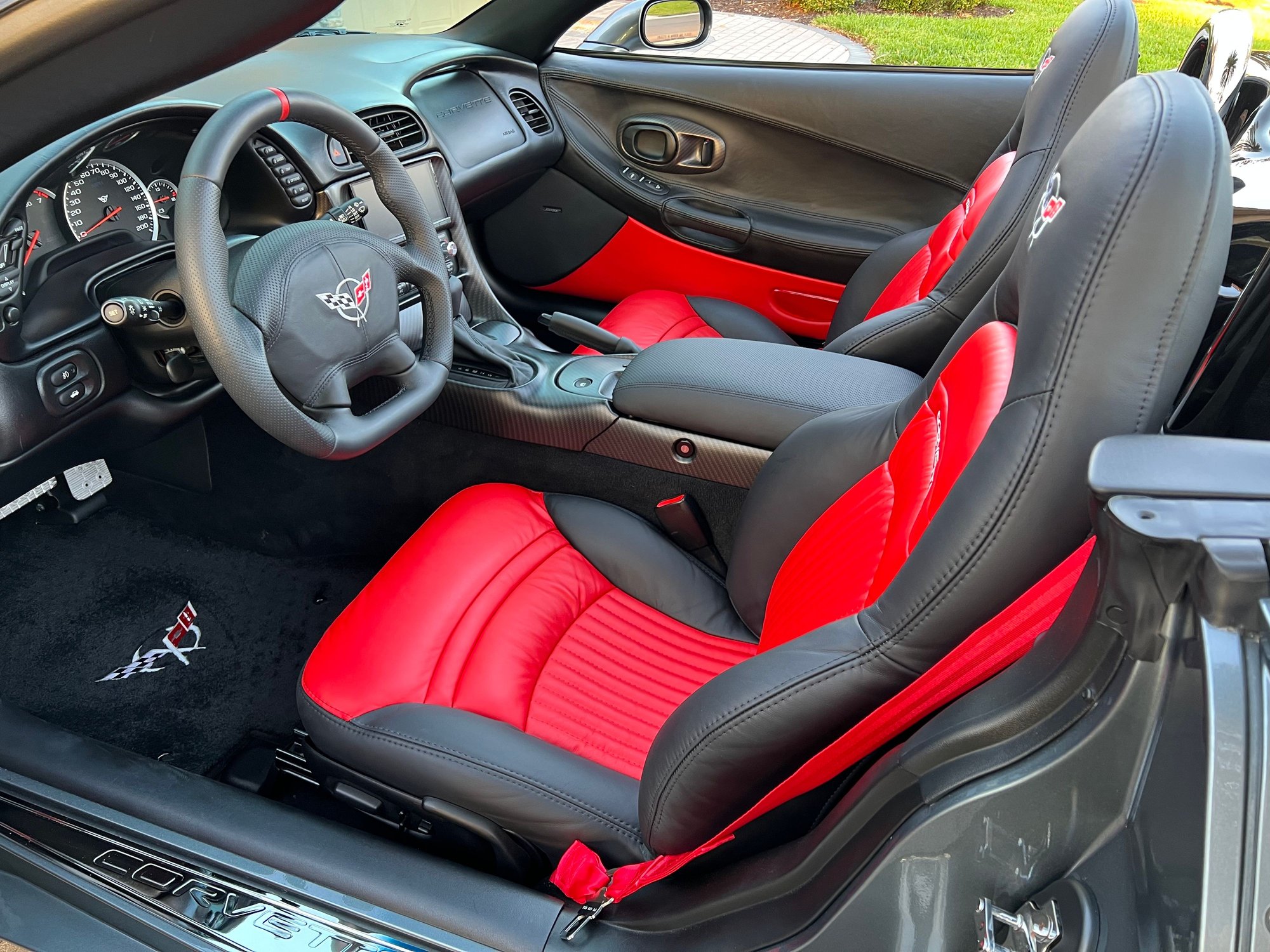

This should hopefully be a one-time fix so do it right and bring it to an auto upholster. I try to do most of my own maintenance and mod work on my Corvettes but over the years I've learned that having proper tools is the key to how easy or how difficult the job is.
Back in 2012, I installed a new set of seat foam and new Vette Essentials leather skins. Although I got the job done, I was not happy with the finished job so I brought them into a local auto upholsterer who removed them and reinstalled them. I was really curious as to how they upholstered the seats and he let me watch them work. After removing the new skins and seat foam, they installed automotive rubber burlap material over all the exposed seat wires and sharp edges to prevent the springs and edges from cutting into the new foam. After installing the foam, they then placed the seat frame onto a table and used cables to stretch the leather over the new reinforced seat and seat foam. The machine they used looked like a medieval torture device as it had hooks that pulled the leather tight. While stretching the leather and securing it to the seat frame, they also used a steamer to smooth out other smaller wrinkles.
I've now used this particular local shop for two sets of C5 seats and one set of custom C7 seats which BTW are available in the C5 FS section.
