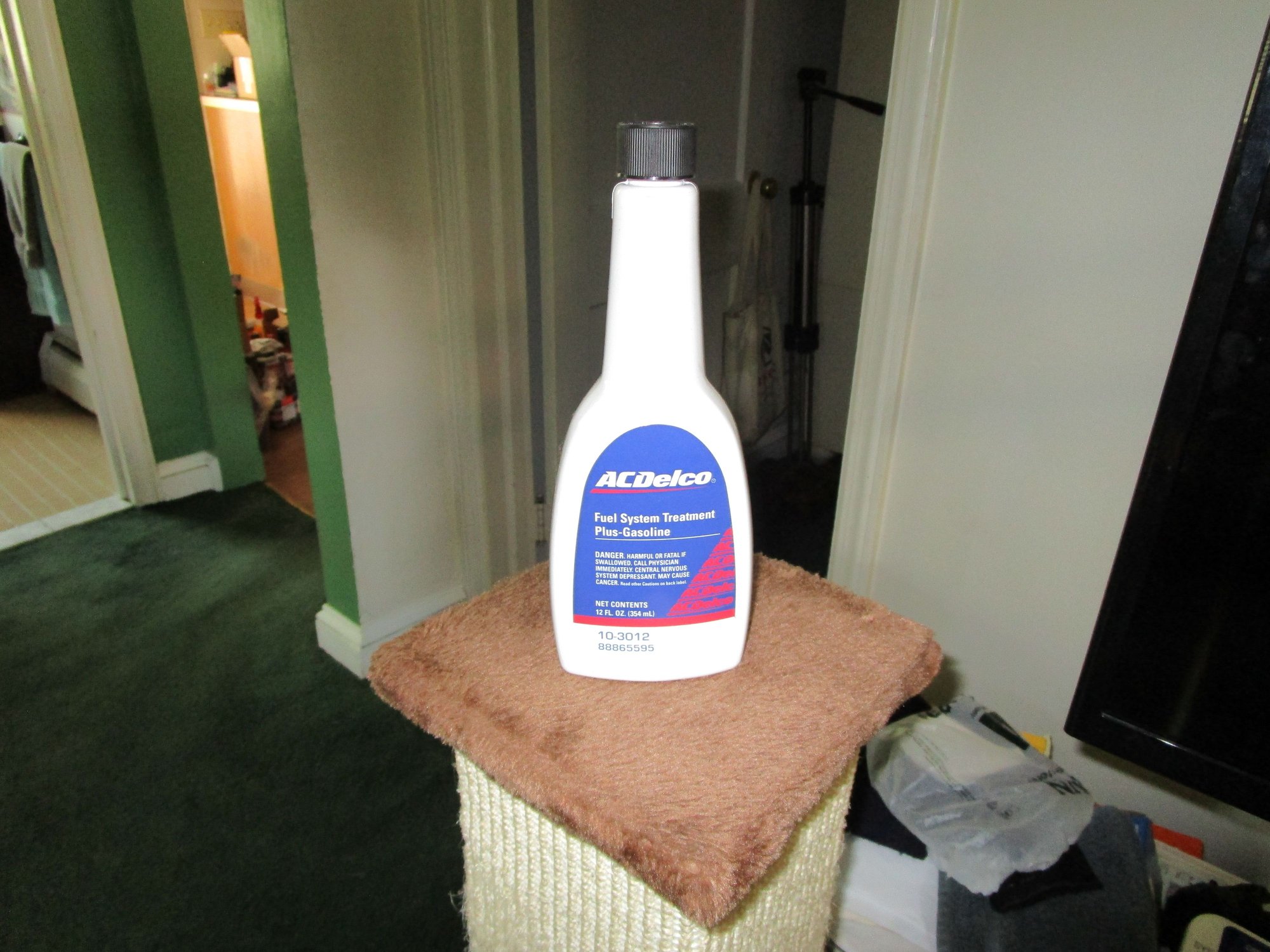

I too, often wonder if the Techron efectiveness, so I have tried this GM Product with a fairly good responce
