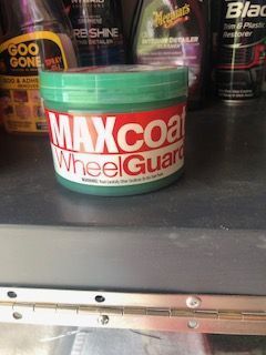

Whatever path you choose, use this stuff to protect the wheels....................
Does this product repel brake dust?
Does it ever. Better than any other wheel product I have tried. It's a bit messy to apply, (has consistency of jelly) but oh so worth it. I apply it every six months or so.
This stuff lasts. You put it on and nothing repels everything but it is easy to clean and protects. Dust is just a by product of pads and the only way to control it it to make it a lighter color vs dark black.
The polish only has one down side. You may want to use gloves or you will have Hulk Fingers. Yes it will stain your fingers green. Other than that I have found nothing that comes close to protection.
Be sure if you have clear coated wheels to use polish just as you would use on a painted car. This brings the shine. The green will seal and protect it. I use it inside and out on the wheels.

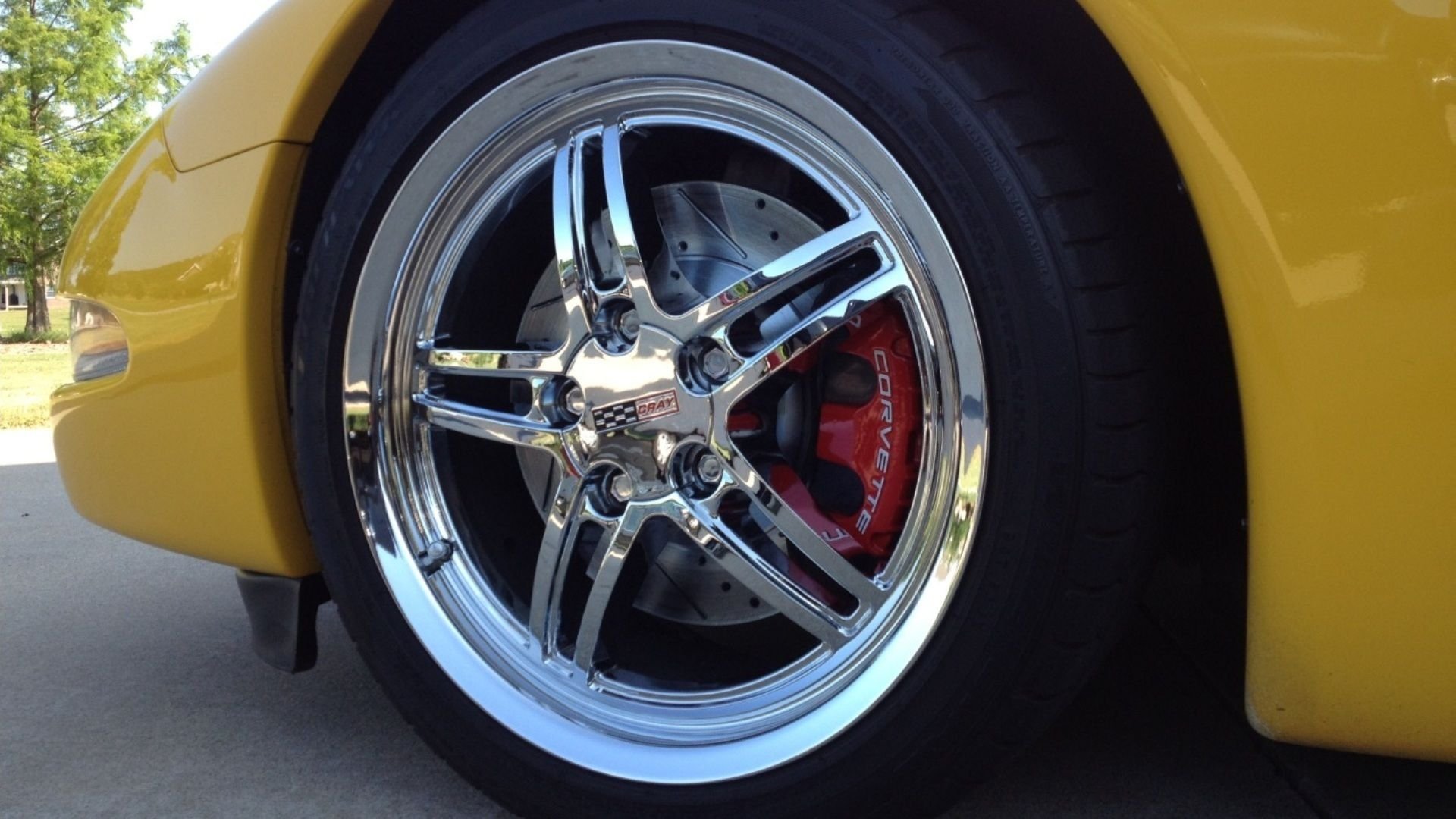

For 21 years Only Mothers Chrome polish have touched these wheels... the C5 chromed, alloy wheels... They're perfect, they're balanced, and don't crack, don't peel, don't leak...... Today's GM and new fangled big *** wheels they use could do with a little ( purhaps a lot) 🙄 materials help from them ol C5 days....you know, the strong *** wheels that continue rolling on down the road... with air in em... Seems as the latest GM designers "can't do wheels "... it seems. 😂🤣 Now that there is funny! 😁

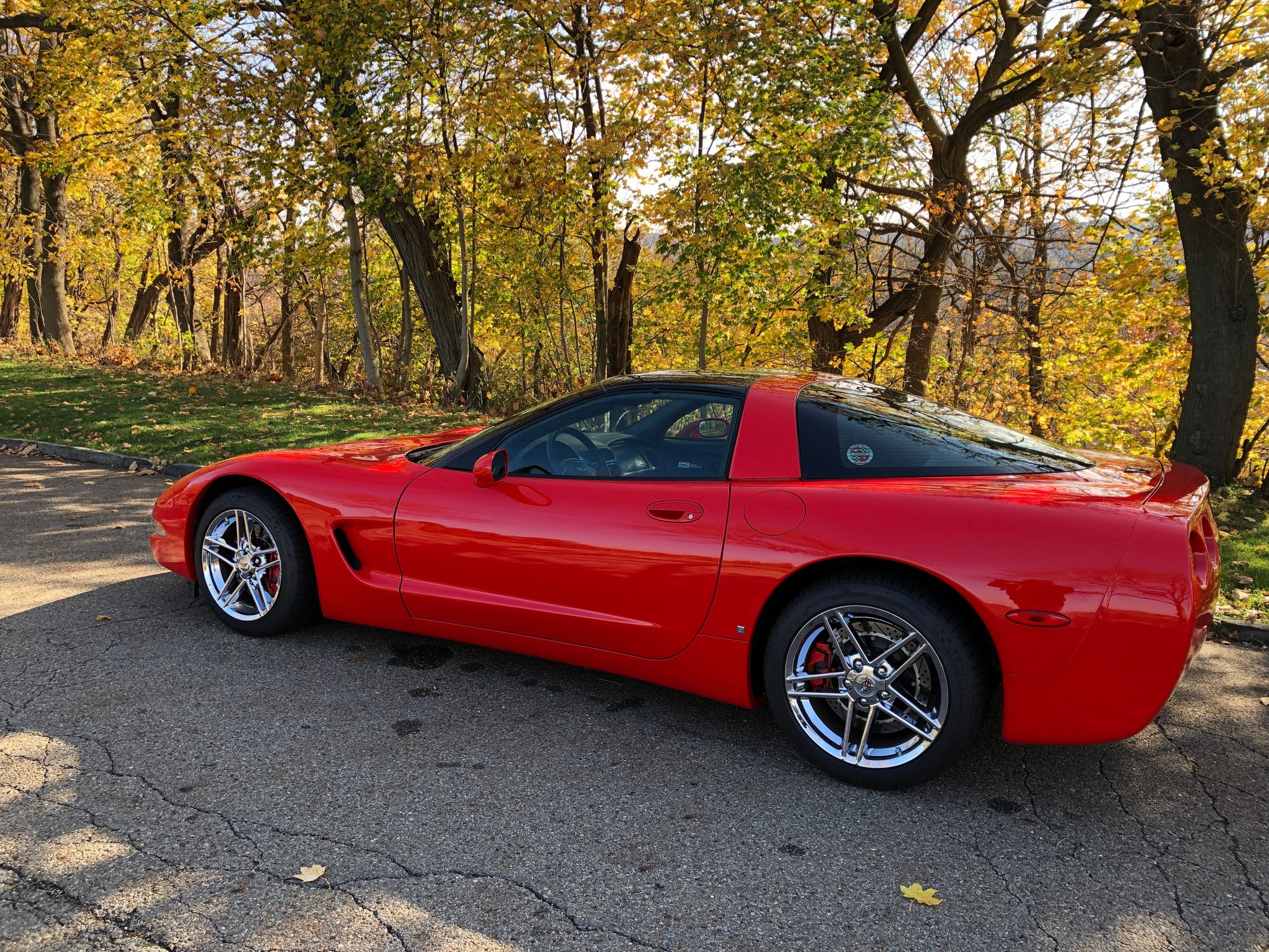

Chrome or clear coat. I always use what I use on the body of the car. The same polish. If you wouldn't use it on the body don't use on the wheels. These are after market chrome wheels that have been on this car for over 15 years. Nothing but Zanio polish
