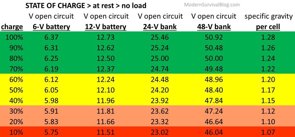

I haven't been a c5 owner long enough to know if I have a parasitic draw or not. Before getting too deep in to it I've been measuring my daily voltage drop on my battery. I loose about .05 volts per day when the car is not in use. According to charts, with a 100% charged battery 12.65v I'm at about 60% 12.37v battery after a week. Is this normal or should start looking for a problem?

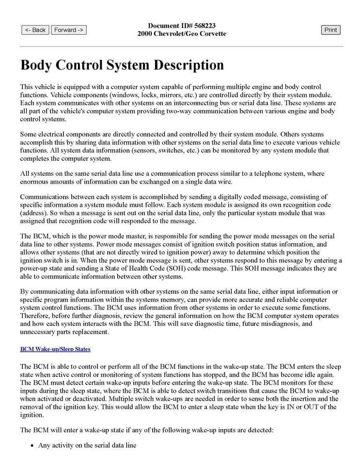

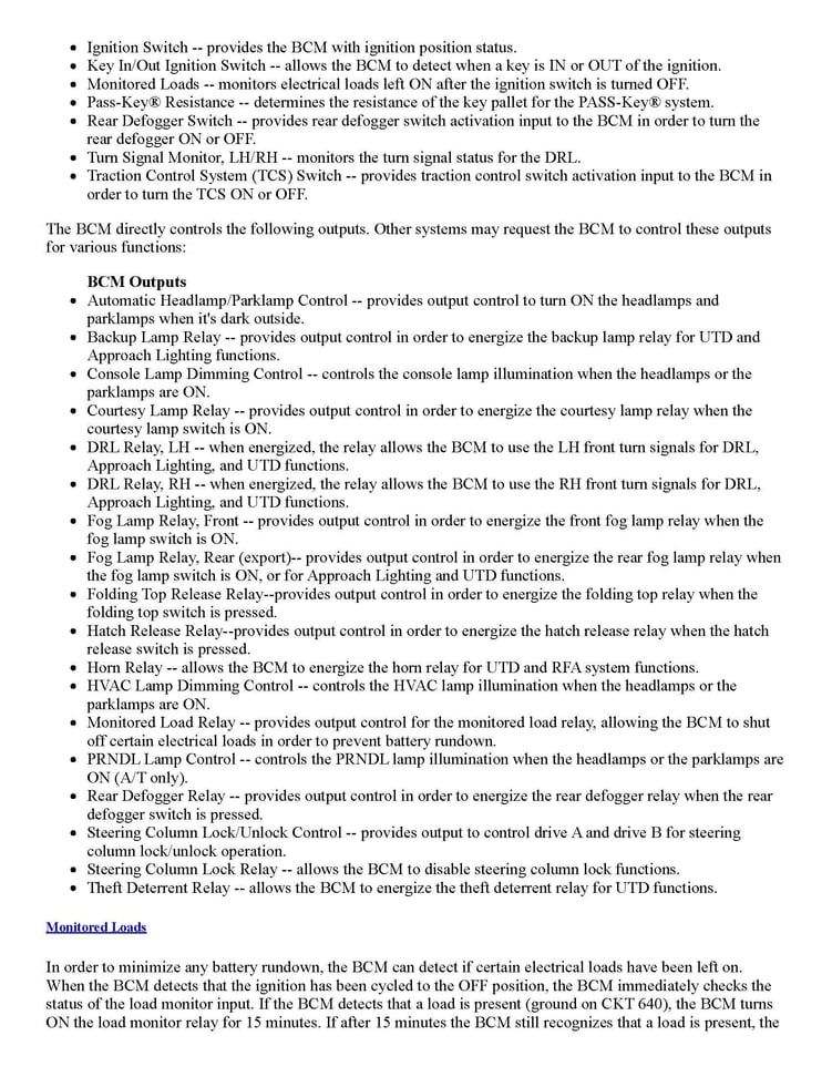

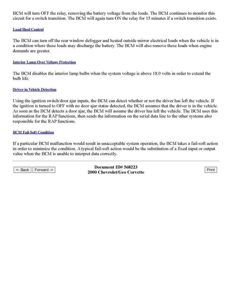

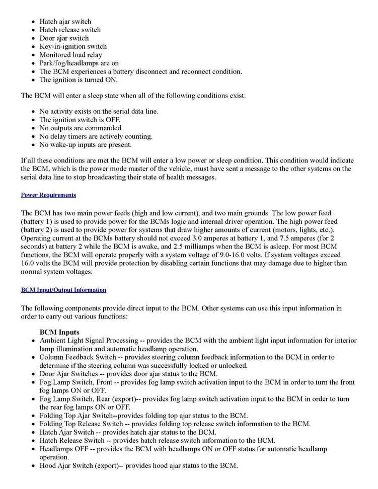

lucky131969 posted these in another thread and they explain alot of the security drains the BCM controls-
