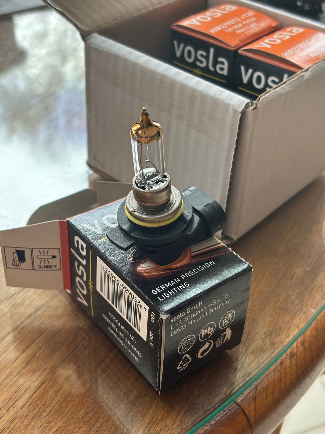

I'd be embarrassed to admit the amount of time I've researched replacement headlights for my 2002 C5. While there are some excellent alternatives available, I just could not justify the cost for the 2 - 3 times a year that I drive after sunset. Replacement LED bulbs were not an option for me due to issues for oncoming traffic etc. I contacted Daniel Stern after reading some of the posts here about his bulbs, and could not be happier. I now have a whiter, brighter light and a price that I thought was very reasonable. While I realize some of the other options are much brighter than these, that just wasn't a path that I wanted to go down at this time. These bulbs are direct replacements (see tab modification below) that draw the same amount of current yet provide slightly less than twice the number of lumens. No additional wiring or relays are needed. Cost is just under $30 each.
In the photos below, the Daniel Stern bulb is on the left and my old bulb on the right. Note that the center tab (key) must be trimmed. Daniel provides a pattern for trimming if you want to do it yourself. He also will do it for you for a nominal fee. I found the information that Daniel provided to be very helpful, and he was a pleasure to deal with.

Were all 4 of those Vosla bulbs in the picture 9012 bulbs or did he send you the 9011 high beam bulbs as well. I saw he had 9011 bulbs by Toshiba listed on his website.

I did not order any of the Toshiba 9011 high beam bulbs. My order was for 3 low beam 9012 bulbs. The little bit of nighttime driving that I do is all in town so I left the stock high beams as they were.

3? as in, 2 to use and 1 spare?

Exactly. Since there was some trimming involved and the fact that these bulbs are not available locally, I figured I'd just save another shipping fee and get a spare up front. Kinda one of those Murphy Law things. If I wouldn't have had a spare .....
