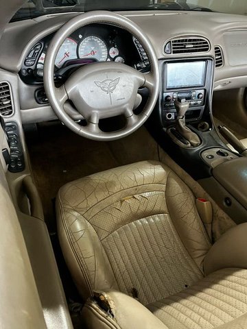

Driver's seat looks like a rabid dingo ate it

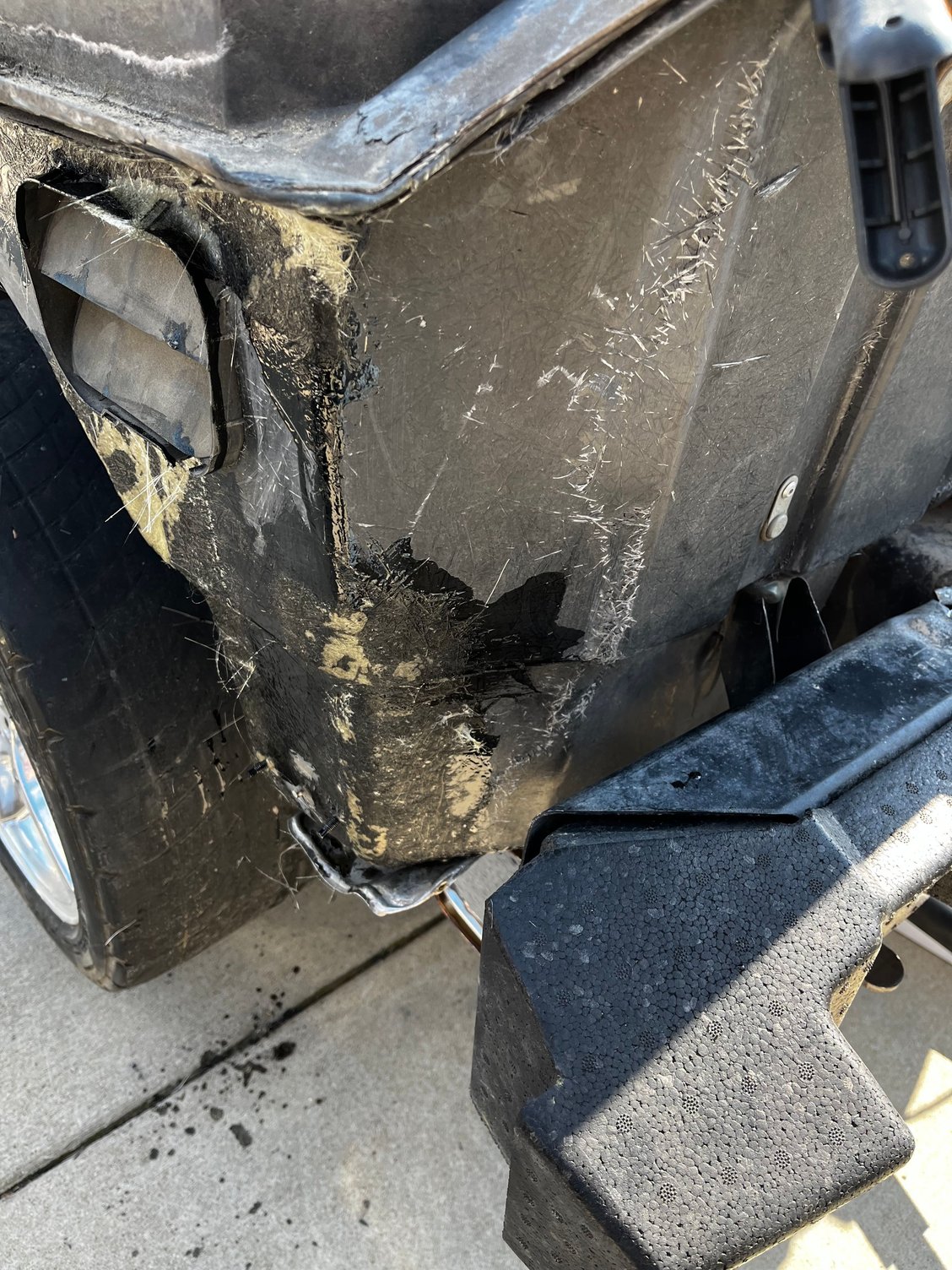

The left 'ear' of the rear bumper crash bar is bent in and has crunched the tub in that corner
The quarter panel mounting tabs on the rocker were broken off in the impact.

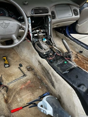

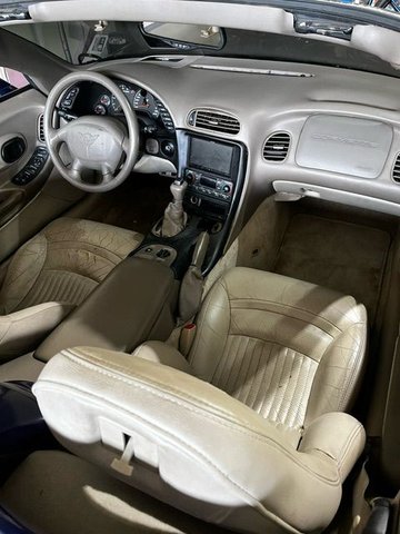

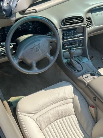

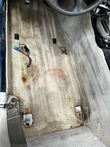

Last weekend I removed the front seats and gutted much of the interior for a good cleaning. At least one previous owner was a smoker, and for sure drank/ate/Lord knows what else in the car because calling it 'nasty' is an insult to the word 'nasty'.... Here's the view after the seats, console, radio bezel and etc all came out:
I have one of those Bissel Little Green carpet cleaners and extractors which got up the vast majority of the stains:
The only 2 I couldn't get up are whatever the hell the pink stuff is, and one big rust spot by the wiring harness. The seat track was pretty heavily rusted in that area and the harness was caked with crud which I am pretty sure was a spill that was left on the carpet and no one attempted to clean it up. For now I left the carpet in, but will be looking for a replacement set. Since both stains are hidden by the seat I'm good with it for now. The passenger side was WAY worse, but I got the worst of it up also.
While I had the console out, I did some things:
  • Re-glued the plastic mounting hole bosses on the back of the console. A previous owner had tightened the 2 rear nuts so tight it had split the plastic slots/tabs the nut seats down against.
  • Reattached the console lock cylinder
  • Removed all the wiring for the aftermarket stereo/rear sub and the non matching black double din and tossed it all in the trash
  • Replaced the bezel around the ignition switch (mine was broken)
  • Re-soldered the HVAC resistors (someone had tried this before I noticed when I opened mine up - and had done a trash attempt at it with bad solder joints everywhere. It's back to working now, before I resoldered everything the whole display was blank)
  • Installed the factory correct Bose head unit - thankfully at least the owner who had installed the junk head unit in the car did use the correct wiring adapters, so the factory harness was intact
  • Replaced the poorly fitting double din bezel with a good used original and correct shale unit I found online
  • Cleaned out all the crud in and around the shifter/boot and e-brake boot.
  • Used a hair dryer and a trim tool to remove the window tint from the windshield and door windows - it was so dark you couldn't see in or out of the car, and driving at night was a no-go. This car will never go back to the ghetto.

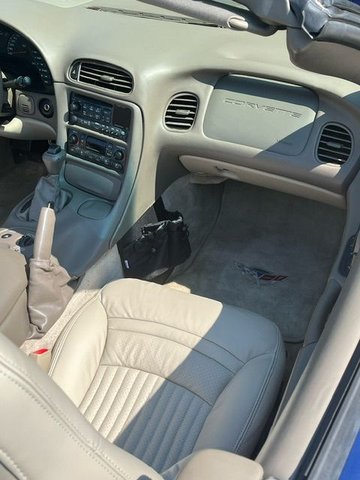

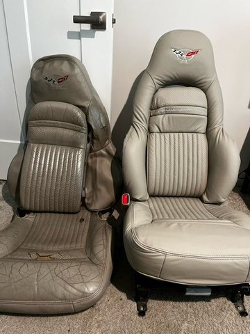

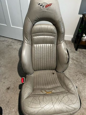

With the interior in far more functional and decent shape, I dug into the 'fun' part - recovering the seats, installing new seat cushions and installing new sunvisors (mine were both missing when I got the car). All of these pieces I got from Top Flight as I believe they are the only licensed dealer selling the correct Commemorative Edition seat upholstery. I opted for full leather surfaces as opposed to the factory leather/vinyl. Using the video Lyle from C&S Corvettes posted on YouTube as a guide I found the job to not be too bad at all to do and MAN what a difference in the look.

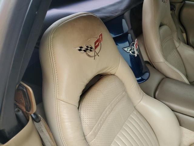

Here's the old driver seat:
And the same seat recovered with new cushions and cleaned hardware sitting next to the old covers:
I've since worked on the cover some more to get the wrinkles out, and letting it sit in the sun a bit helped a ton.
With the hard stuff out of the way I installed new lift struts for the tonneau cover and the trunk, reinstalled the seats and now it looks like this inside with a little before/after for you:
Before:
After:
Passenger side before:
After:
And the new seats sitting in the sun this morning:

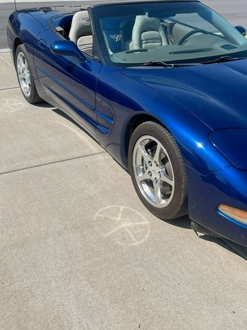

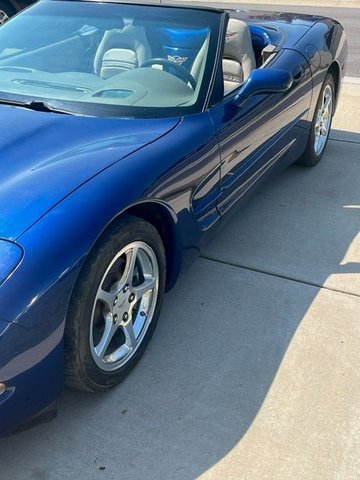

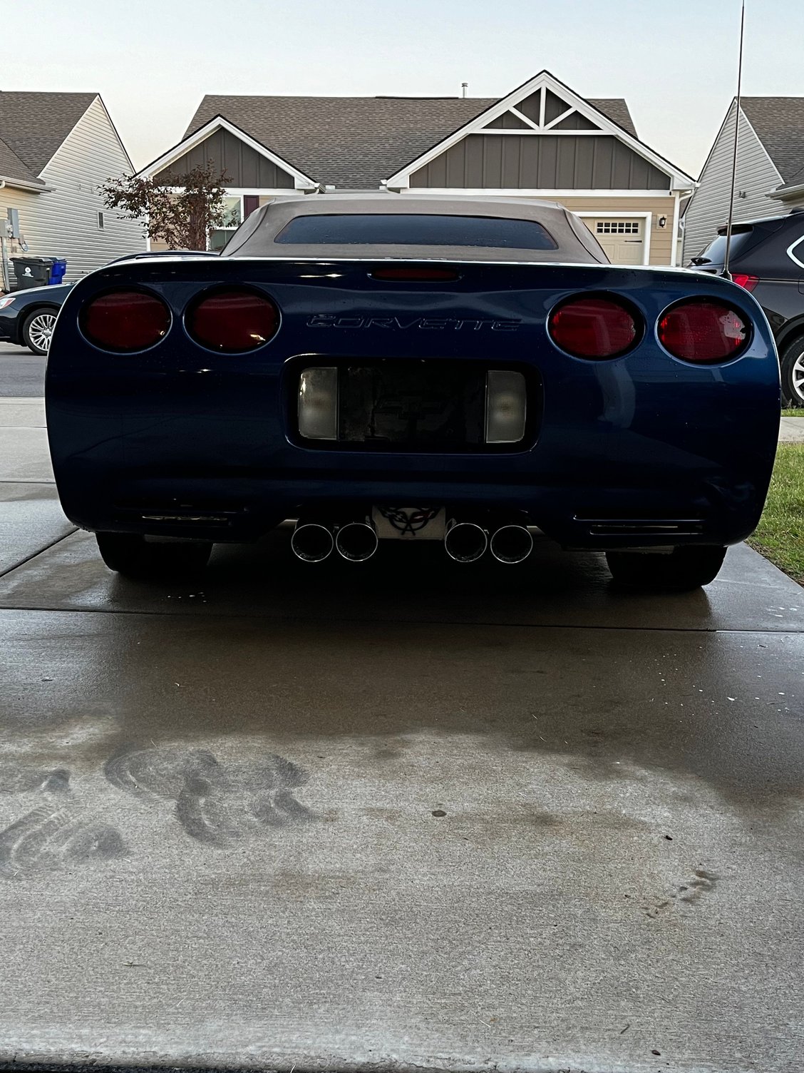

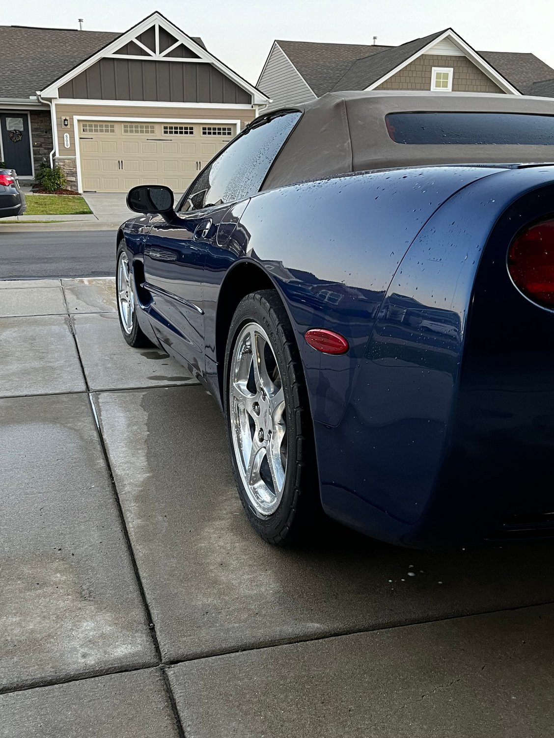

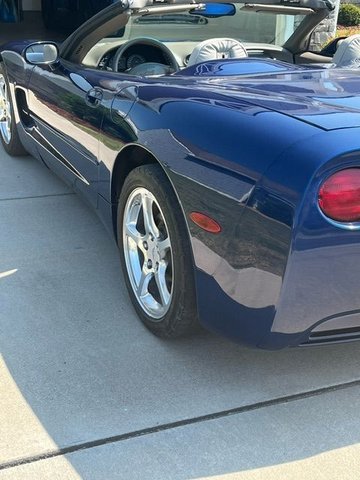

I'll leave the post for now with a couple of shots of the car as it sits now from earlier today:
And one from the left rear, which was a smashed mess 3 weeks ago....

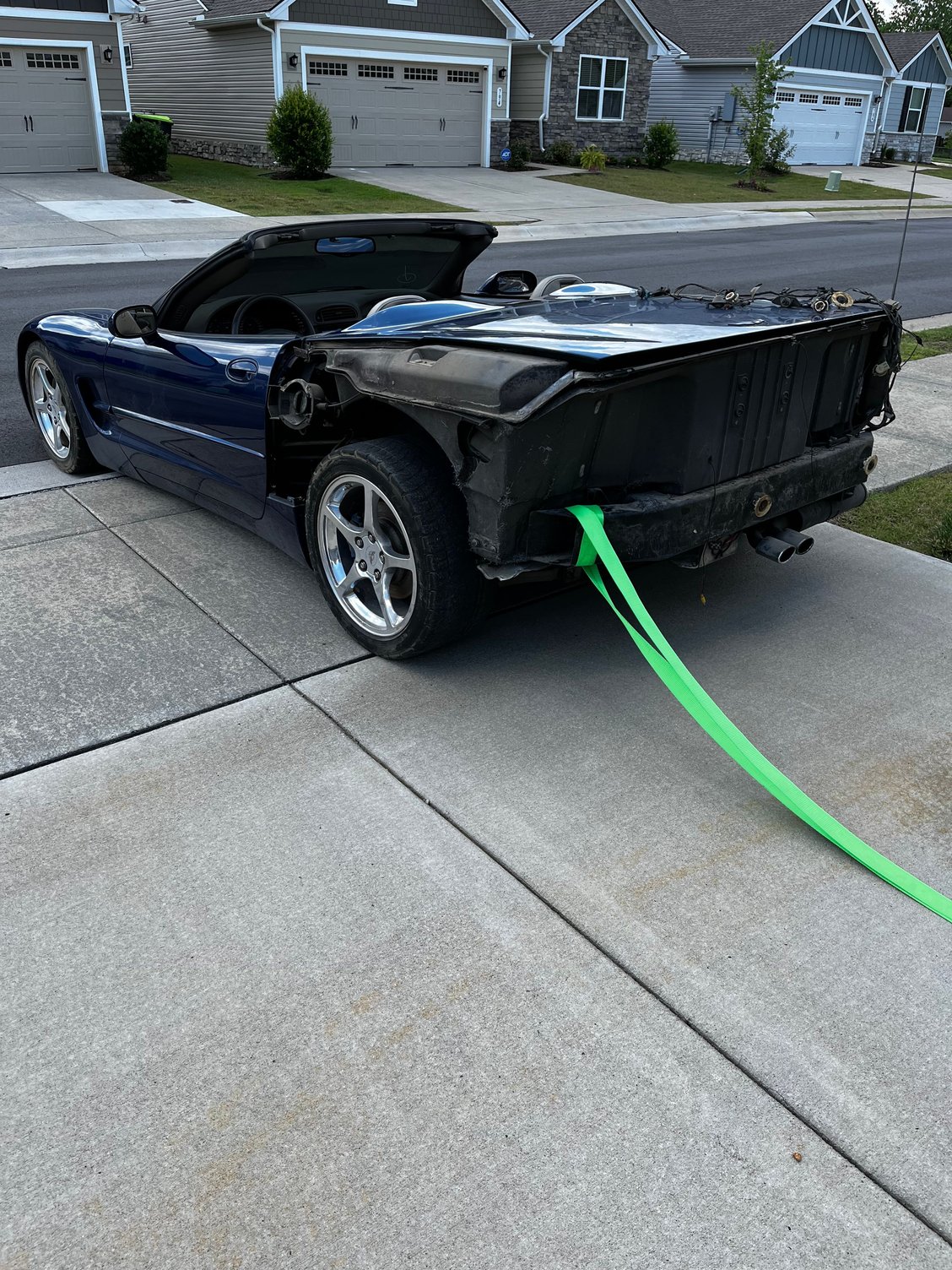

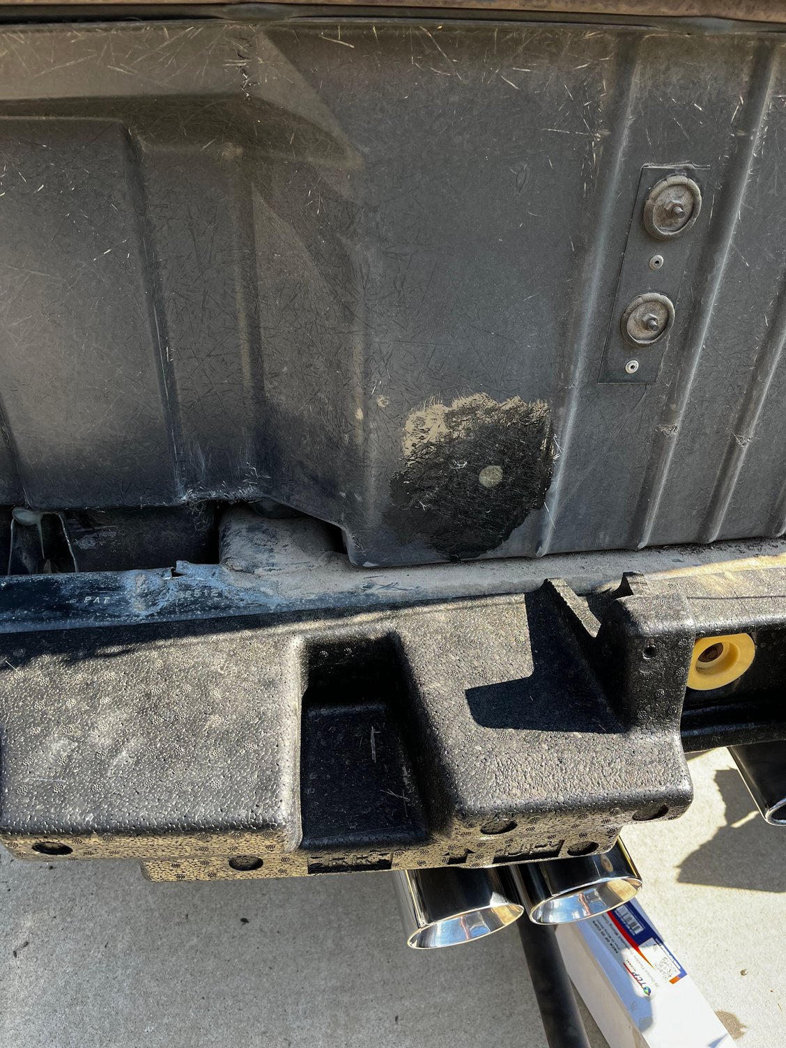

The left 'ear' of the bumper face bar got bent in maybe 30 ish degrees, along with the muffler, which pushed into the bottom corner of the tub. It's split down the left side in a few places and I have some work to do once it when I finish pulling the bumper straight. I have a gallon of Evercoat SMC resin and plenty of glass mat so as soon as the bumper is out of the way I'll start to re-form it back into the proper position and see what goes.
I think I'm going to wait until the replacement quarter and rear bumper come in before I apply new resin and matting on the tub, to make sure everything lines up before I make the tub repair permanent and end up with a tub that won't let everything fit like it should.

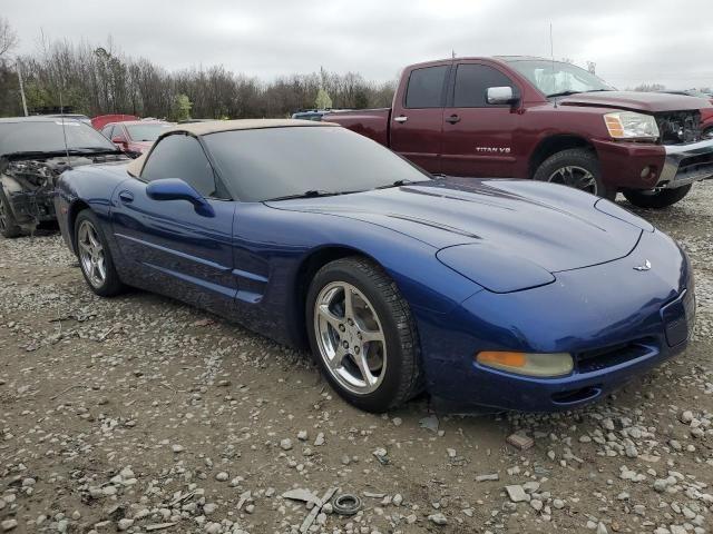

It came from a Copart lot in Memphis, TN. How bad was yours when you got it?

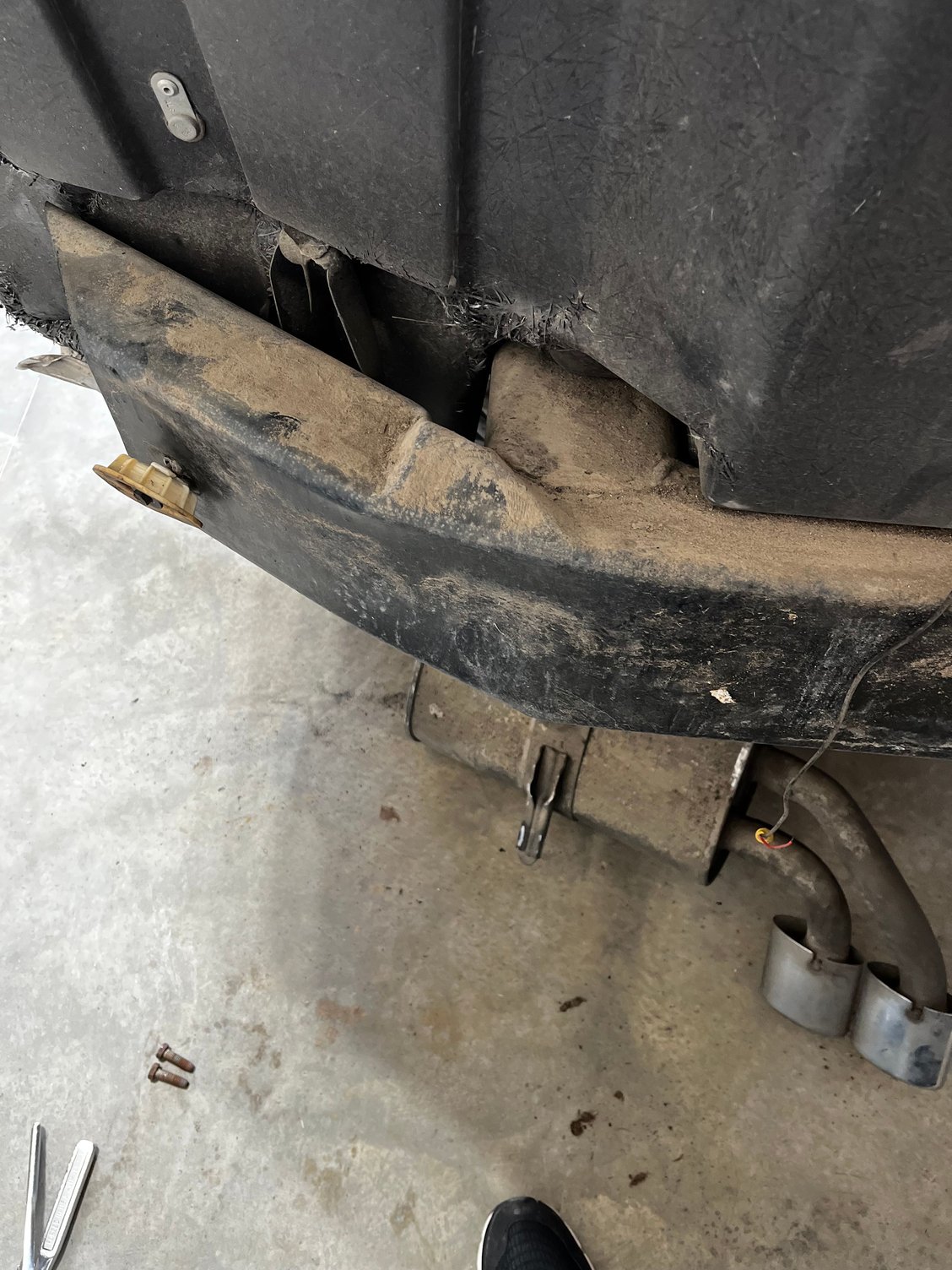

Well I had planned to finish getting all the bent parts removed from the accident damage and going to work on straightening the rear face bar.
I got the absorber removed, unbolted the badly bent left muffer and cut the muffler inlet with a sawzall to make it easer to remove and took off the rear sway bar because the drivers side looks like it was slightly tweaked. What I’m left with is this:
My plan was to pull the car out or the garage and pull it back in nose first so I could have more room to work with the back of the car hanging out of the garage.

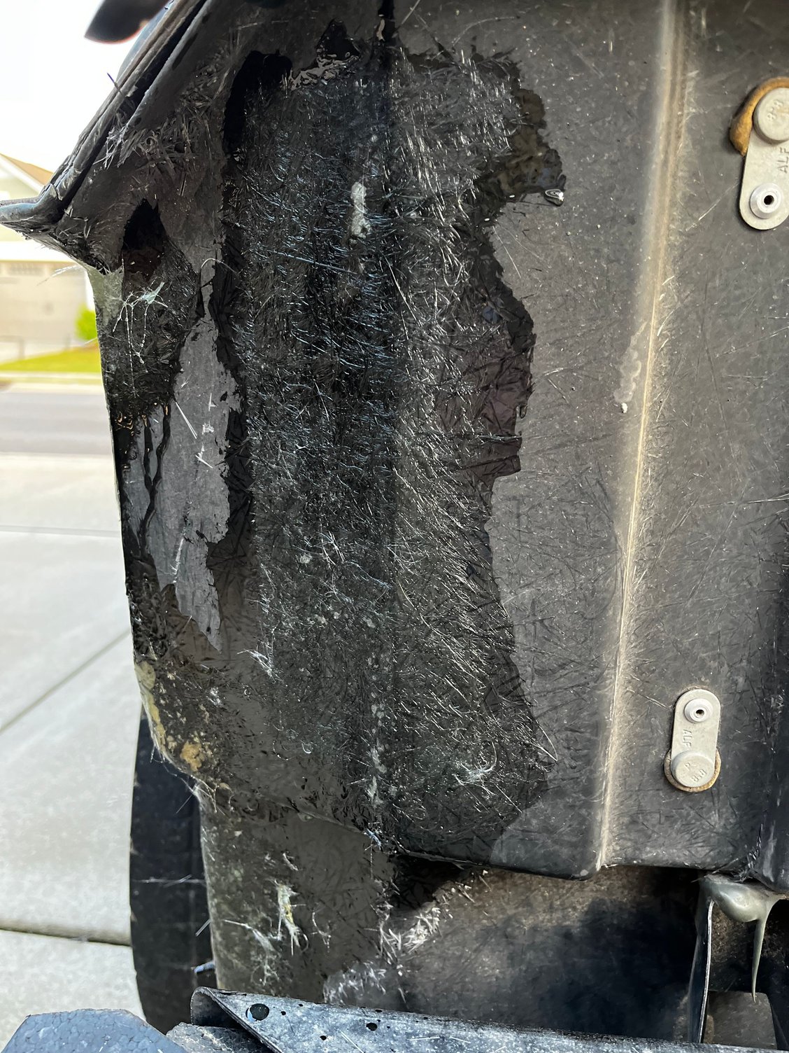

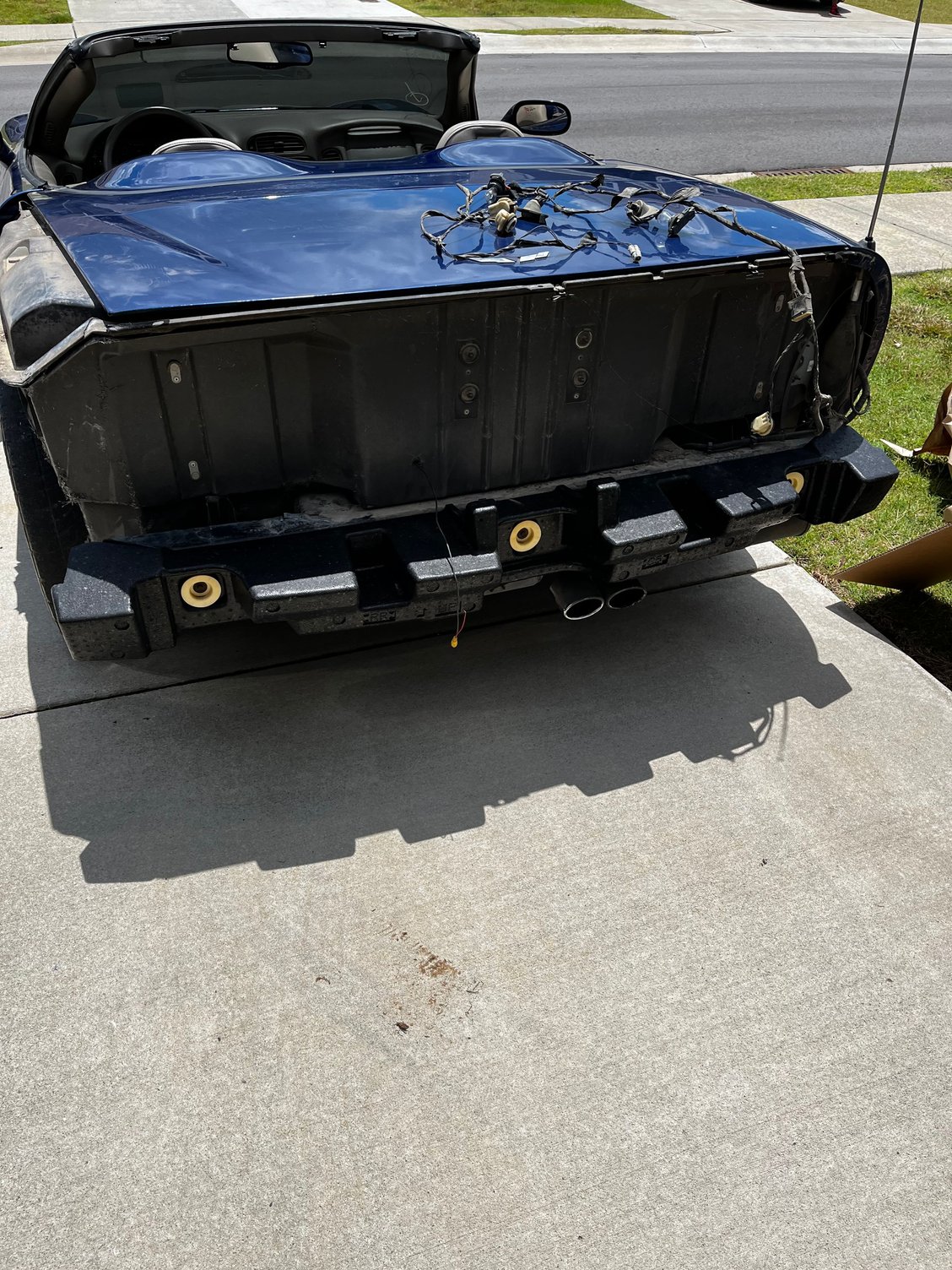

first order of business was to straighten the rear face bar. I tried doing this during the week using tow straps and a come along attached to my truck. All I succeeded in doing was to drag my vette backwards out of the garage.
Determined to not let the car beat me this morning I had the bright idea of turning the car around and parking it so the front wheels were in the gutter and the back of the car was in my driveway to use the gutter as a chock of sorts. Success!
Next I fit the new rear bumper absorber pad into place to make sure everything lined up ok and it did:

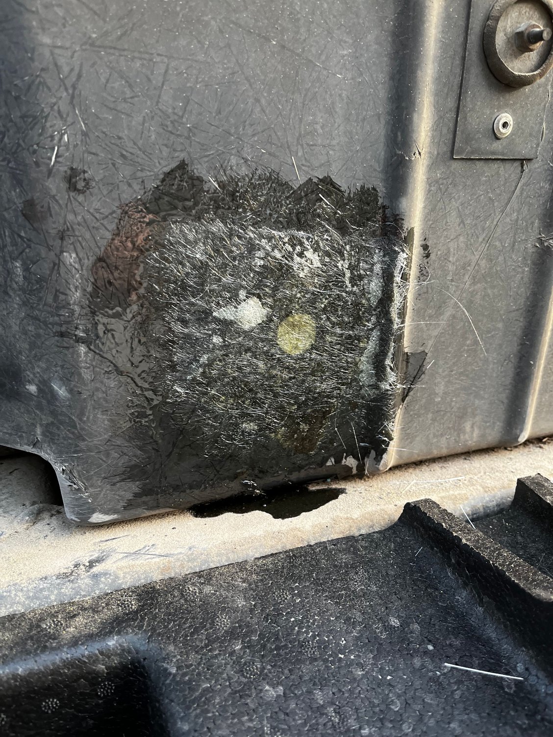

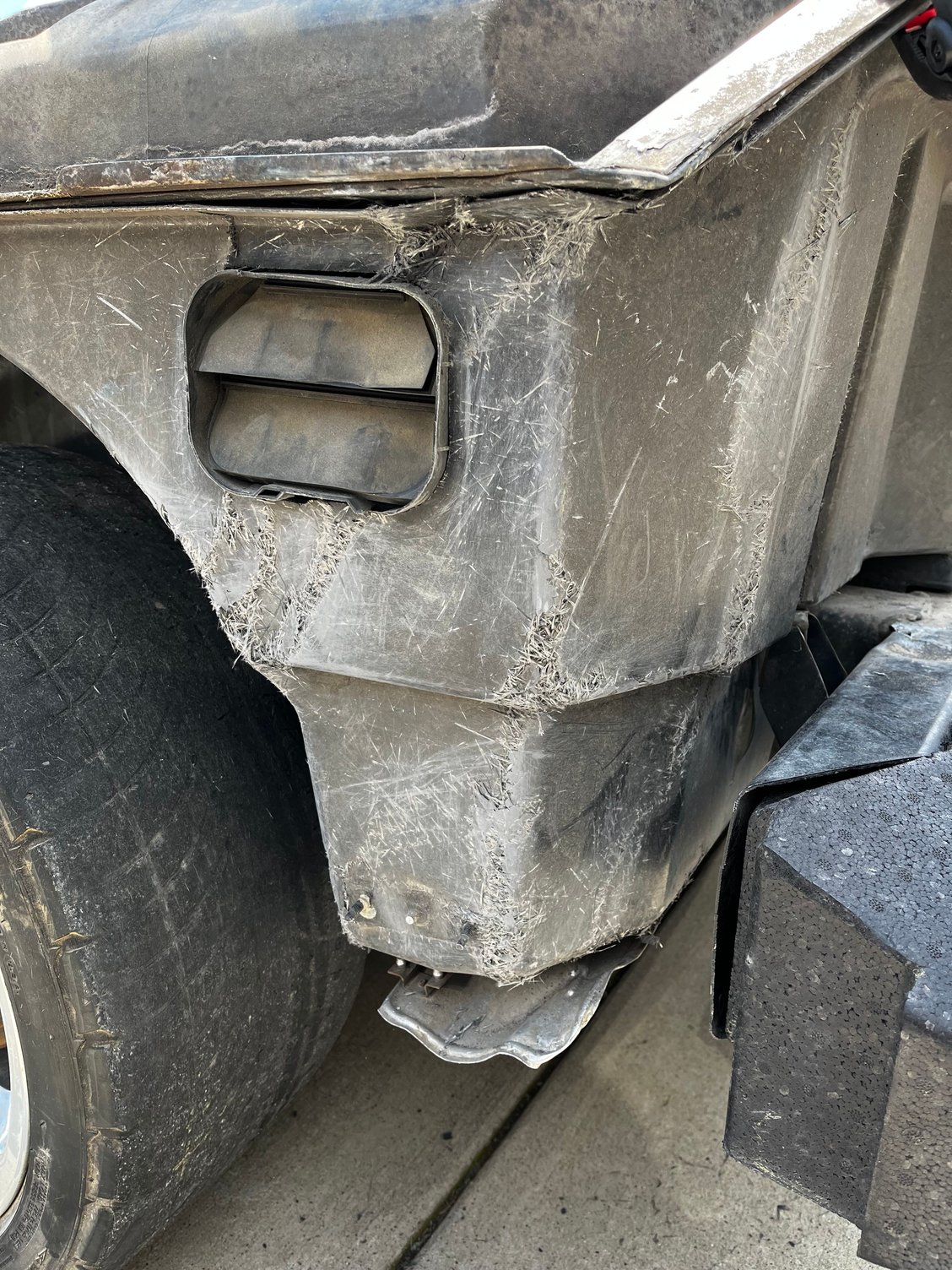

Then it was time to address the mangled bits of the tub. First I moved the crunched parts back into shape, supported from inside the trunk with some bracing to hold it in place. Then I spent a lot of time going over the damaged bits with 80 and 120 grit sandpaper to clean them up. I also cleaned up the ugly hole in the back of the tub some booger eating moron cut into it to add a camera/license bracket.
after that it was SMC Evercoat resin and glass mat time. I hadn’t done this kind of work in 30 years and it shows. Once this cures I’ll probably add more. No idea what to do with the mangled muffler shield on the bottom of the tub. It’s all there but butt ugly.
In order to have some kind of exhaust since the left side was destroyed I ordered a cheap eBay set for now until I figure out what I want long term. I got the left side done but was running out of time and daylight so I’ll have to hit the right side this week.
I also changed all the plugs and wires today - the engineer who thought the last plug by the brake booster and windshield on the drivers side was 'serviceable' has a special place in hell waiting for him. Also changed out the air filter which was stiff from age and completely full, as were the udders. I swear I don’t know why some owners don’t take care of their stuff while they own it….
Sorry for the long post but that’s the update for today! I have a new quarter and bumper already painted and ready to install as soon as I’m satisfied with the tub work so it won’t be long until it looks like a proper C5! Then I get to disassemble the interior, replace the seat foam and leather, put the correct shale radio bezel and console trim on the car, put in the factory radio instead of the ancient alpine double din that’s very poorly installed. Also need to figure out if my HUD has the broken pin or is dead or both. I get nothing at all from it. I also need to resolder the hvac resistors as the display is too dark to see. Probably more to come after that!

Another week of long hours after work in the garage has paid off. Here’s what you missed during the week:
  • right hand exhaust installed
  • new rear lighting harness installed
  • mounting tabs on left rocker repaired
  • another round of smc resin and fiberglass to finish the tub repair
  • mounted the new quarter panel
  • Attached the bumper cover
  • replaced the rear sway bar and endlinks
  • gave it a MUCH needed bath
  • topped off fluids and changed the oil
Left to do:
  • full interior overhaul. I have a new set of lemans commemorative seat leather and seat foam from TopFlight, new sun visors also from top flight and the correct shale color radio bezel and original radio
  • cluster rebuild - light bulbs mostly
  • hvac resistor resolder
  • finish de-wiring the old radio
  • Some panel alignment on the body still
here are a few more pics of the progress:
Tub is solid once more.
More to come this weekend….
