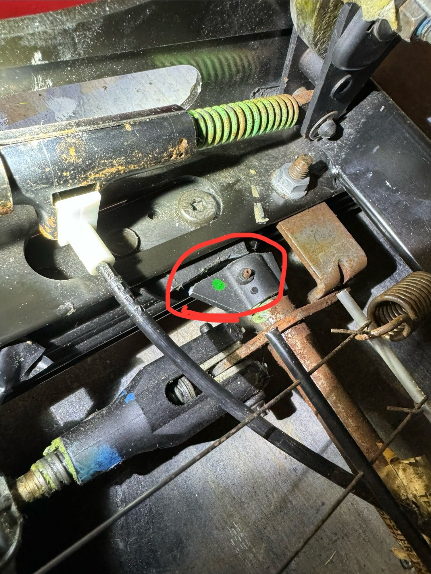

I was in the middle of installing a seat cushion repair kit, in the hope fo making the driver seat a little more comfortable.
During the install, I found that the previous owner had been in the driver seat already, and did a hack job, and part of the frame to be broken. Great start to a Sunday.
Is this broken bracket something that can even be purchased, or replaced?
If not, then I'm assuming that my only other option would be to swap out the frame. Would I be looking for a standard seat (non-sport) correct? Or is it different for Z06 models?
Anyone in the Alabama area looking to sell some seats?lol
I'm not looking for aftermarket seats, I would like to keep it OEM stock.
For reference for the photo, this is the bottom seat cushion area rear right hand side

That bracket looks like it's attached to the rod with some sort of set screw. I would venture it is unobtainum so I would consider a seat track replacement. I believe there is no difference between Z06 and base seats

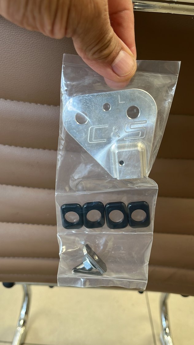

Did the seat rock with C&S's parts. Great choice. Glad I did it.
