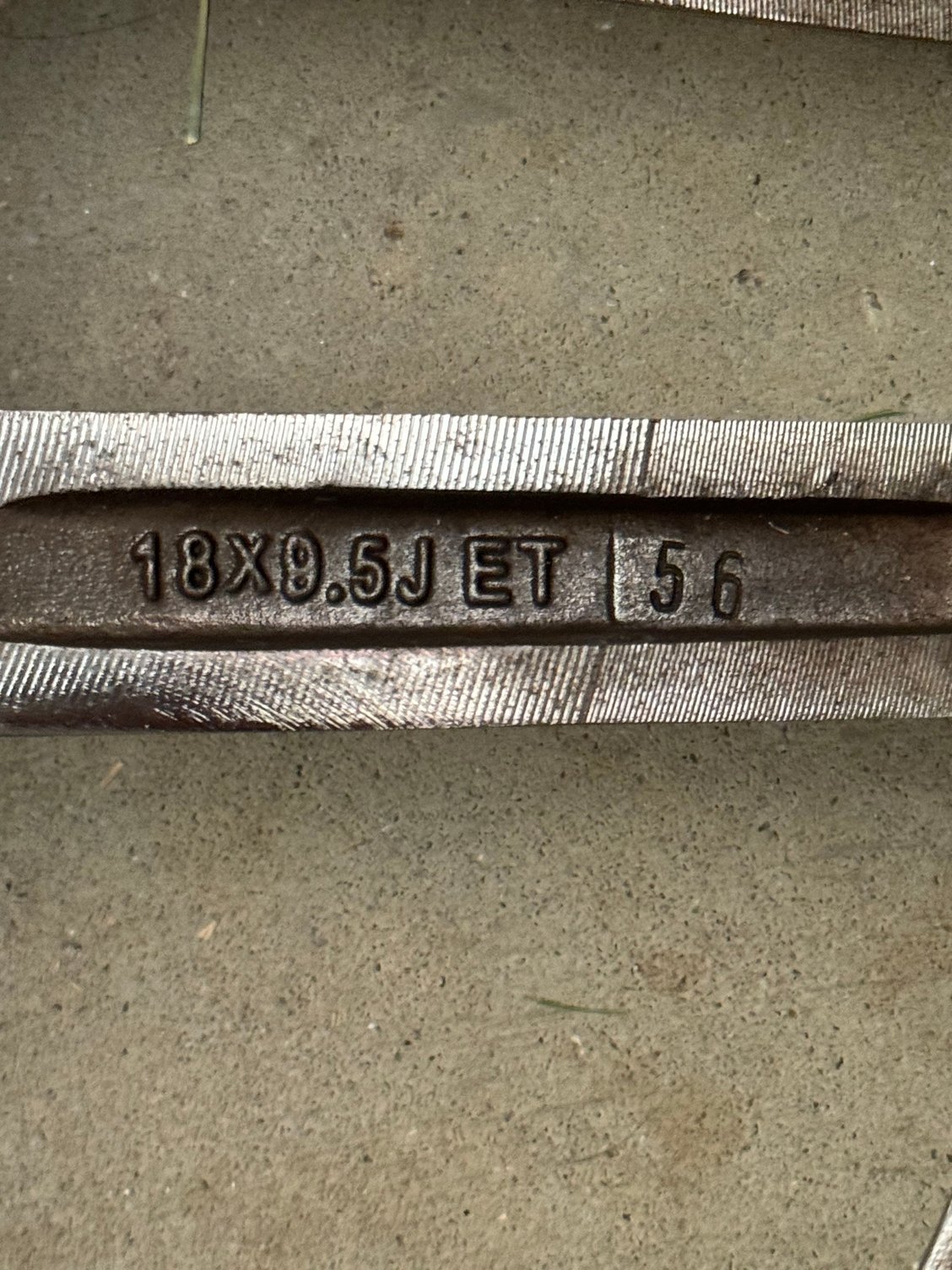

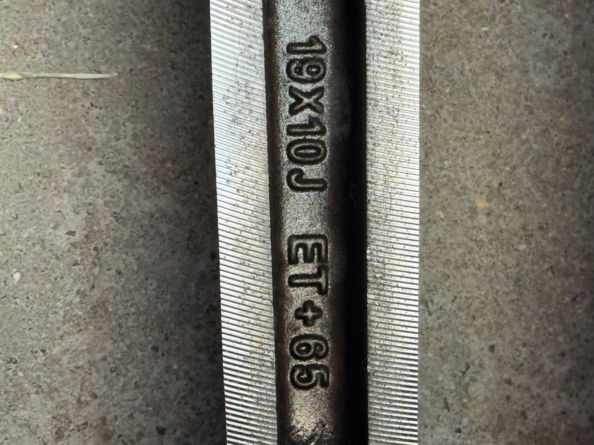

I inherited a 98 convertible that has aftermarket reproduction wheels. The tires are from 2008 and need replaced. Looking for tire combos that will fit and look good. If the car is lowered at all it is by an inch or so. Here are the wheel specs.
Wheel logo: JF as best as I can tell.
Front: 18x9.5J ET 56
Rear: 19x10J ET +65
I a debating between
front 265/35 or 40 and 275/30 or 35 or 40
rear 295/30 or 35 and 305/30 or 35
Thanks for any recommendations.
