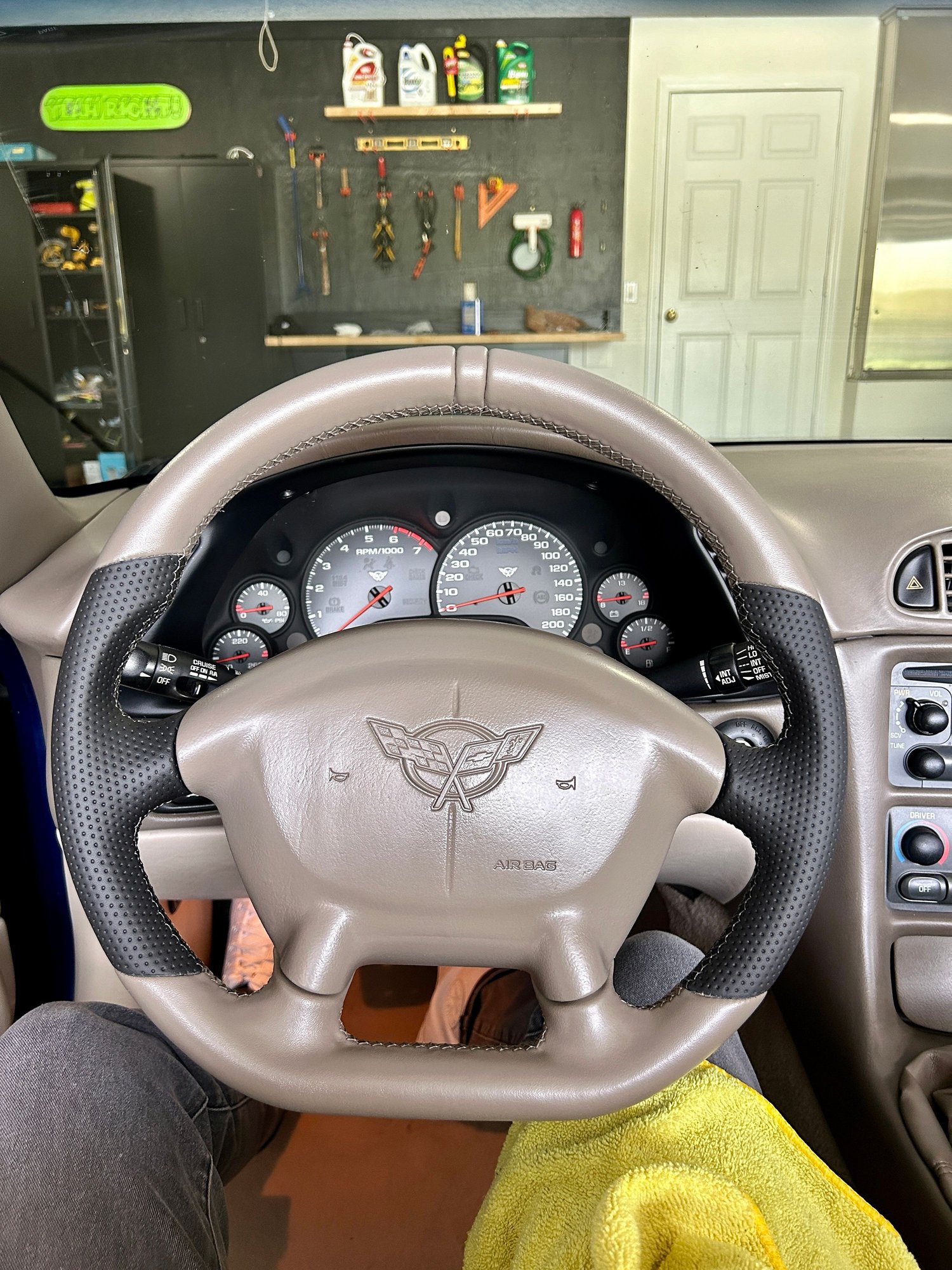

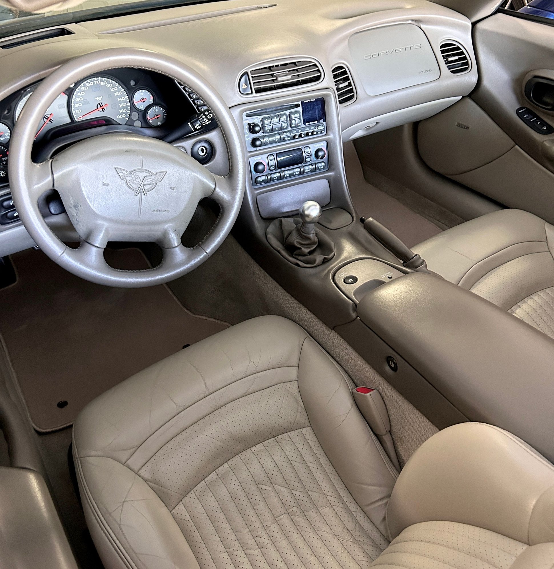

Gonna let this cure overnight and install it. I already have the old wheel pulled, what a PITA.
Before (someone got too aggressive with a cleaning product/solvent):
after (going to a black shift **** to tie the accents together more):

I ended up using Express Paint for the source of the paint instead of colorbond. Colorbond now only list a "shale" and not the Medium dark neutral. Is Shale the same? I don't know, but I took the option that matched the writing perfectly as opposed to taking a chance on "shale" being the lighter interior color and not the darker. Problem is, the express paint does not have a flattener agent and the finish came out too glossy. I will probably take a scotch brite to the finish to dull it out slightly. If I did really light dust coats I probably would have achieved the finish I was after but I laid it wet without really thinking about it in the moment.
A little heartbreaking after sweating in the garage for about 3 hours lol
I wouldn't mind repainting my stereo dash - so that might be the next project to test the shale color. Worst case scenario I will redo the steering wheel if the shale color works out and knocking down the sheen does not.
I love the shale interior but it would certainly be easier to live with and repair a black interior or even the two tone variants with black uppers.

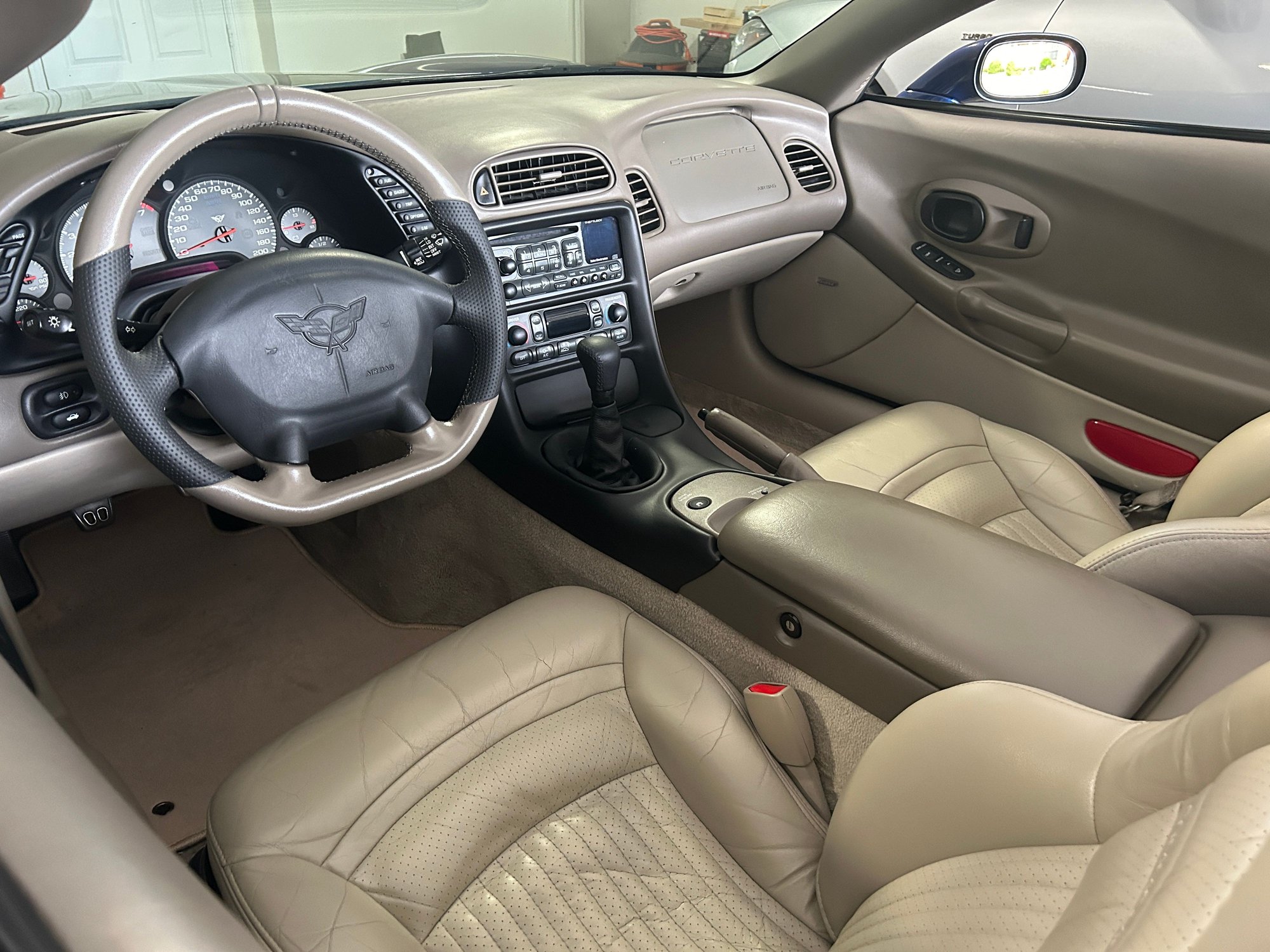

Because I can't leave anything alone. Documenting so maybe someone can avoid the mistakes I've made. First attempt was to match new wheel and airbag stock for stock, I used the wrong paint but the color match was spot on. I wanted to repaint my gummy radio bezel while doing some shifter work but the LVP color match was off a tint. So I decided to take the airbag back to black and paint the radio bezel black to bring in more black elements. I then scratched the steering wheel and took it back to black too. I honestly like all the looks here but it's much easier to take care of not worrying about how delicate a painted surface is.
Eventually, I might paint the console shale to match the seats, I think that would look slightly better, but I honestly might just rock this for a while. (I still need to figure out the shifter boot with the new ****)
PS. It's kinda crazy how just 91% alcohol completely destroys both the stock painted airbag and this LVP stuff. Nothing else was used to strip this paint back

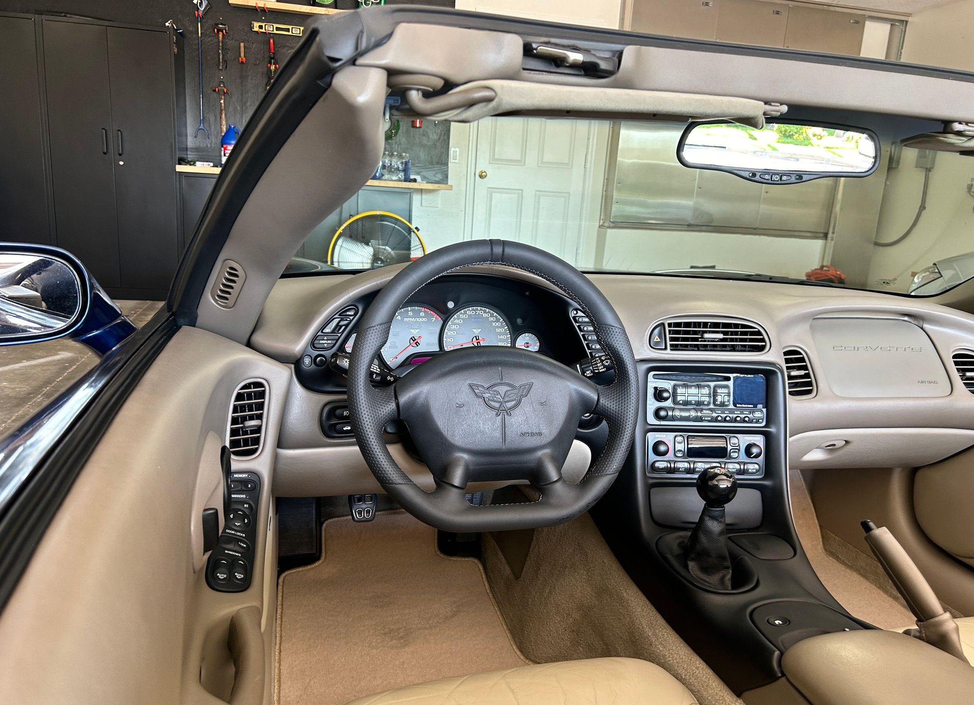

Did some minor adjustments, painted the traction control panel black and shortened the shaft a bit on the shifter to eliminate the locking nut look. I got lucky and the length was perfect for alignment. Also took a lighter to the threads on the steering wheel as someone had previously suggested as I never did it pre painting.
Overall pretty happy with the overall look and feel. I don't think anyone would even know it did not come like this from factory if they weren't a corvette aficionado.
