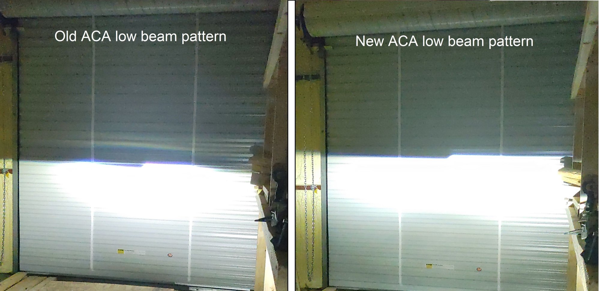

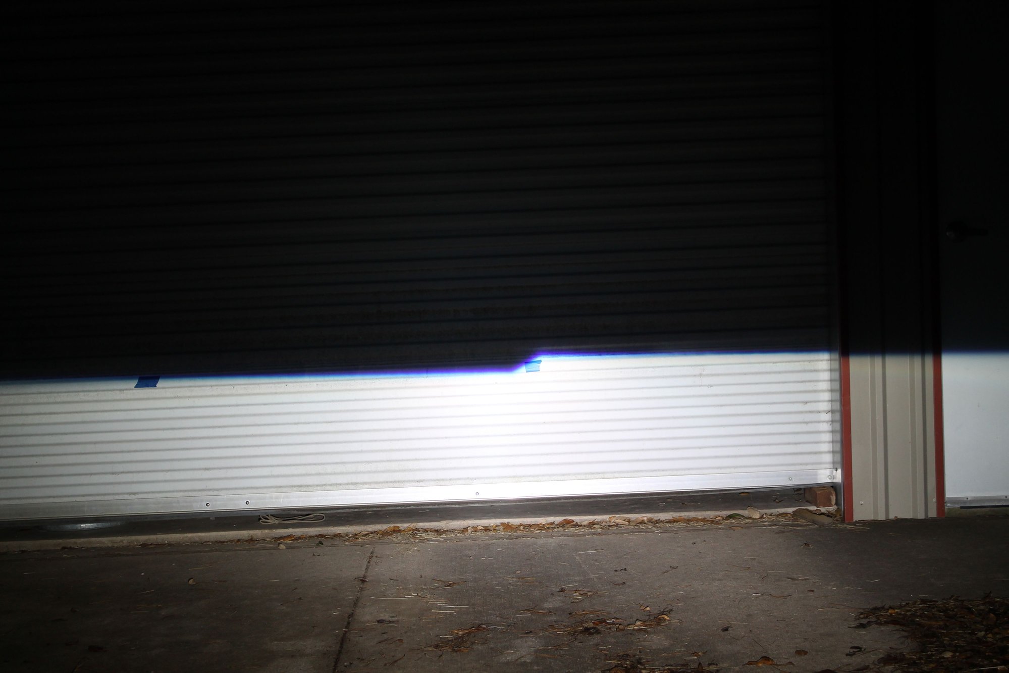

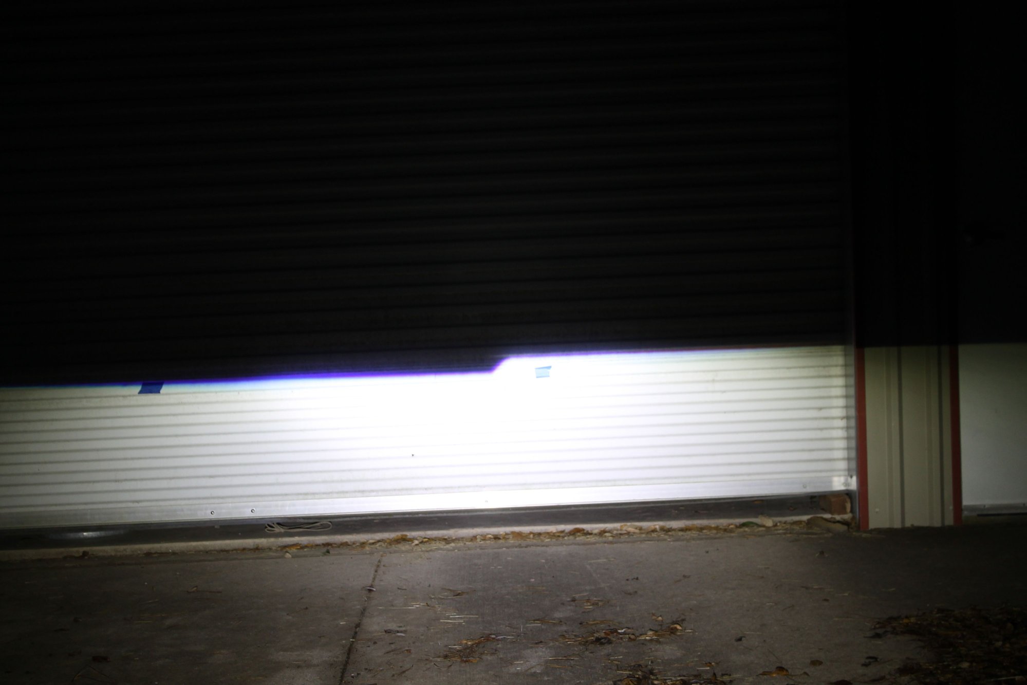

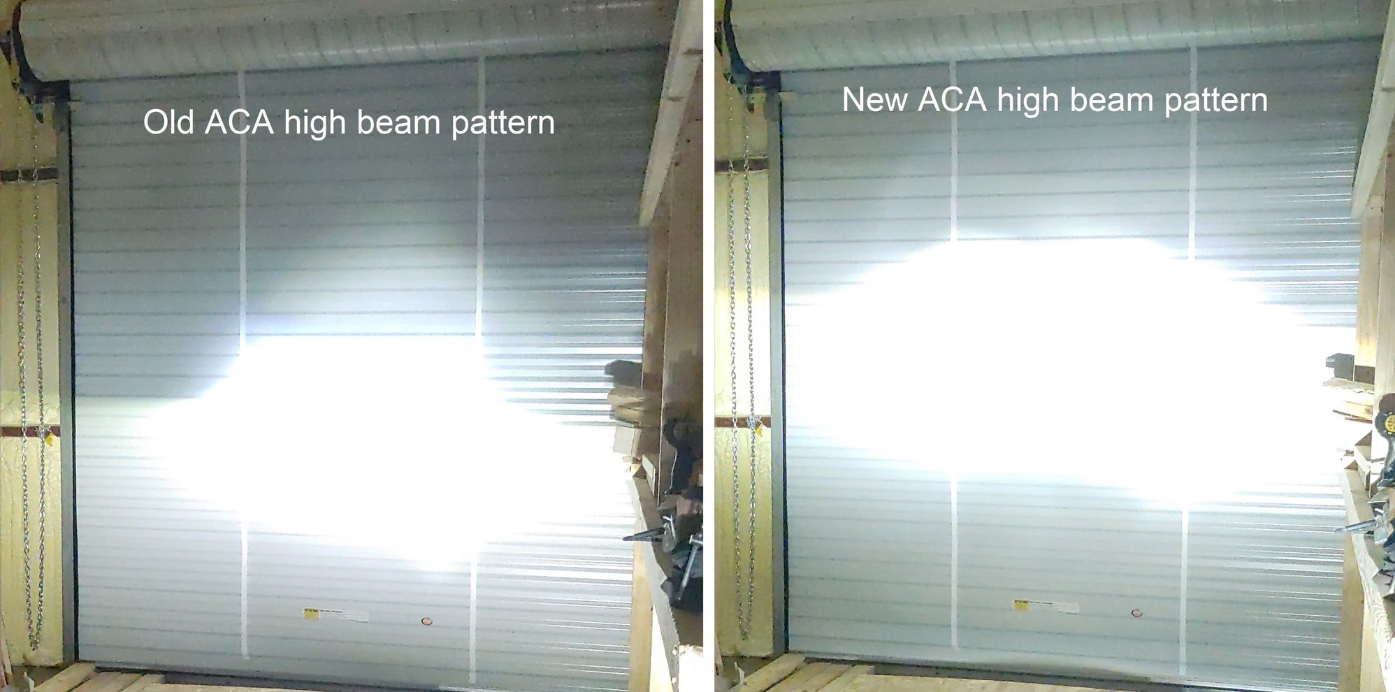

To address the OP:
We are currently on our 3rd generation of LED Projectors past our old HID setup.
The biggest challenge with our HID setup was maintaining a proper bulb alignment in the projector. Moving to purpose-built LED projectors, the LED chipsets are built into the projector and have perfect focus.
Based on our testing, there is practically no difference in the visible spectrum output of the 5000K HID and our first gen LED projector. Since then the biggest changes are the output of the LED chips and the increase in hot-spot width without sacrificing lux output at TDC of the pattern. The latest generation provides excellent down-road projection and width without excessive foreground glare.
HID projector low beam
LED projector low beam (Gen 1)
LED projector Gen 1 vs Gen 2 (low beam)
LED projector Gen 1 vs Gen 2 (high beam)
