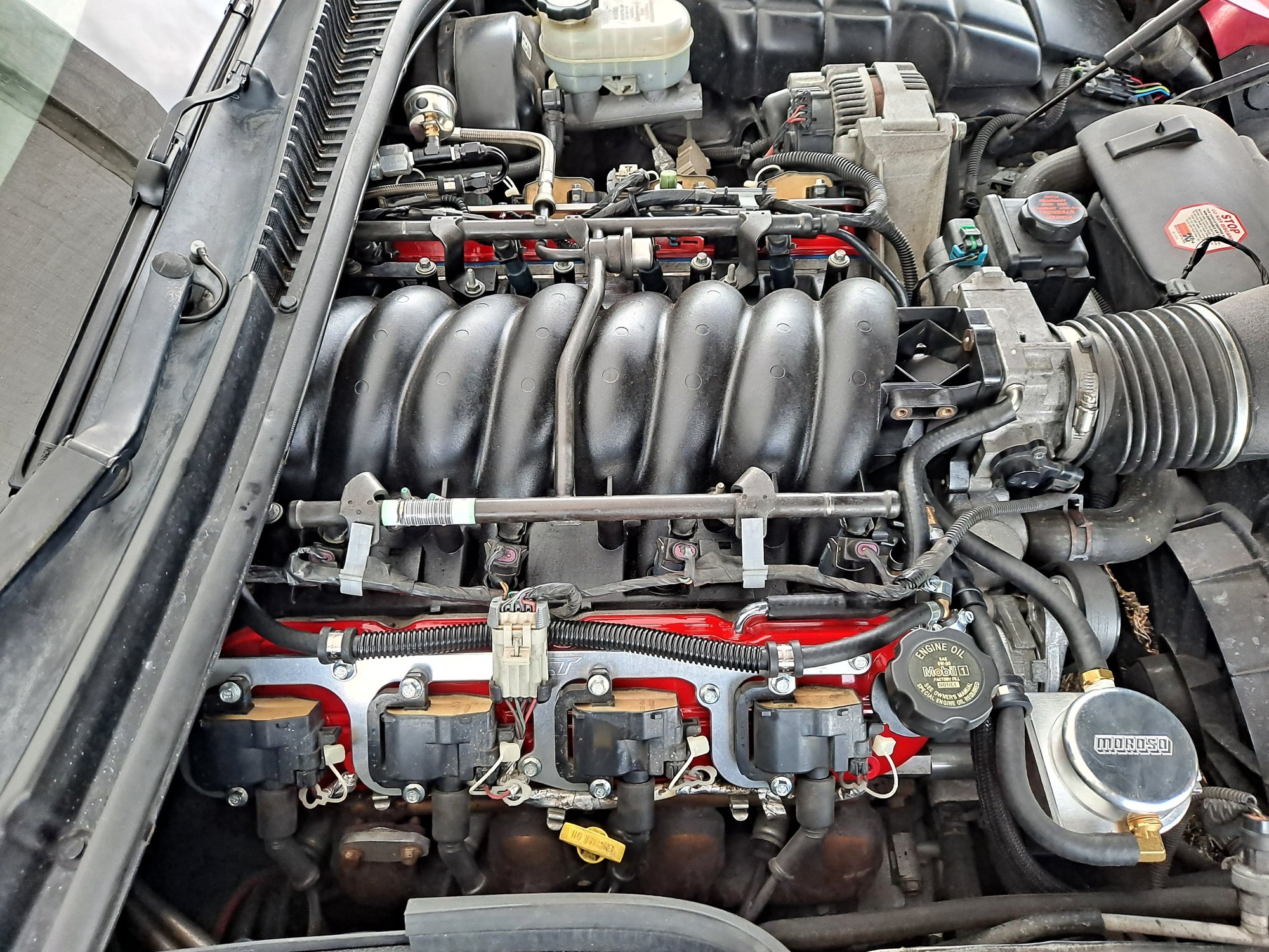

Speaking from experience. My 2K has 124,000, runs great. When I replaced the intake with an LS6 unit I noticed a lot of oil in the intake. Having used catch cans several times in the past on boosted Grand Nationals, NA engines and on my quarter mile runner Harley's I put one on my LS1 along with an LS6 valley cover. It catches around a tablespoon or two in a tanks worth of gas. I am planning a powertrain update soon so not really worried about the seemingly excessive blow by, IMO a lot of it is caused by the piston rock/slap compromising the ring seal the LS1 is so famous for.

I have a Moroso that drains from the bottom with a valve, that is about the amount I get in a tank of fuel. Oil lowers octane rating, good enough reason for me to keep it out of the intake mixture.

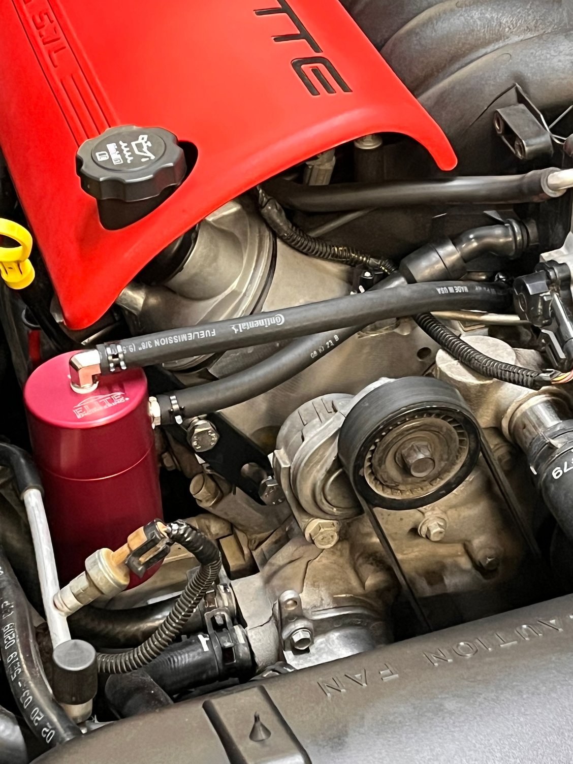

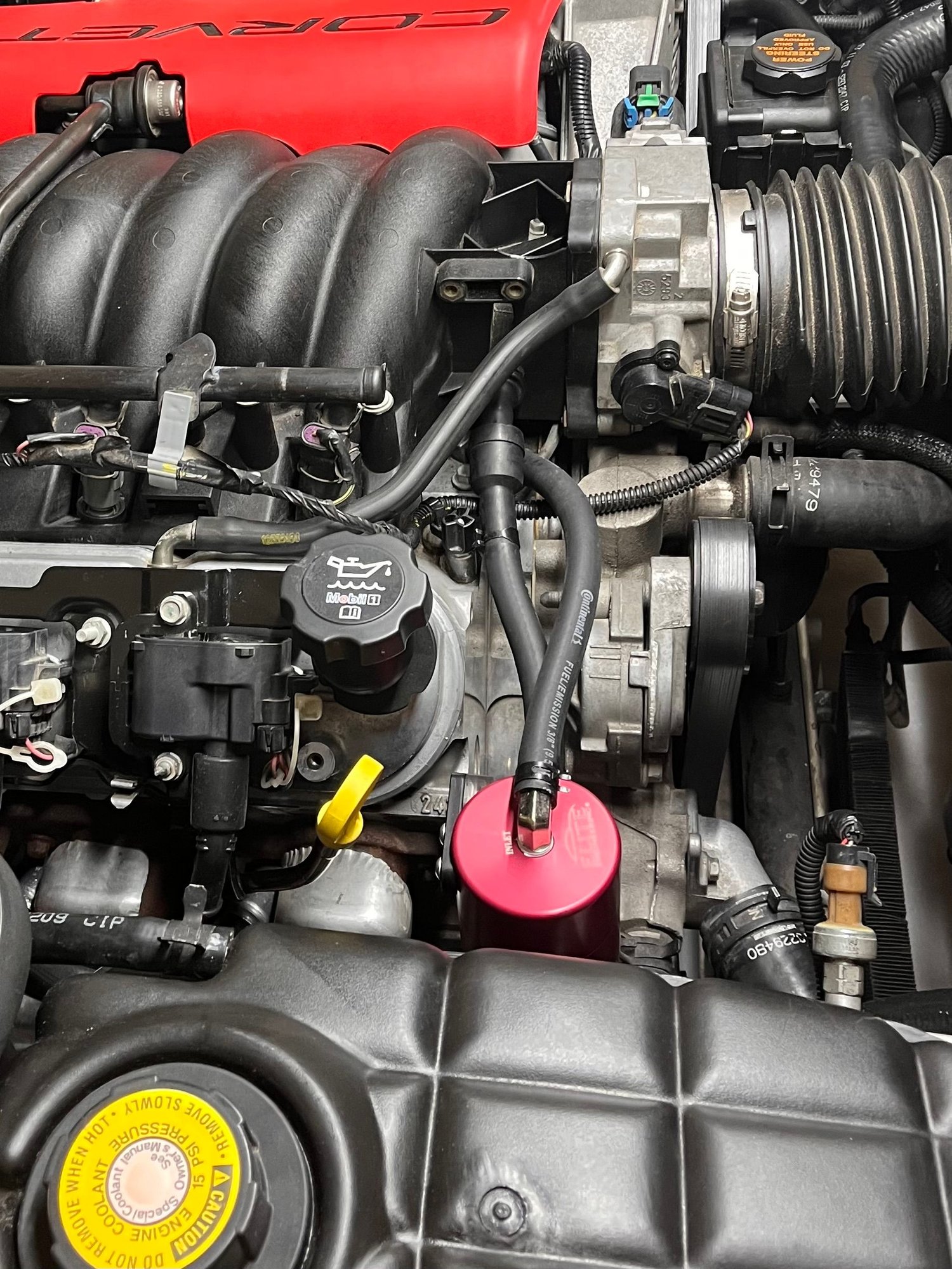

Here’s my setup, about one tablespoon every 1k

Originally Posted by corrrvettec5
what year is your car? I thought i’d the line comes of the valley cover it has a built in pcv valve
2003
Old Jul 13, 2024 | 05:56 PM
captain vette's Avatar
captain vette
Joined: Dec 2015
Posts: 3,947
Likes: 1,407
From: Canada
Originally Posted by CorrrvetteC5
did it come from the factory with an external valve?
the valve you see on the line is the original factory valve that was on the car
