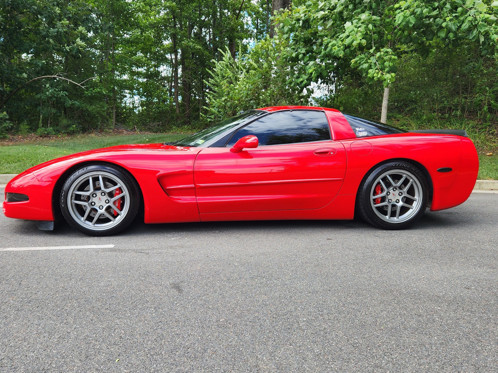

265's front, 295's rear. "Bob's House of Wheels" and Fortune Auto Coilovers.
How do the 265s look on the front width wise? I’m running 265s on 9.5” wagon rear wheels at the front for my track setup. Having matching wheels would look nicer.
Fit, I think is spot on.
