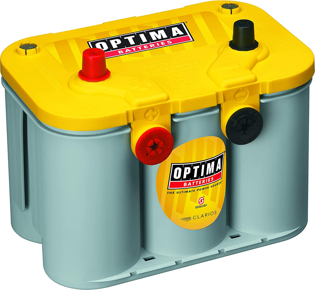

Just do the AGM battery and do the Yellow top Optima. I noticed Optima changed their recommendation for the C5 and my 911 to Yellow.
Optima is a glass Mat battery that is in cells.
No mess no fuss and you need a tender with any batter and by now you should own a AGM charger since most cars comes with them now.
