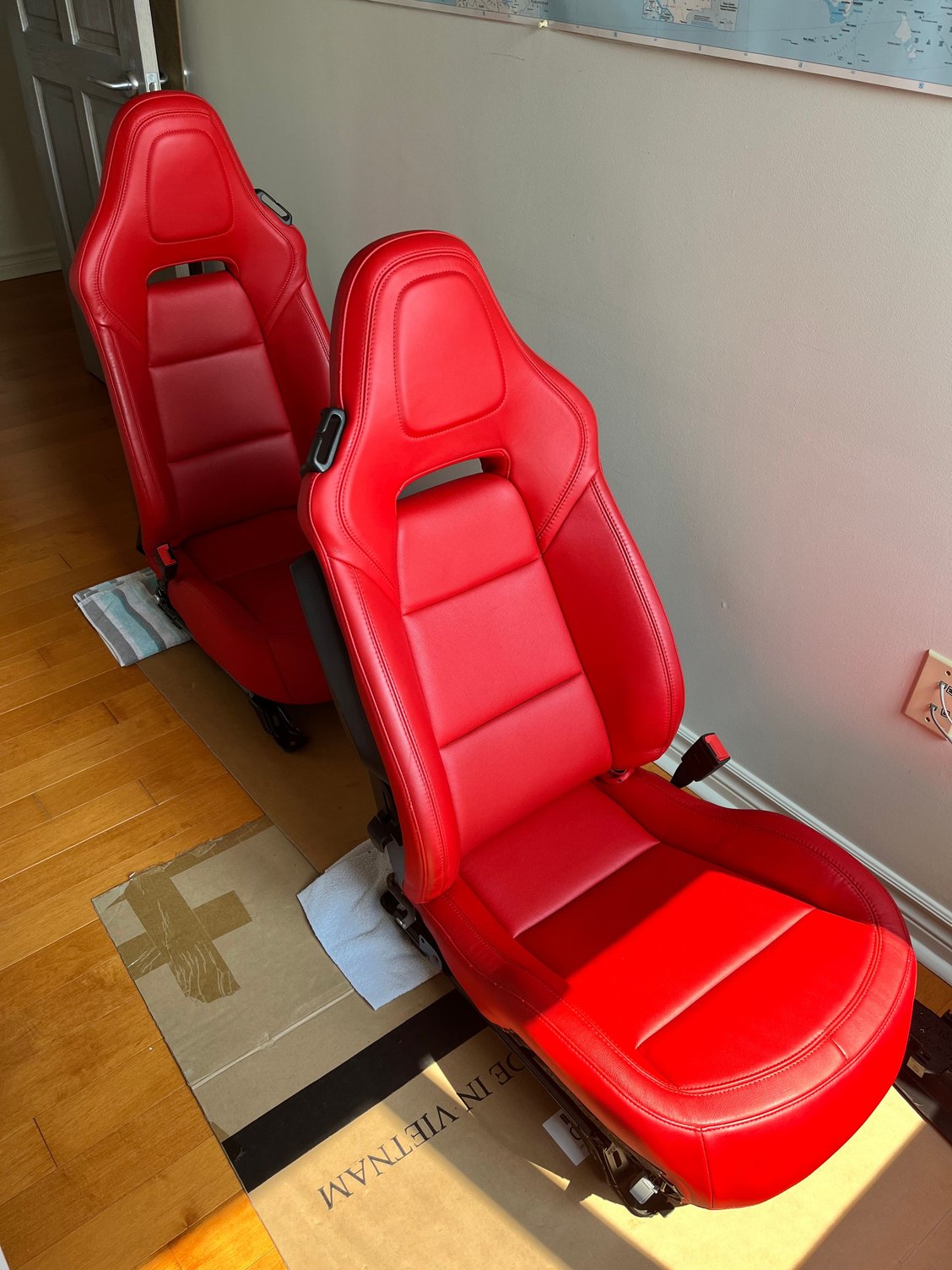

captain vette's Avatar
captain vette
Joined: Dec 2015
Posts: 3,947
Likes: 1,407
From: Canada
2018 C7 1LT seats class,comfort,support
