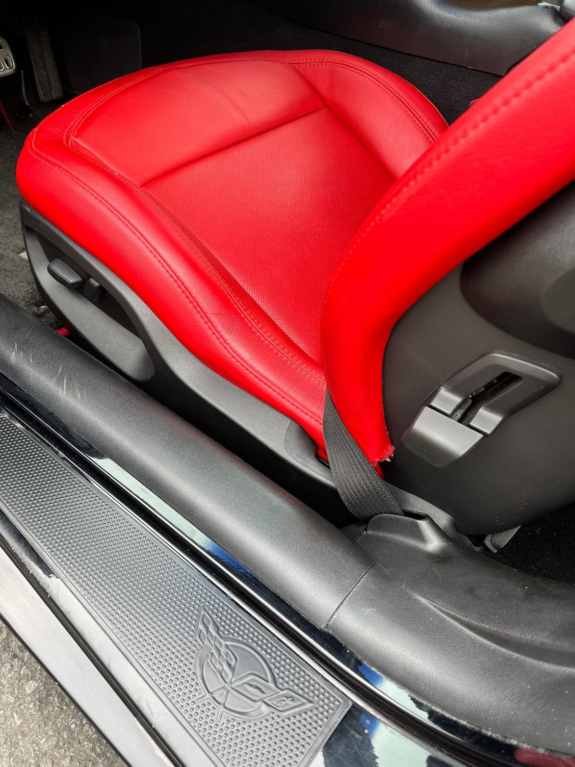

Done

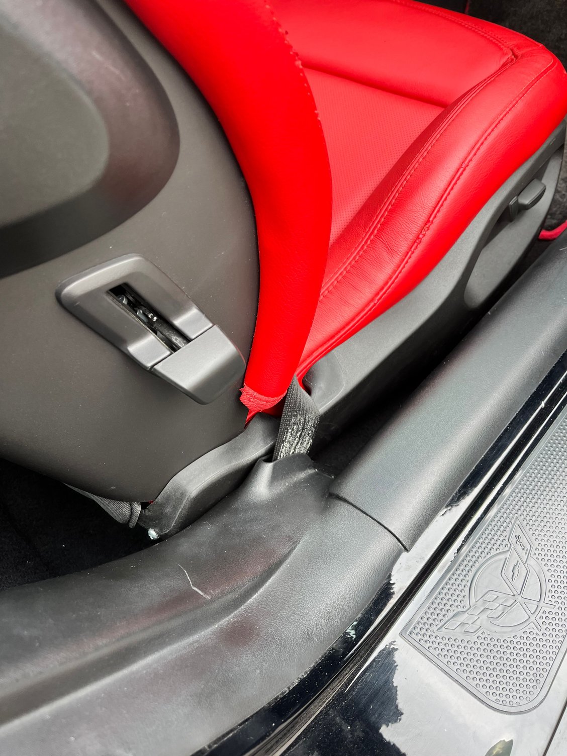

Looks awesome, thanks for sharing these pictures. I also just picked up some C7 seats, and I'll be doing this soon. I noticed you have not trimmed the side covers on the seat at where they might interfere with the lower retractor mounting on the C5. Does your car have enough room? Or maybe no plans to adjust them all the way rearward? Just curious.
I’ve never wanted to cut the plastic cover I think that looks awful, the trick is to cut the bracket that holds the cover in the back so it can be pushed closer to the seat so you can use all the travel available, I know I’ve to paint that screw in black before you ask. Good luck
Cool, this is good to know. I didn't want to cut my side cover either and I'm glad you share this bit of information. Thank you.
They are fine if you don't need the seats to go back more than that however for me to fit (6ft) my seats needed to go further back and that piece binds up with the seatbelt retractor cover and limits movement. I had to take the seat back out and cut the bezel for the seat to move back. Its not something that you'll notice unless you know the install or its pointed out
I can tell that my seats can go all the way back on both sides without cutting the plastic cover, maybe your seats or car are different or it can be mine who knows.
Mine would bind up and make creaking sounds without cutting, seems like some do and dome don't.
