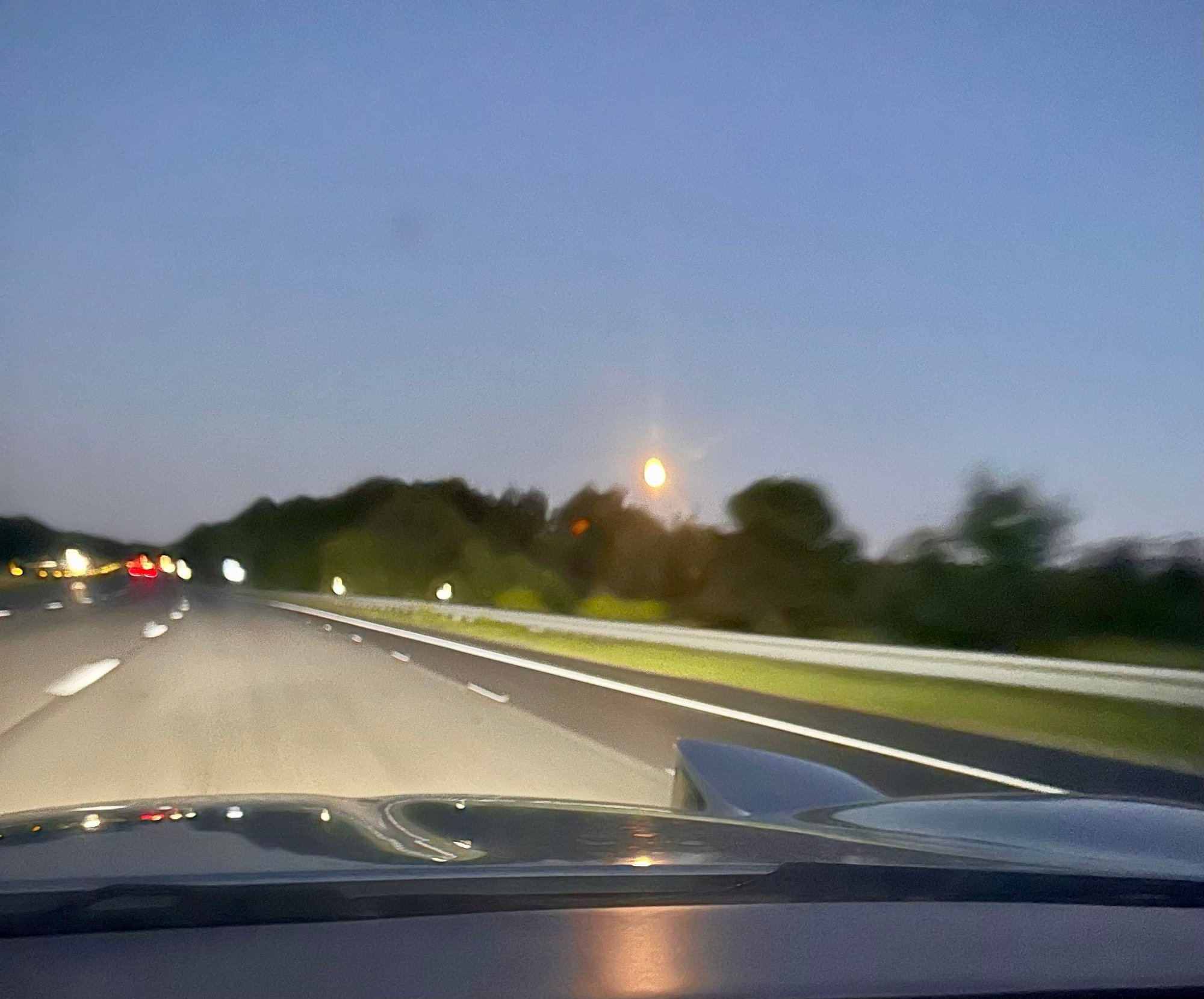

i ride with my high beams on 100% of the time in the city.
because of their angle, my high beams are not pointed any higher than the low beams so the highs don't blind the oncoming traffic and i've never been flashed
plus it looks cool as hell with all of them on

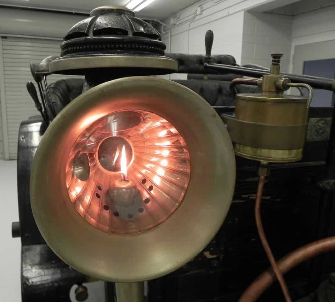

Originally Posted by glbeauchamp
Candles are almost as good as the stock headlights
Maybe better
