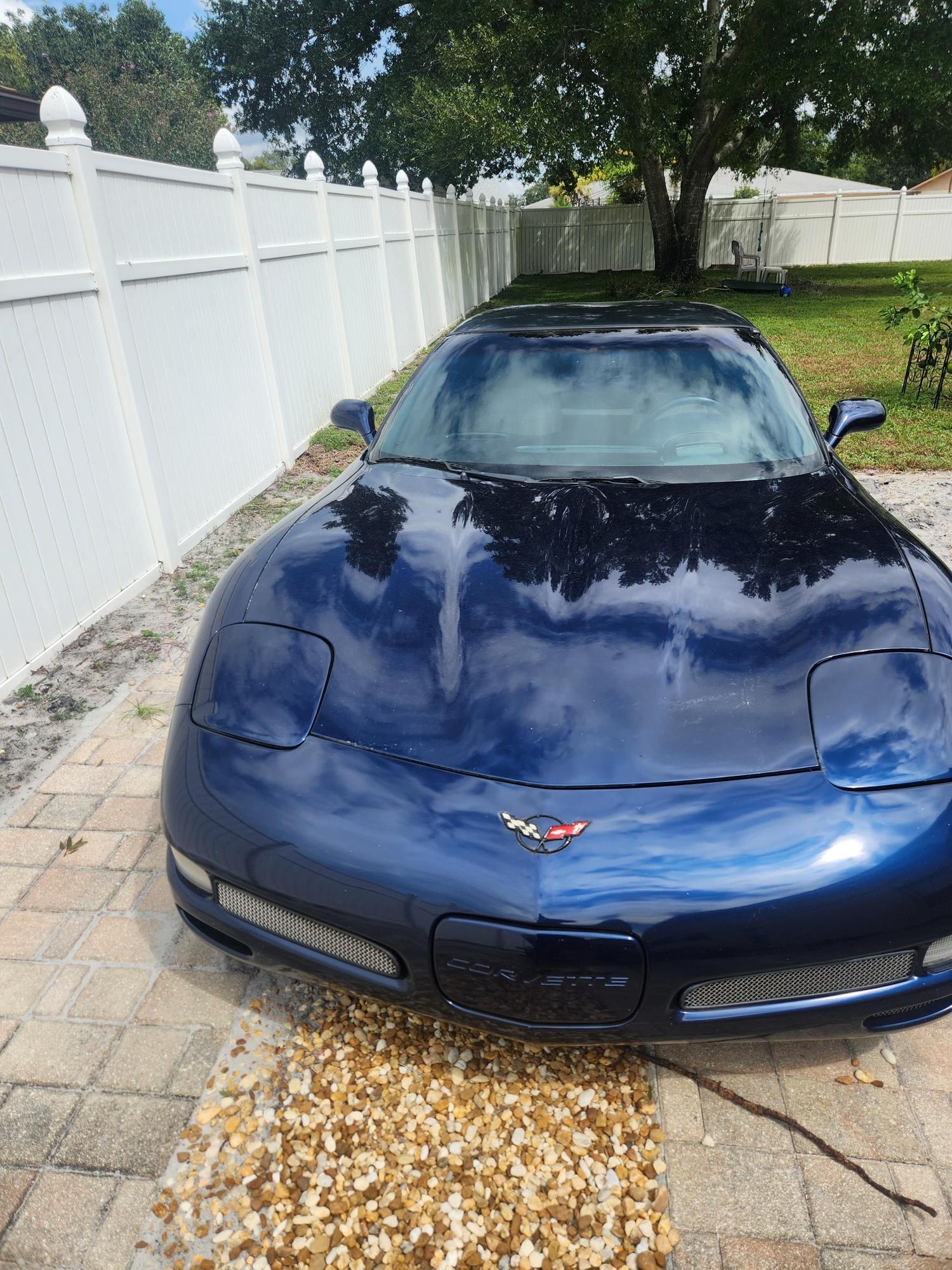

Hey All!!
So a few months back I inherited a 2000 C5 6 Spd, with 46k.
My older neighbor had it for years (purchased it used) but one day while leaving for work it got super loud and rattled from the engine (pretty sure main bearing?)
I guess my main motor question is: Rebuild? or Replace?
I hear if the main bearing/s get bad enough that it kind of trashes the block, I'd love to get feed back from those that have experienced something like this.
Pros for me:
Basically got the car for free (traded a 2012 Honda CR-V)
He washed it religiously, and always had it in garage or under cover.
Looks like original base wheels were replaced? (I may be wrong)
Has what appears to be a decent aftermarket exhaust and intake (can provide photos)
I've got more tools than I could ever need (former motorcycle technician) and I'm not afraid to use them.
Interior is clean (ish) and has a non OEM head unit.
Most shocking... Wife wants me to keep/rebuild it (mind blowing)
Cons for me:
I live in FL, don't have a barn/garage to work in and its 1000 degrees, or hurricane-ing.
The interior is light brown/cream? On a deep blue exterior its not what I would choose.
There's not a ton of info from the original owner, it doesn't have key fobs. (is that an issue?)
Some (most) or the weather stripping is dry-rotted and cracking (no leaks I can find)
Not sure any of the major MUST DO C5 updates/upgrades have been done (steering lock, plastic headlight gears)
Biggest thing, I'm not poor, but not willing to/wanting to put a pile of $$$$ into a 25yo car that I don't know a ton about.
