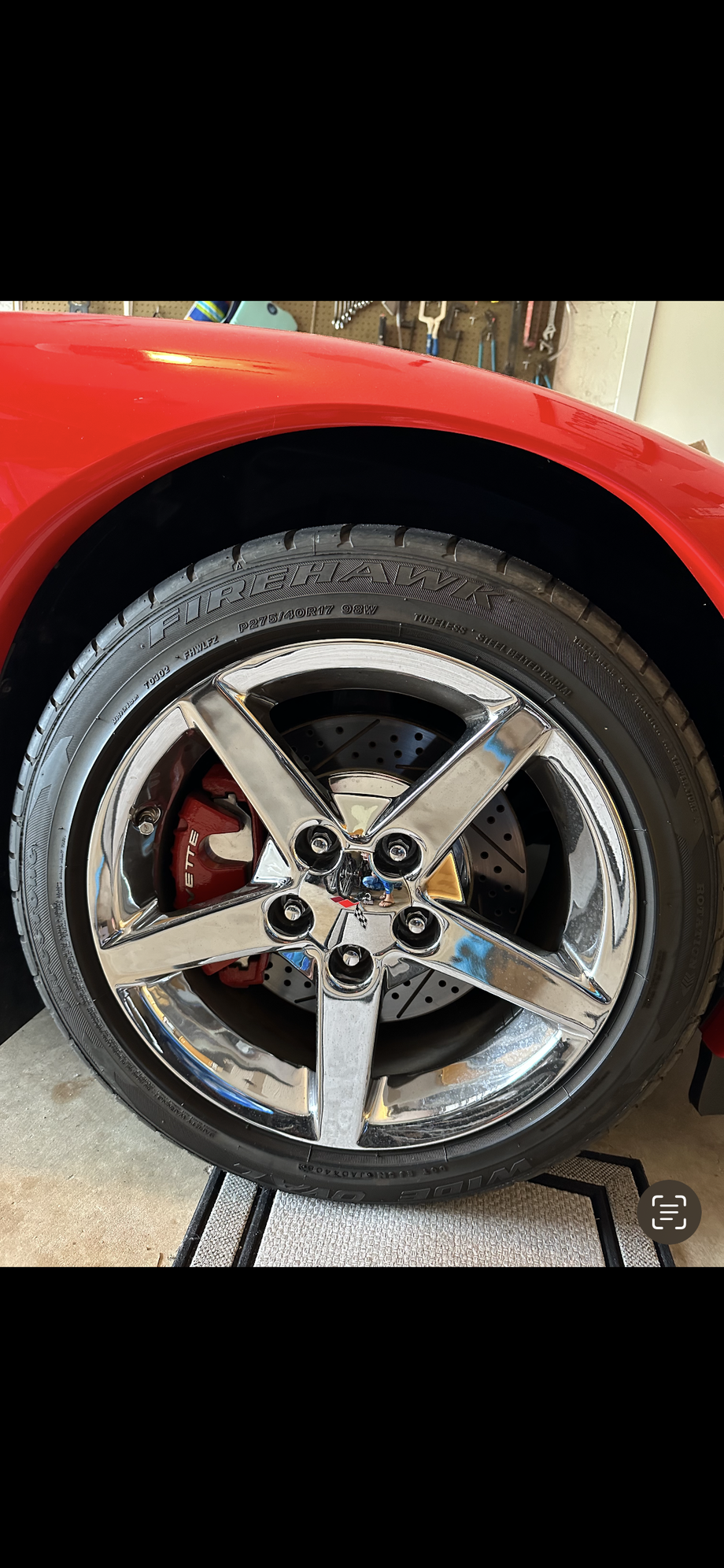

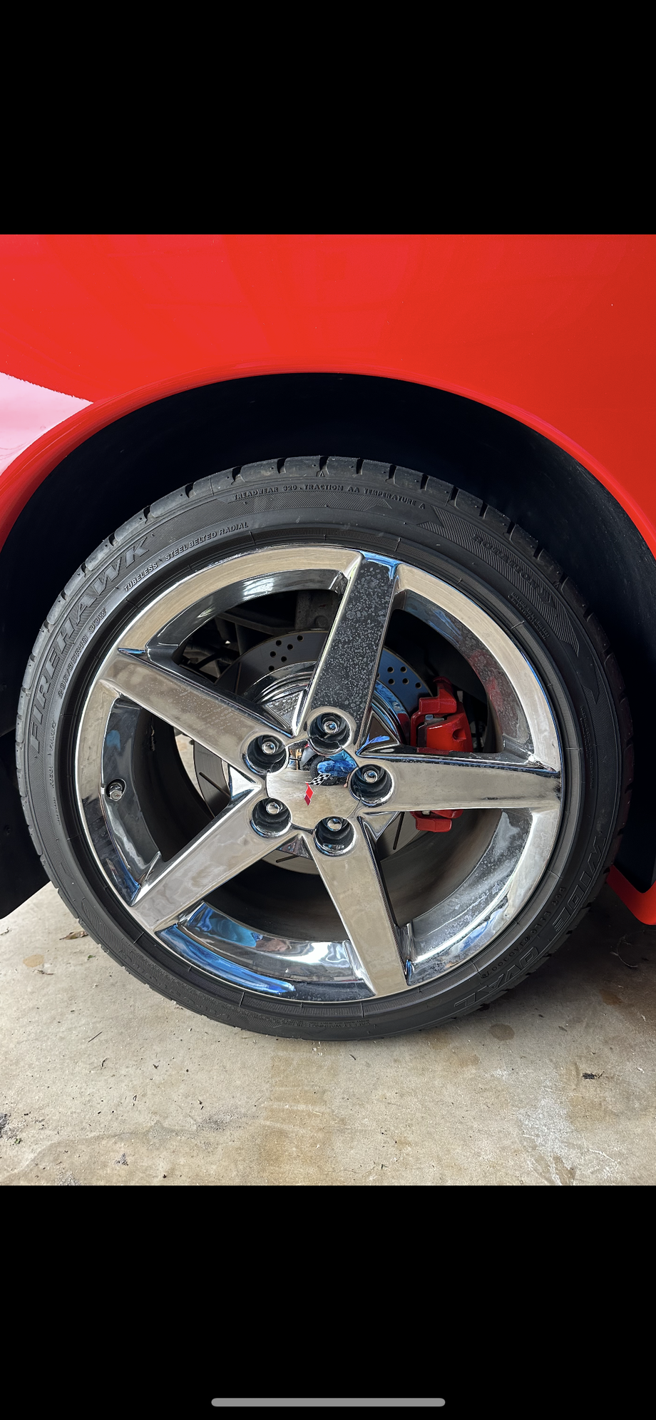

A good friend passed away a few years ago. His wife kept their ‘98 coupe and enjoys driving it occasionally. The tires are quite old (2007) and it’s time for replacement. I offered to help evaluate tire options, but the current tires are not OE sizes which makes things a little difficult.
Fronts are 275/40-17
Rears are 295/35-18
They are mounted on aftermarket 5 spoke rims and I have no idea what the widths are. I found just a few tire brands that offer both sizes.
So … a few questions: Are these sizes a typical ‘upgrade’ for the C5?
If not, what sizes are you running on stock diameter rims?
Should she ‘bite the bullet’ and upgrade to C6 size wheels and tires?
Constructive advice is appreciated.

jost6453: going to C6 or even C7 wheels is something to do, but that all depends upon her....it is her Corvette.
stock C6 tires are: 245/40-18 front, 285/35-19 rears.
These are also the same for a base C7 and those are the sizes I put onto my C5 with C7 wheels. I purchased General GMAX-RS tires, Summer tires, not for cold weather at all.
The wheel pictures above sure look like C6 style wheels, just chrome instead of paint or polished, so yeah, aftermarket.
Probably going to have to remove a front and a rear to get the wheel widths to know what to get though.
Rears are 295/35-18
I will try. Those sizes are close to the factory C5 Z06 sizes, which could be considered an upgrade on a base C5. Z06 wheels are 1” wider than the base car’s wheels. To me, those wheels look like C6 replicas in C5 diameters. The actual Z06 front size is 265/40-17, which are hard to find and 275/40-17’s are sometimes used instead. The rear tire size you list is the correct Z06 size.
Since she already owns these wheels and these tires seem to be working out, I see no reason to “upgrade” to C6 wheels. If anything, get correct base C5 wheels and then there are a lot of choices in the factory size. If she sticks with these wheels, consider changing the front size to 255/40-17. There may be more options.
