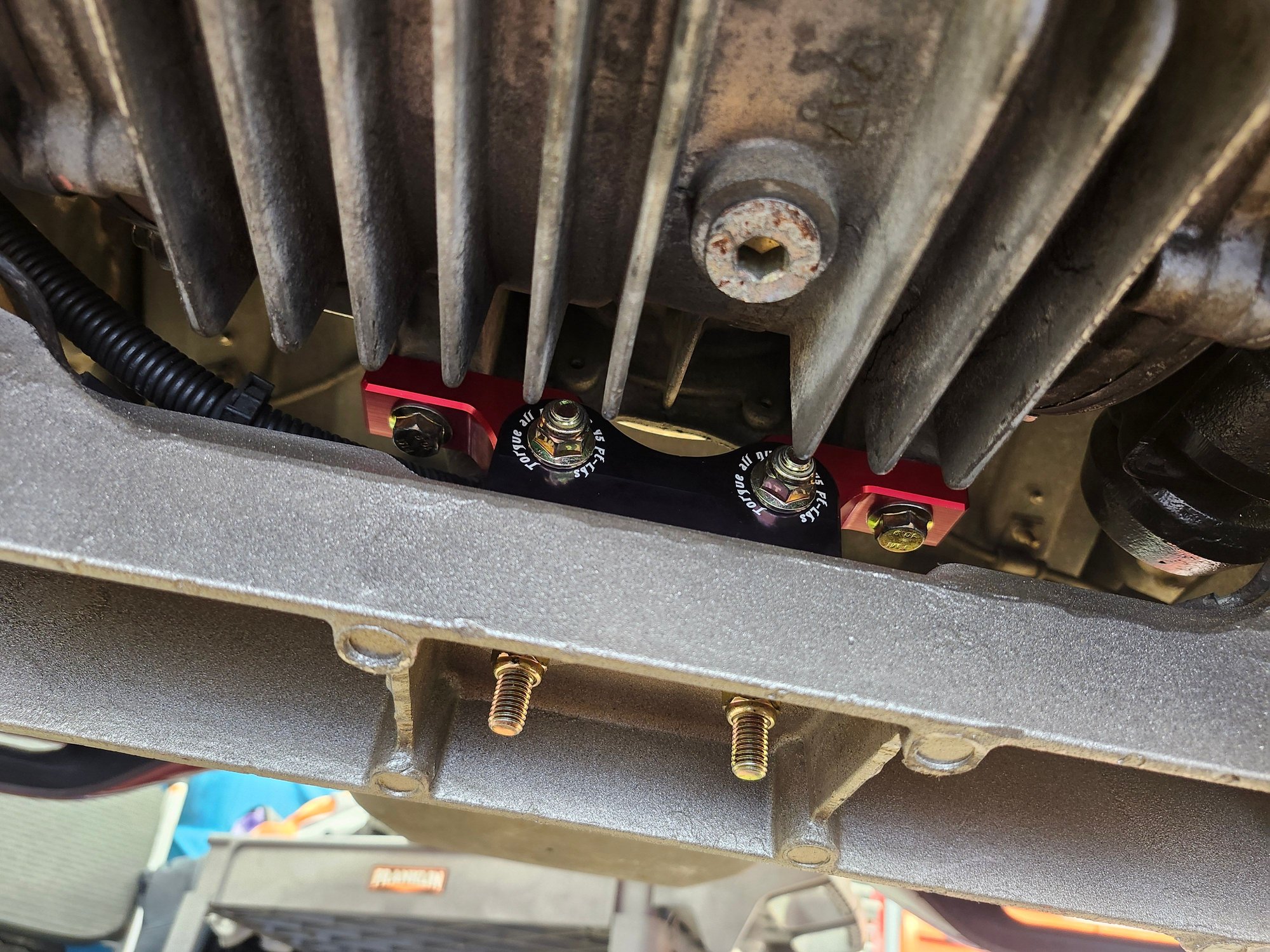

Just installed the HPI mount, defiantly not a plug and play install.
* Re-machined the counter bores to a larger diameter so you are able to get a socket on the bolt head.
* Had to modify the bracket to so the damper was able to be reinstalled.

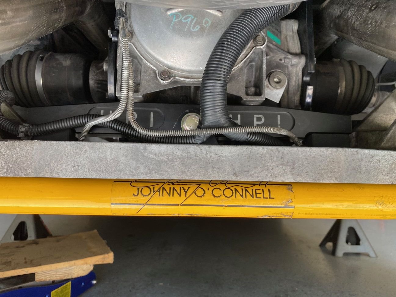

This is what i did to the mounting bracket to make the two part coexist.

That's kind of what I was thinking was going to have to be done to the bracket to make it work but I couldn't see well enough to confidently determine that was the case. Very happy to see other's solutions to this because the positives of the brace really are a lot to ignore. Did either of you (or anyone that's managed to make the brace and damper coexist) notice a significant change/reversal of the extreme vibration when you got the damper refitted?

I installed my HPI brace in 2020 at the same time I fixed my driver's side leaking differential seal and also installed a transmission brace while I had everything apart. I removed the damper at the same time. Not sure if the transmission brace is the key, but I have ZERO NVH with the missing damper. No wheel hop, no slop in the driveline, no noise/vibration. It is perfection! The transmission brace is a royal PITA to install with the transmission and diff in the car, but it can be done!
