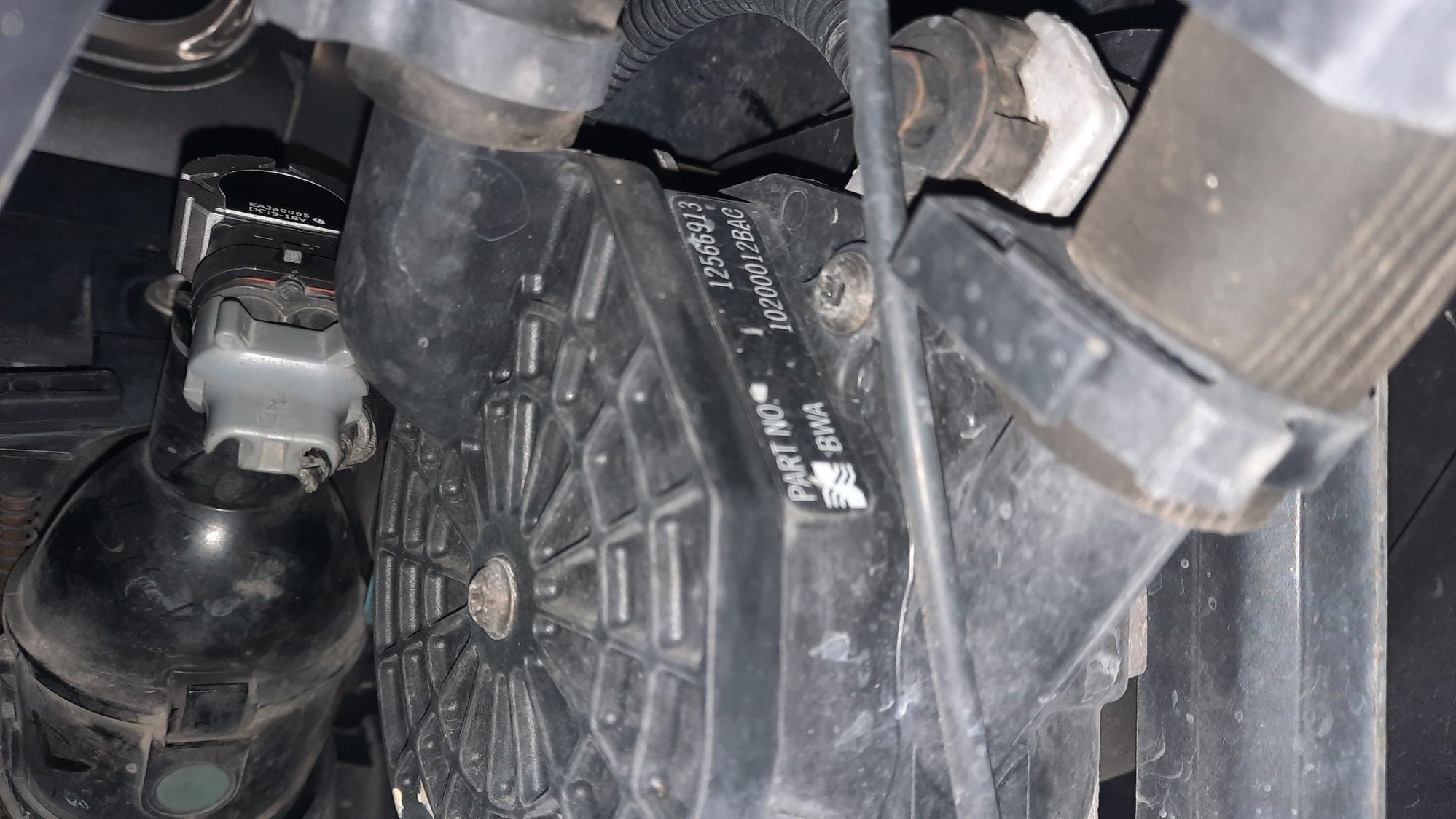

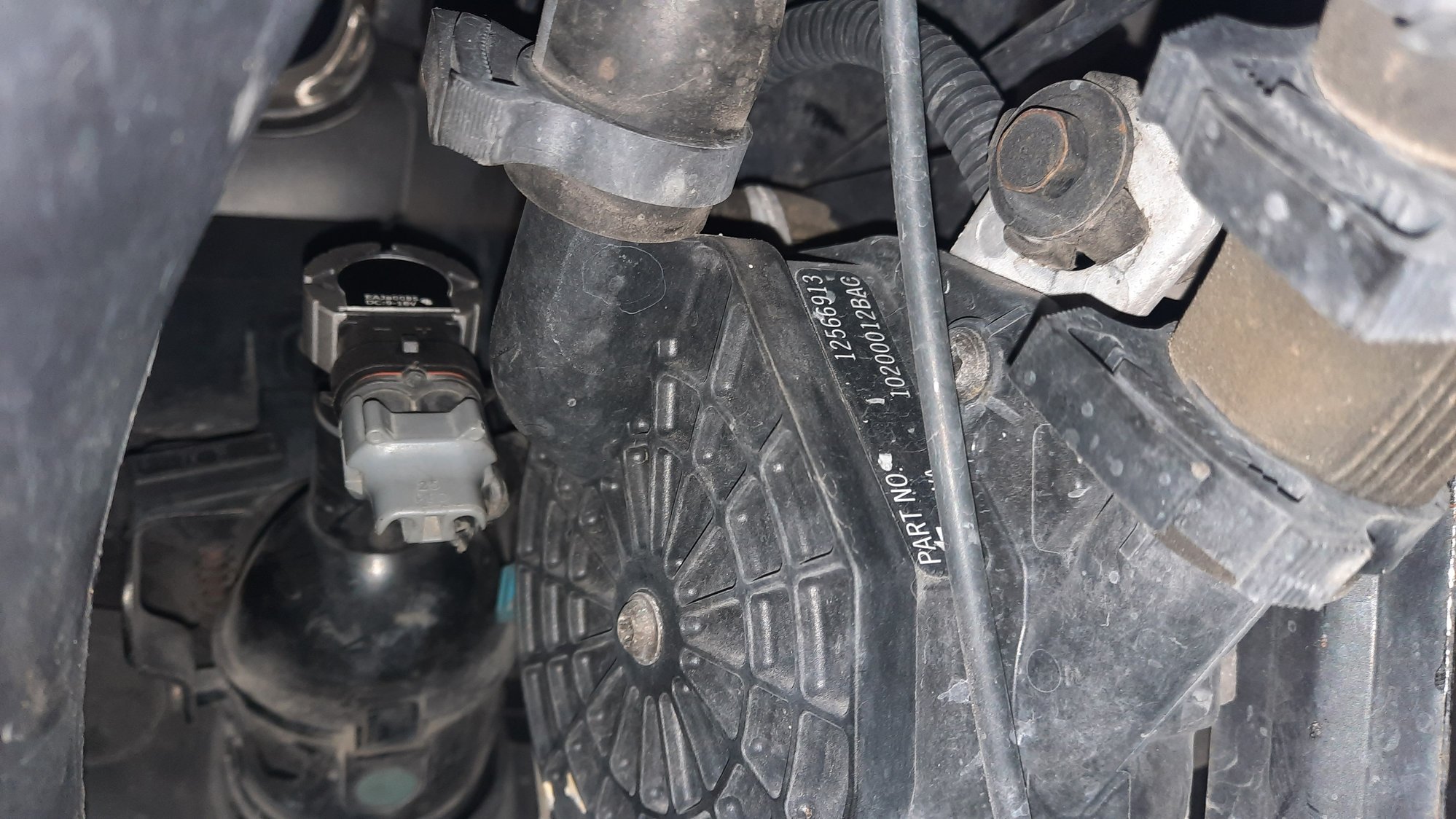

Had the vette on the lift yesterday doing an oil change and figured while I was at it, I'd pull the bottom cover under the driver's side fog light and get a view from the bottom. I could plainly see the elec connector was touching the air pump exhaust port. Got my big long screwdriver/prybar in there and bent the air pump bracket so pump didn't touch the fog light connector. Projected pattern was still rotated clockwise. Rotated the bulb itself but projected light pattern didn't move.
Then I noticed that when I had previously loosened the fog light assy to get the connector on, the entire fog light assy wasn't level after tightening it. Loosened the 10mm bolt that holds the fog light assy and moved the bottom towards the pass side. This leveled-out the projected light pattern but the elec connector was again up against the air pump. Got the screwdriver/prybar back out and tweaked the air pump bracket a little more. Now it's all good. Love the LED look. Huge difference from stock fog light bulbs.
Before tweak
After 1st tweak. (Fog light still not positioned correctly as witnessed by gap on right side)

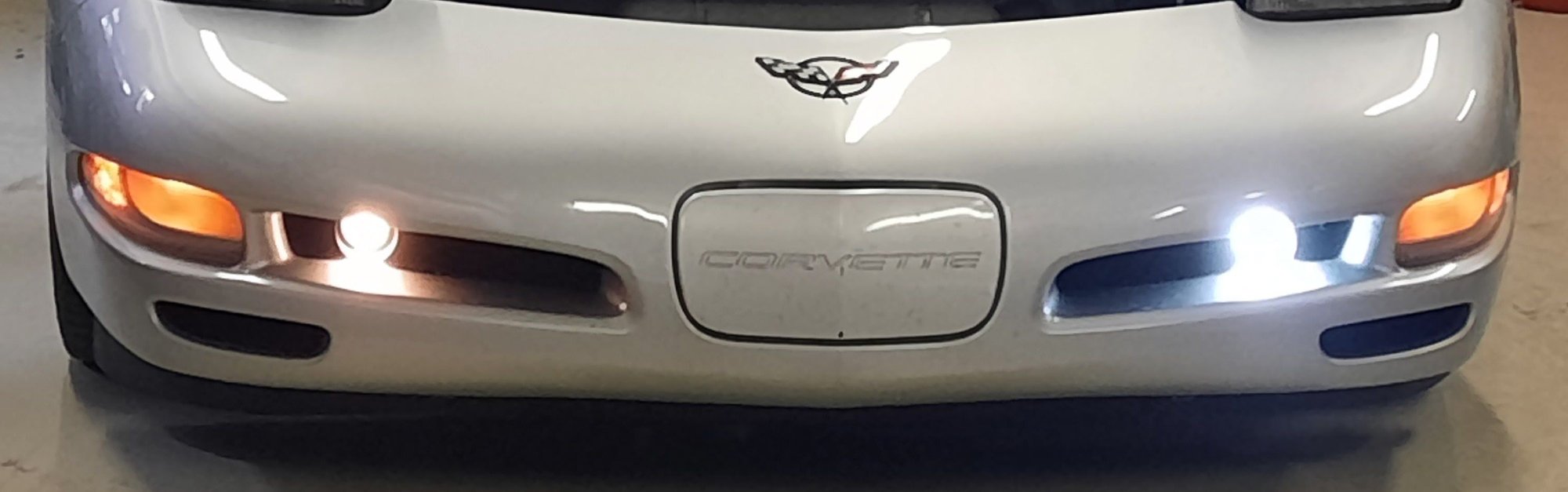

Old VS new.

Glad you were able to tweak the bracket on the air pump to get the fog light to project a proper pattern. The new fog light does look a lot brighter than the stock light.
