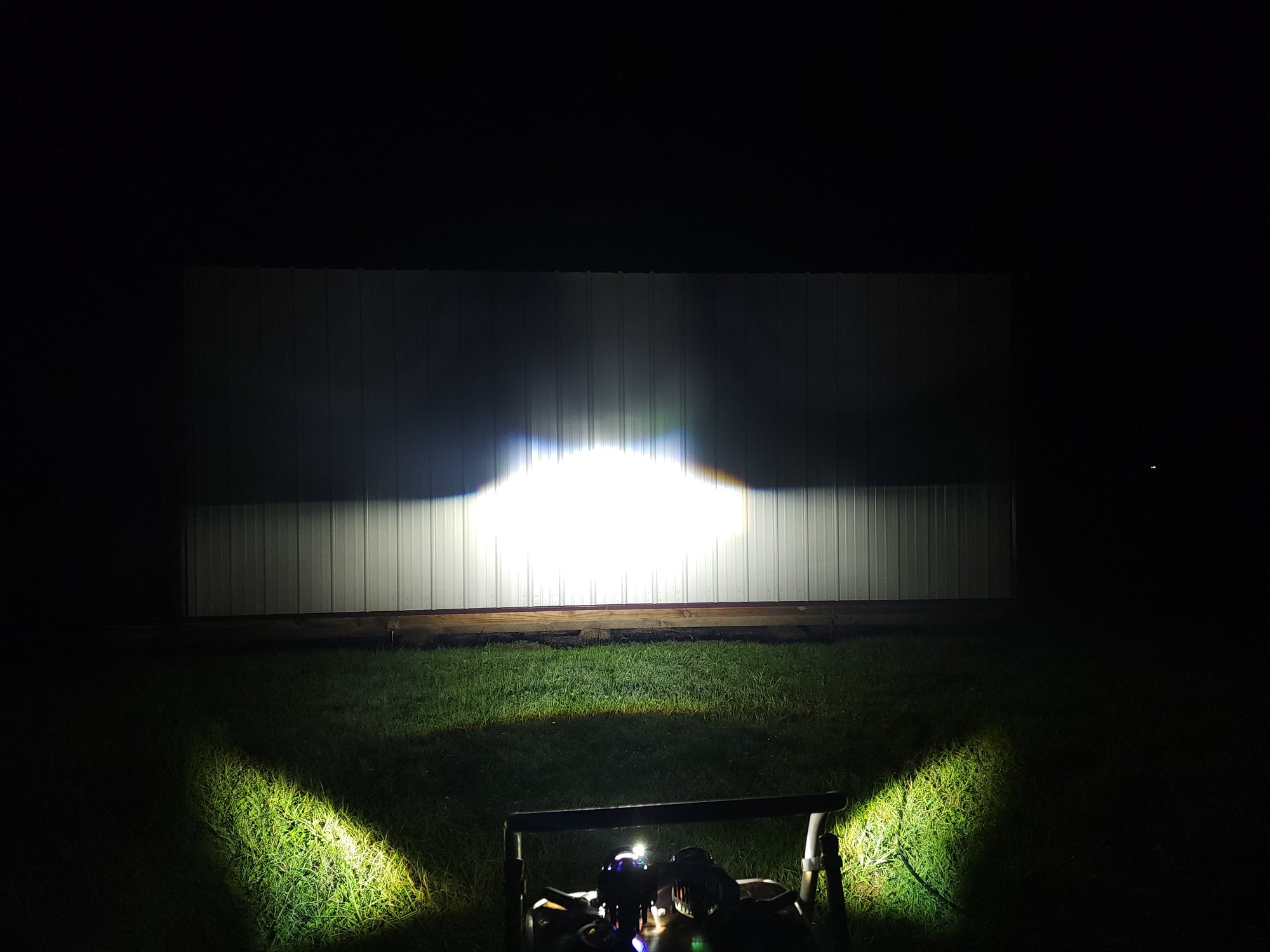

How much does the Nova Projector improve headlight performance?
Objective test: 15 feet from wall with Morimoto light meter. Measurements taken at Top Dead Center (TDC) and 30 degrees off-axis to left.
Photos: Taken with Samsung S22 Ultra in Manual mode with 1/60 speed, 320 ISO.

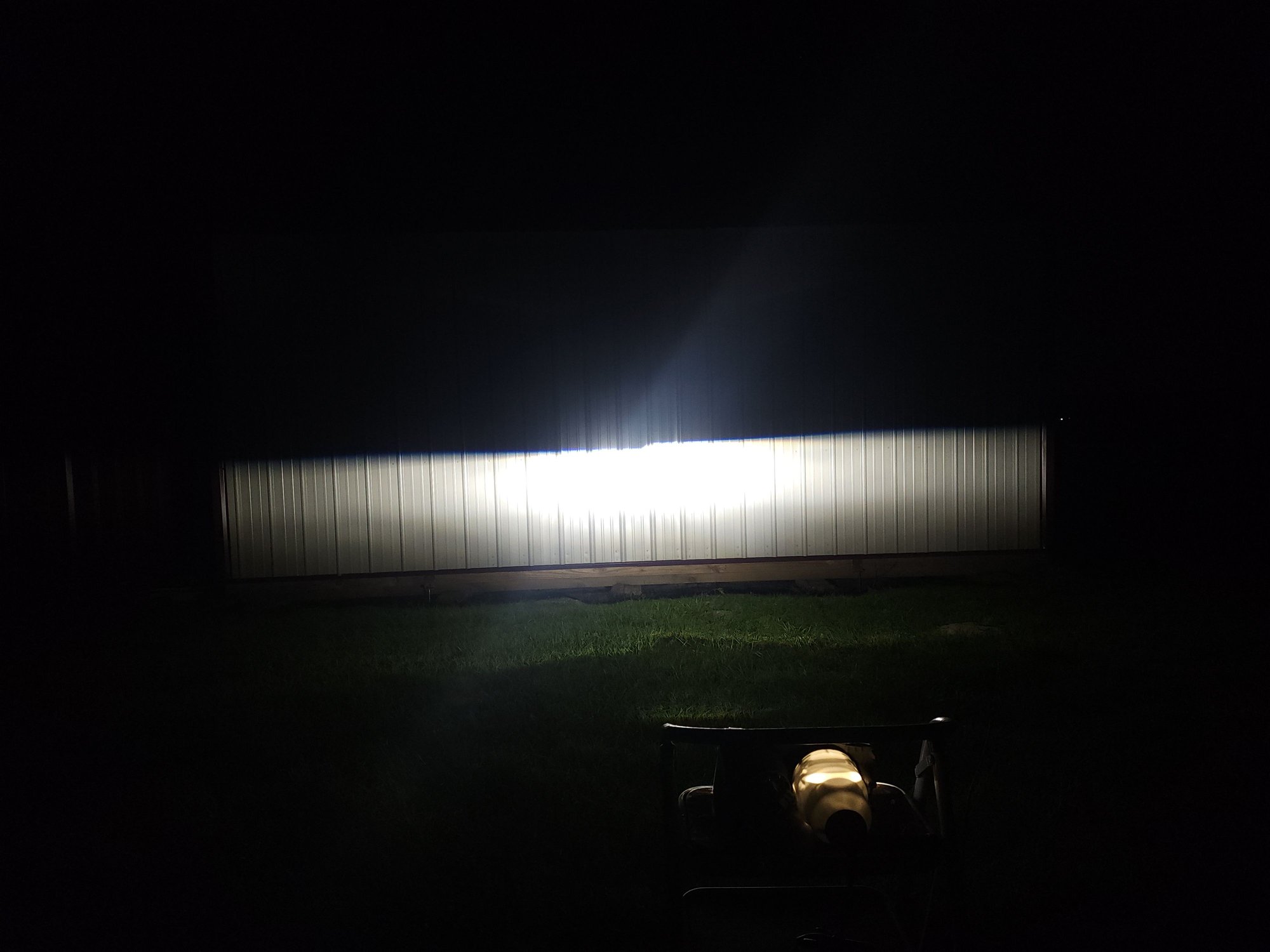

Bi-LED ACA (Current version)
Low beam:
TDC: 2200 Lux
30 degrees off-center: 33 Lux
Std ACA low
Std ACA low

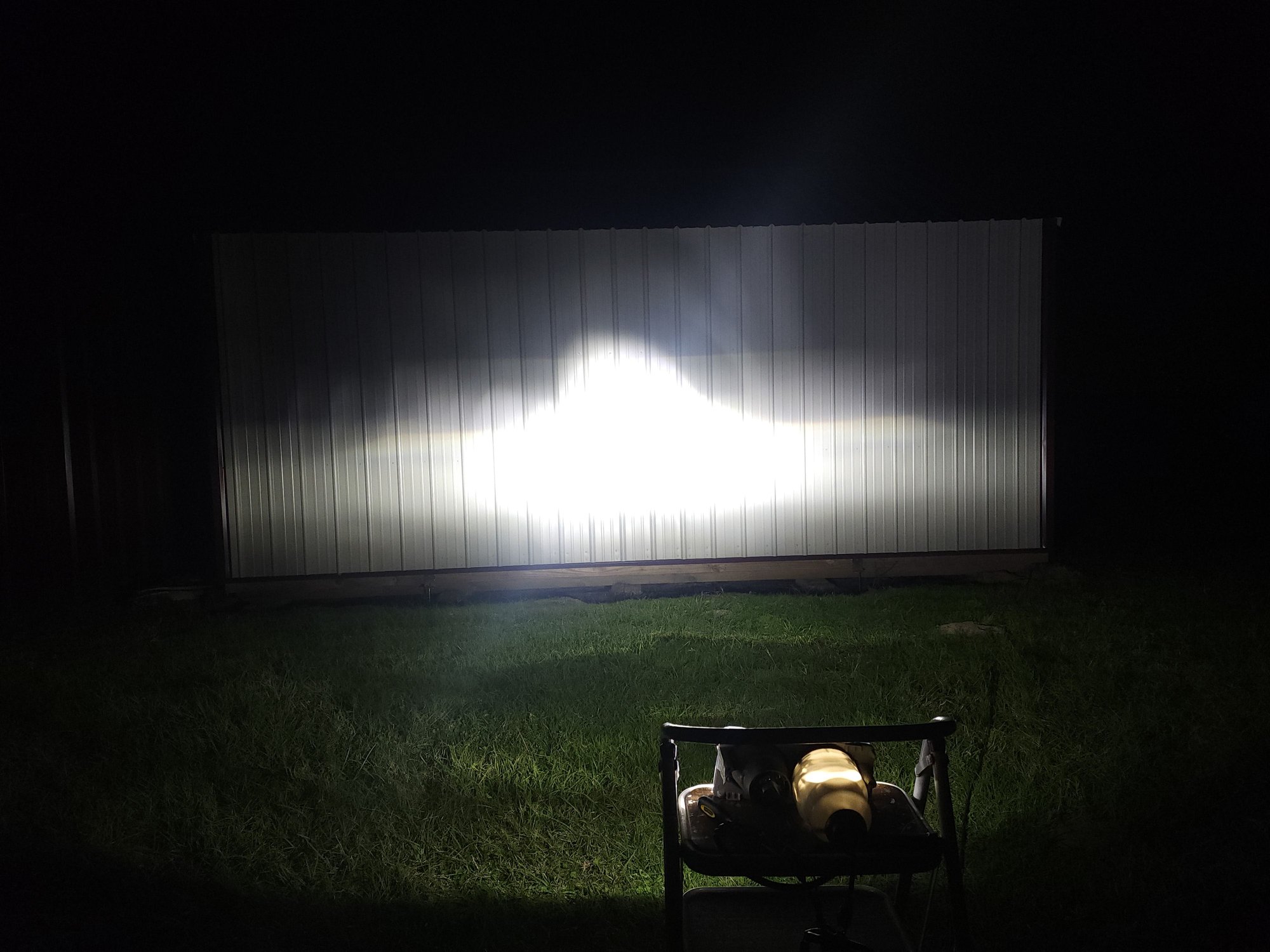

High beam:
TDC: 3200 Lux
30 degrees off-center: 53 Lux

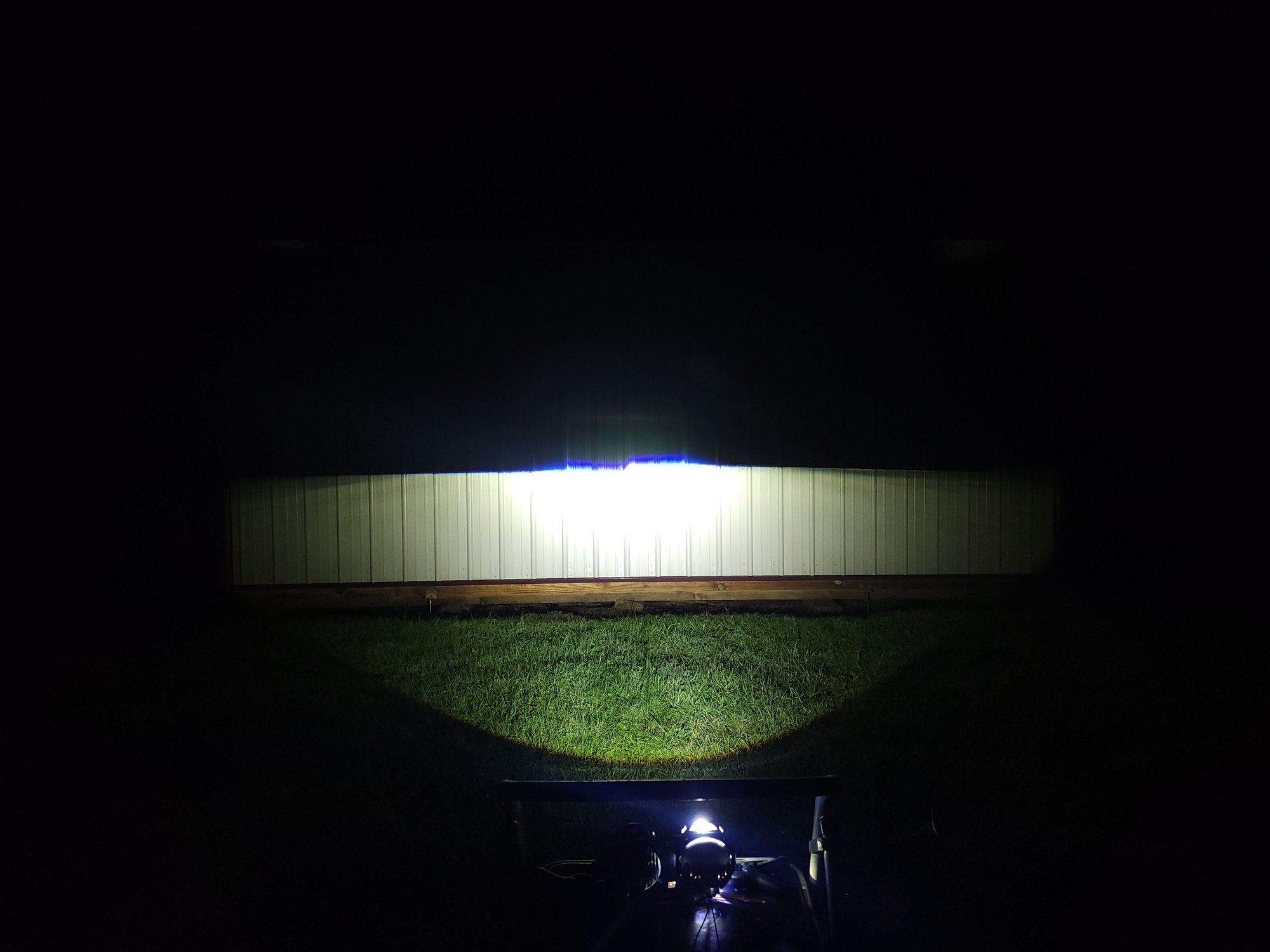

Nova Edition ACA Bi-LED projector
The Nova Projector installed in an ACA housing. The Nova projector is characterized by two lens
The Nova Projector installed in an ACA housing. The Nova projector is characterized by two lens "dimples" for the secondary high beam chips.
Low beam:
TDC: 3115 Lux (41.6% increase)
30 degrees off-center: 5.4 Lux

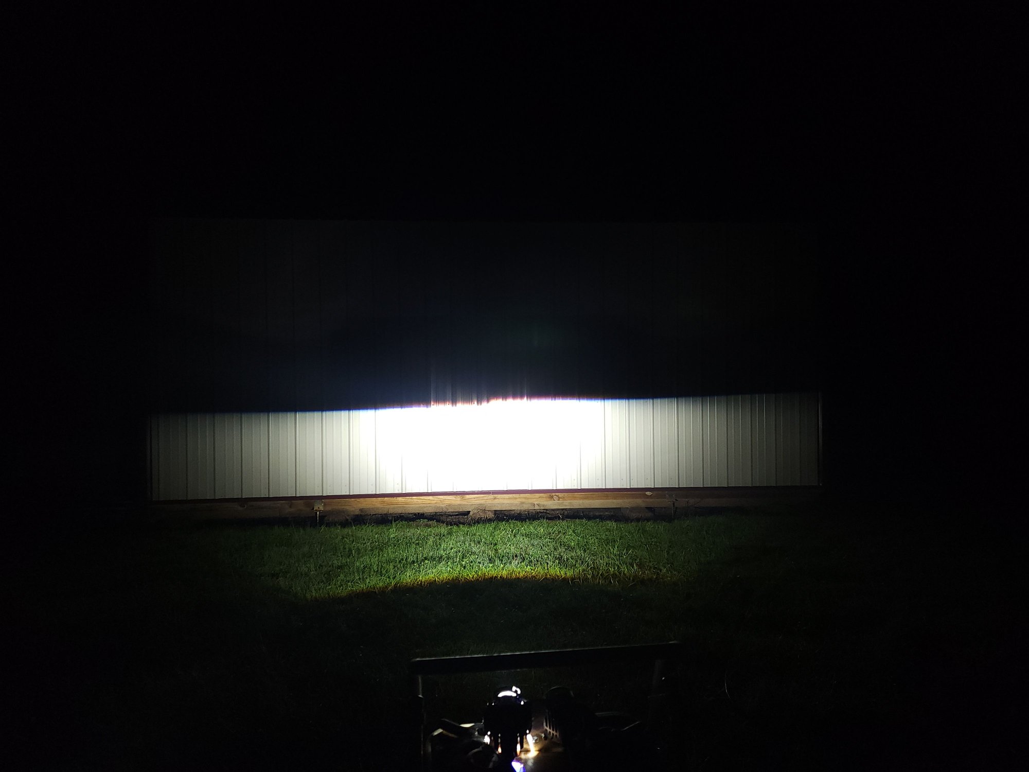

High beam:
TDC: 5000 Lux (56.25% increase)
30 degrees off-center: 10.6 Lux
Subjective notes (ACA system):
Nova Edition Low beam:
The hot spot of the Nova projector is about 30% larger with a more gradual transition to the pattern spread. This results in a uniform illumination of the road at any distance and a steady fade to maximum pattern width. A foreground limiter prevents excessive illumination of road surface close to the car allowing the driver to effectively see further down the road with minimal eye strain.
Nova Edition High beam:
Immensely powerful and tight pattern focuses on throw over flood providing highly effective long-range illumination. (Note: The “wings” in the edges of the foreground appear to be artifacts of the hyperboloid lenses and might provide illumination as “cornering” lights)
