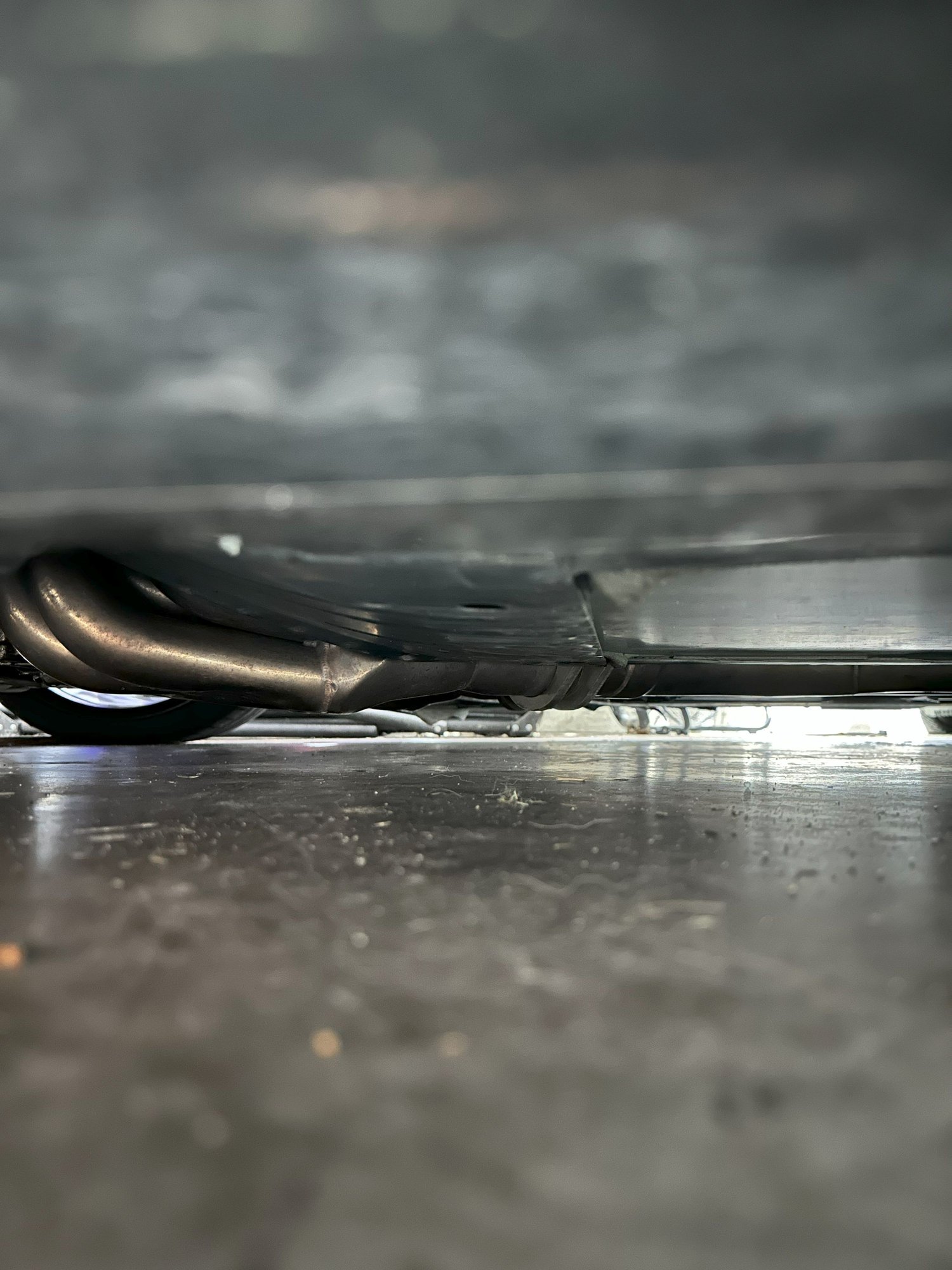

Finally had a free weekend to tackle the header swap, and then just finally found some free time to come back here and post an update. And thankfully... I can report that the job was a great success! The Speed Engineering headers are definitely an improvement for additional ground clearance over my old XS Power headers.

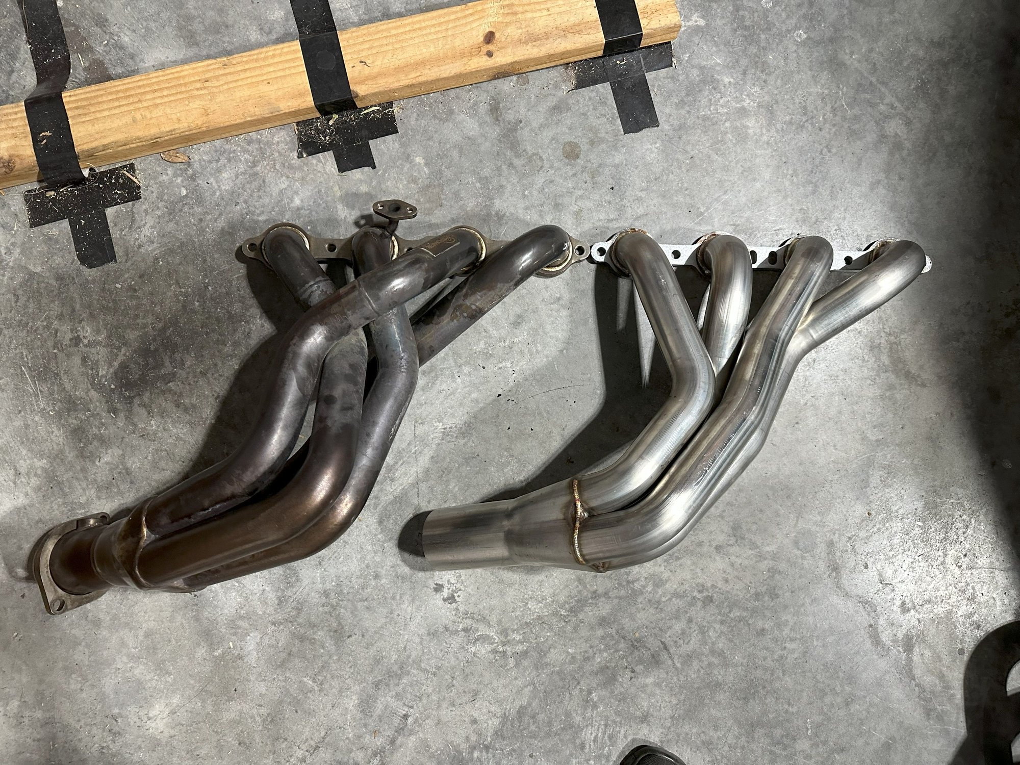

Even just with the flanges lined up in this side by side shot it's easy to see the old ones on the left are a smidge taller, and just overall bulkier in general. The old headers were a pain in the *** to get out, especially the passenger side, and the new ones went in absurdly easy. Here are a couple before/afters:
First is as good of a side angle comparison as I could get with both sets installed. XS Power first, Speed Engineering second.

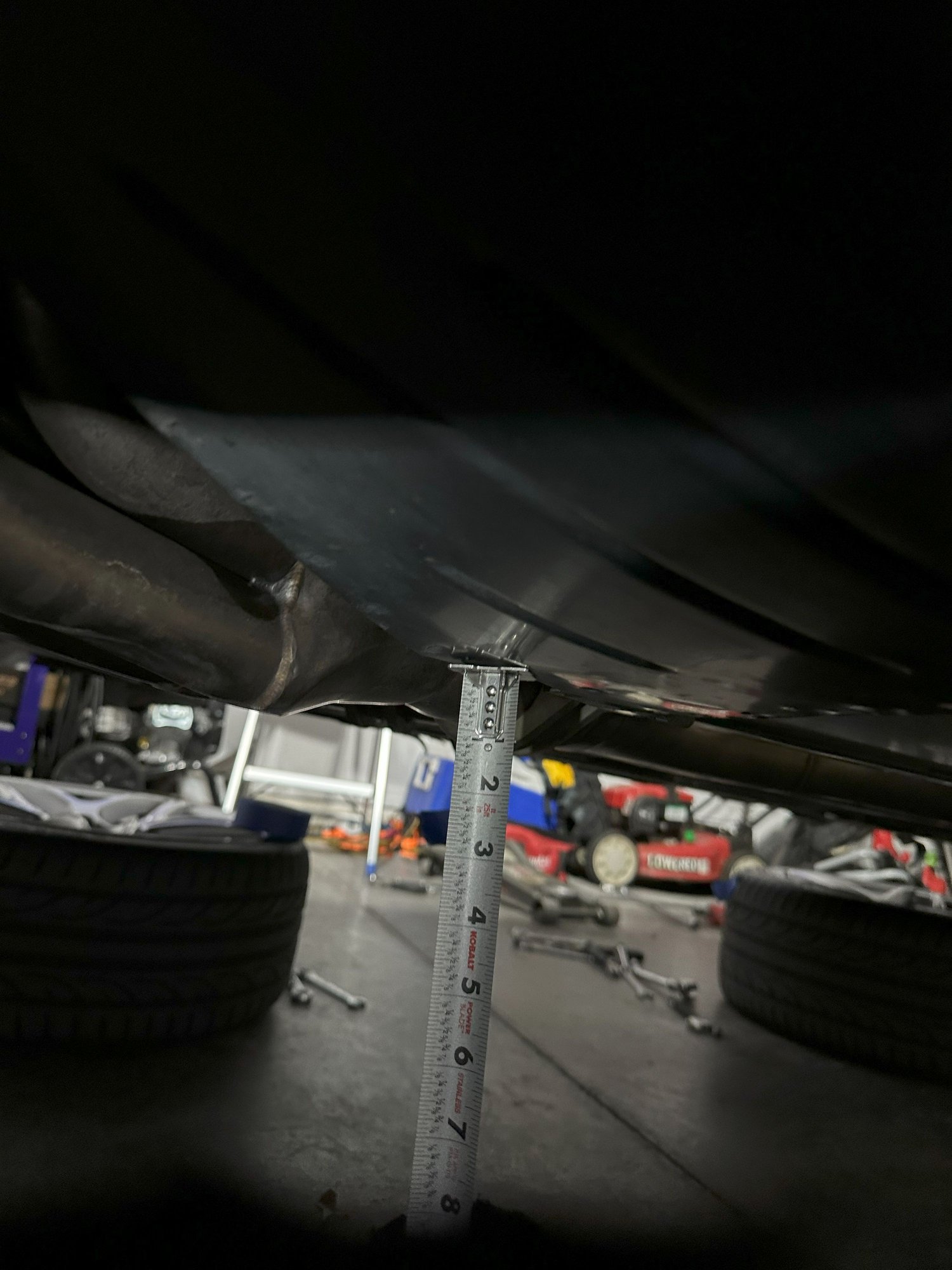

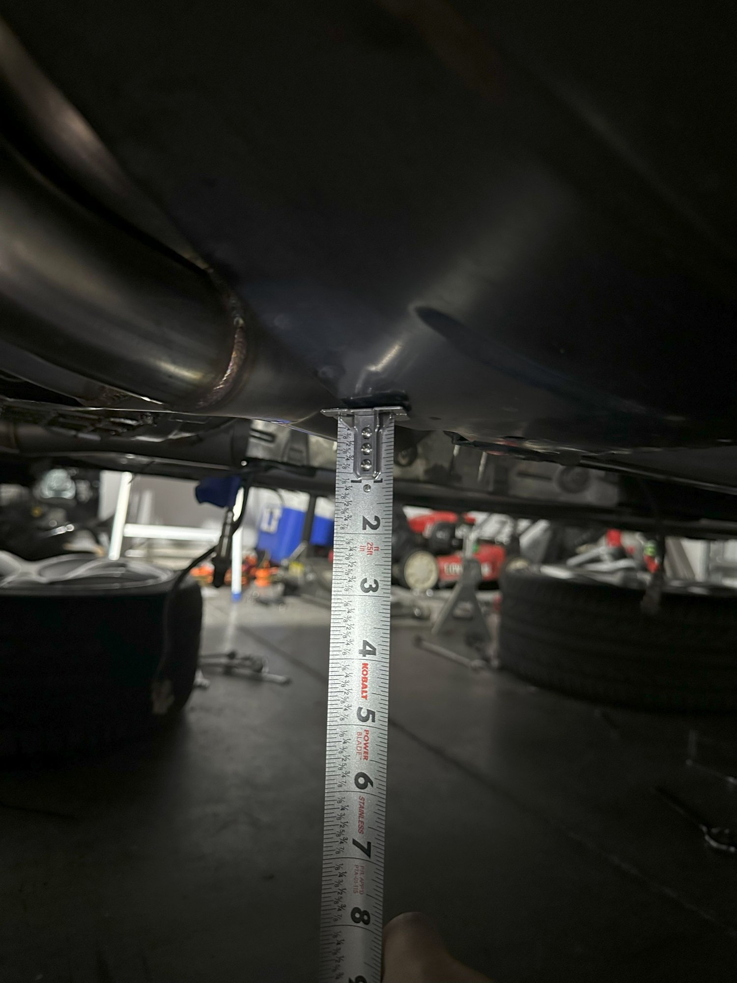

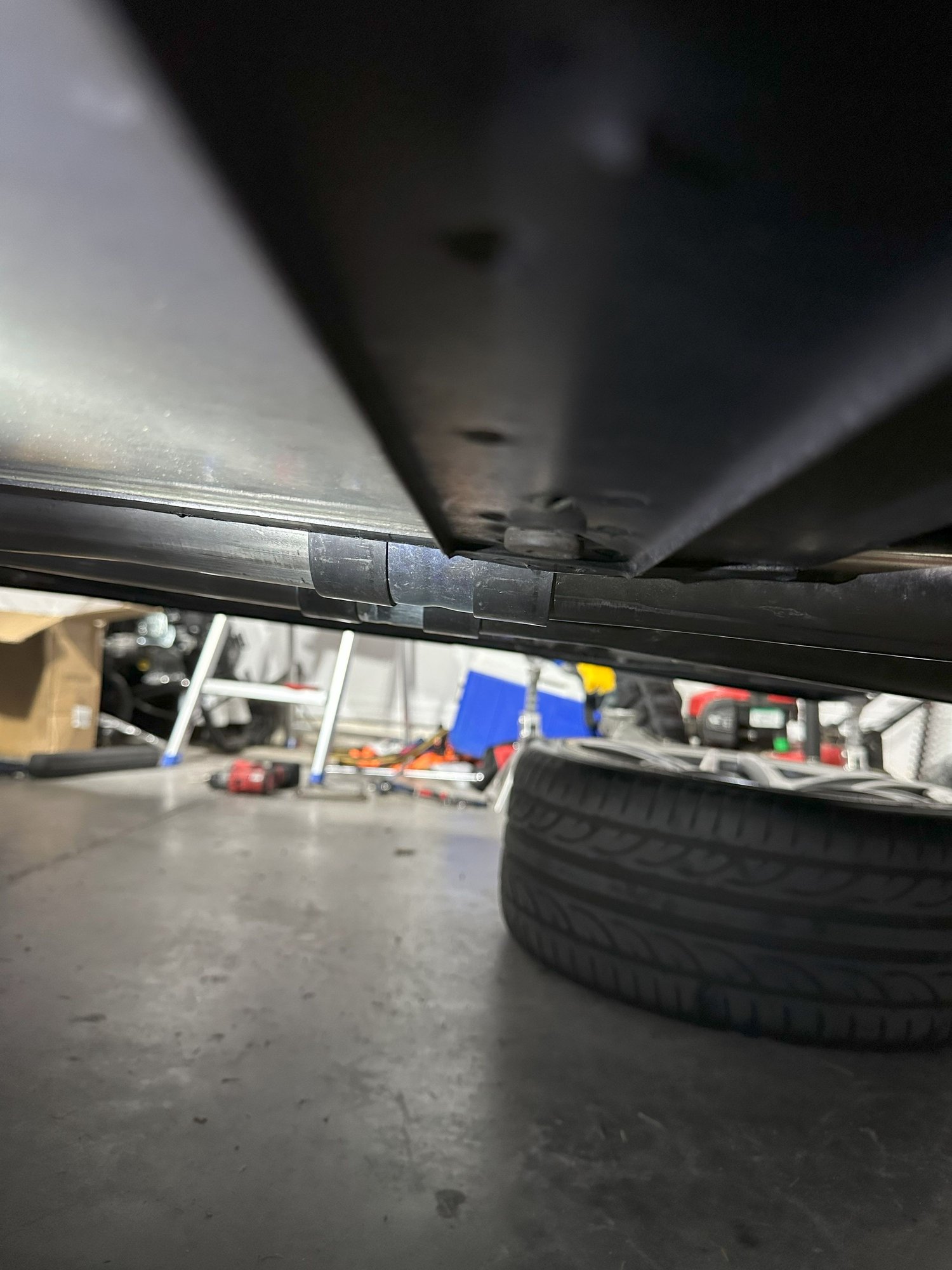

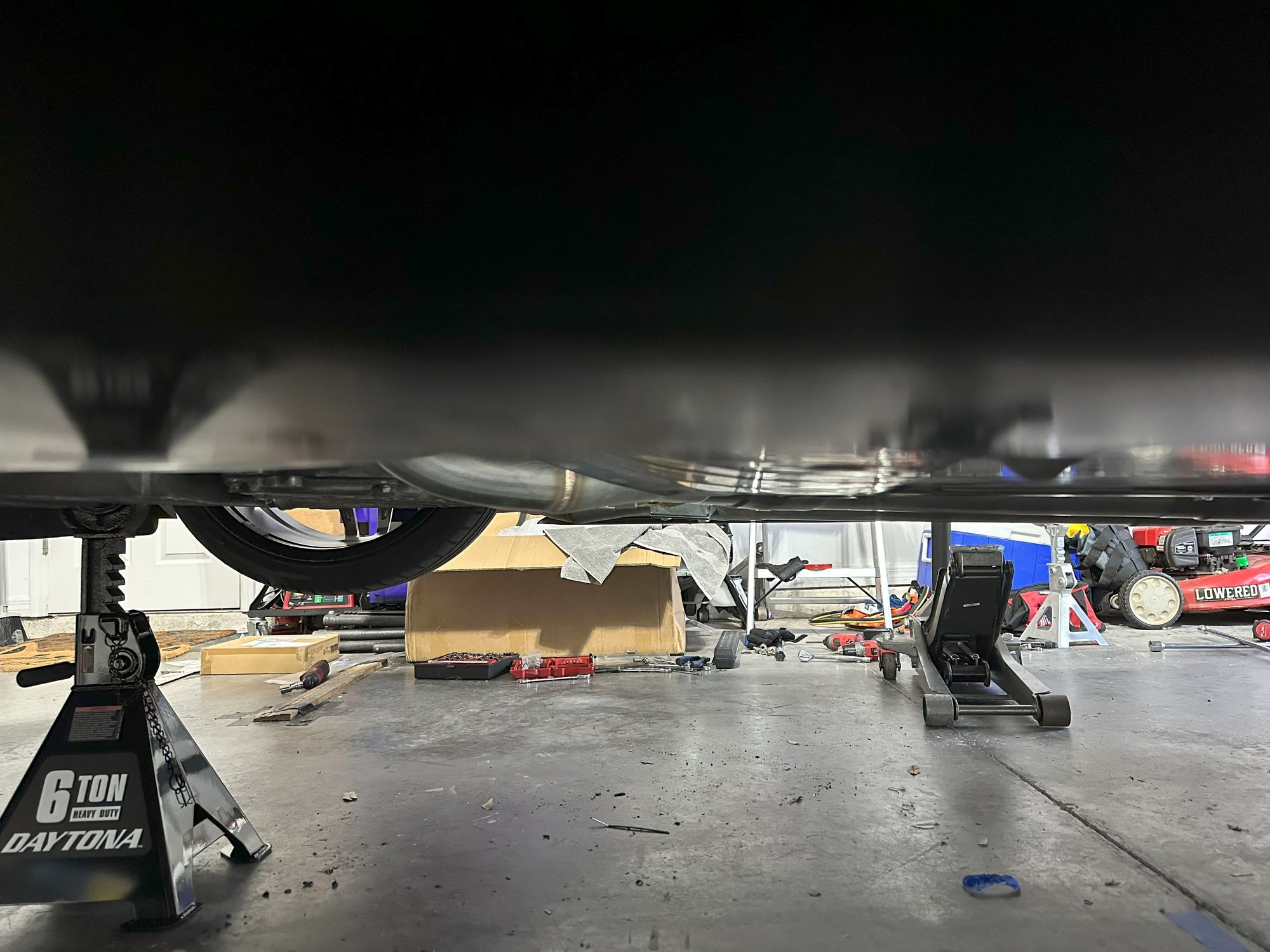

As you can see the SE headers aren't perfectly flush, but they do tuck up significantly better than the XS power set (goodness they were bulky). Here's a measurement comparison I tried to get while crawling around underneath the car, measuring from the same spot. XS Power hung roughly 1 1/8" below the floor pan, and the SE set hangs roughly 3/8" lower.

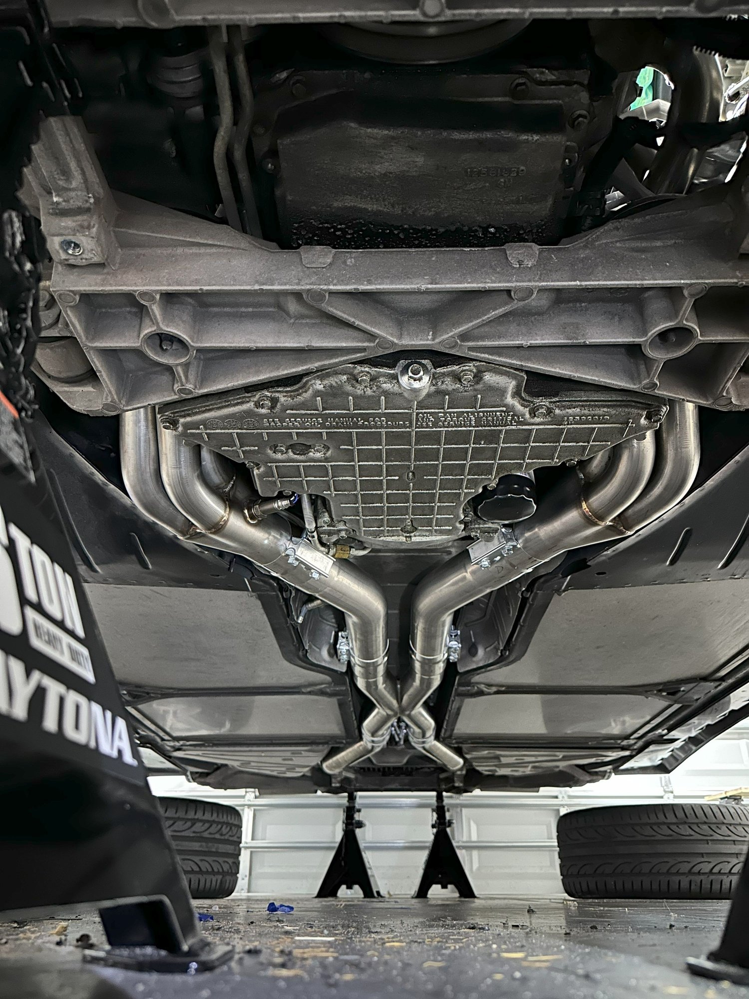

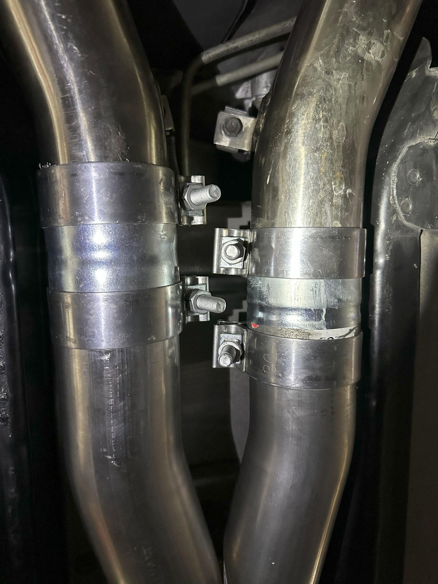

I used some 3" stainless lap joint clamps on the header to x-pipe connections which were great. And instead of sourcing a stock h-pipe to cut a section off of to fill the gap between the end of the new x-pipe and the over-axle pipe (as SE suggests to do), I just did something similar with some 3" ID - 3" ID sections of pipe to mate this with my existing 3" over axle pipes. I cut them staggered as well, so that the bolts for the clamps would all sit side by side and not have to hang lower. Which of course, would defeat the whole purpose of this ordeal if the clamps hung down further than the exhaust. After several drives I don't have any leaks, but I plan to just get this section welded up in the future. 1st pic is everything installed, 2nd is my pipe solution before the axles, and 3rd is a side view of that section.

After getting the car back on the ground and making some minor adjustments to the bags, pressures etc., not only I was able to air out about 1/4" lower, but I was very relieved to see that the headers do not touch the ground anymore. Success!
