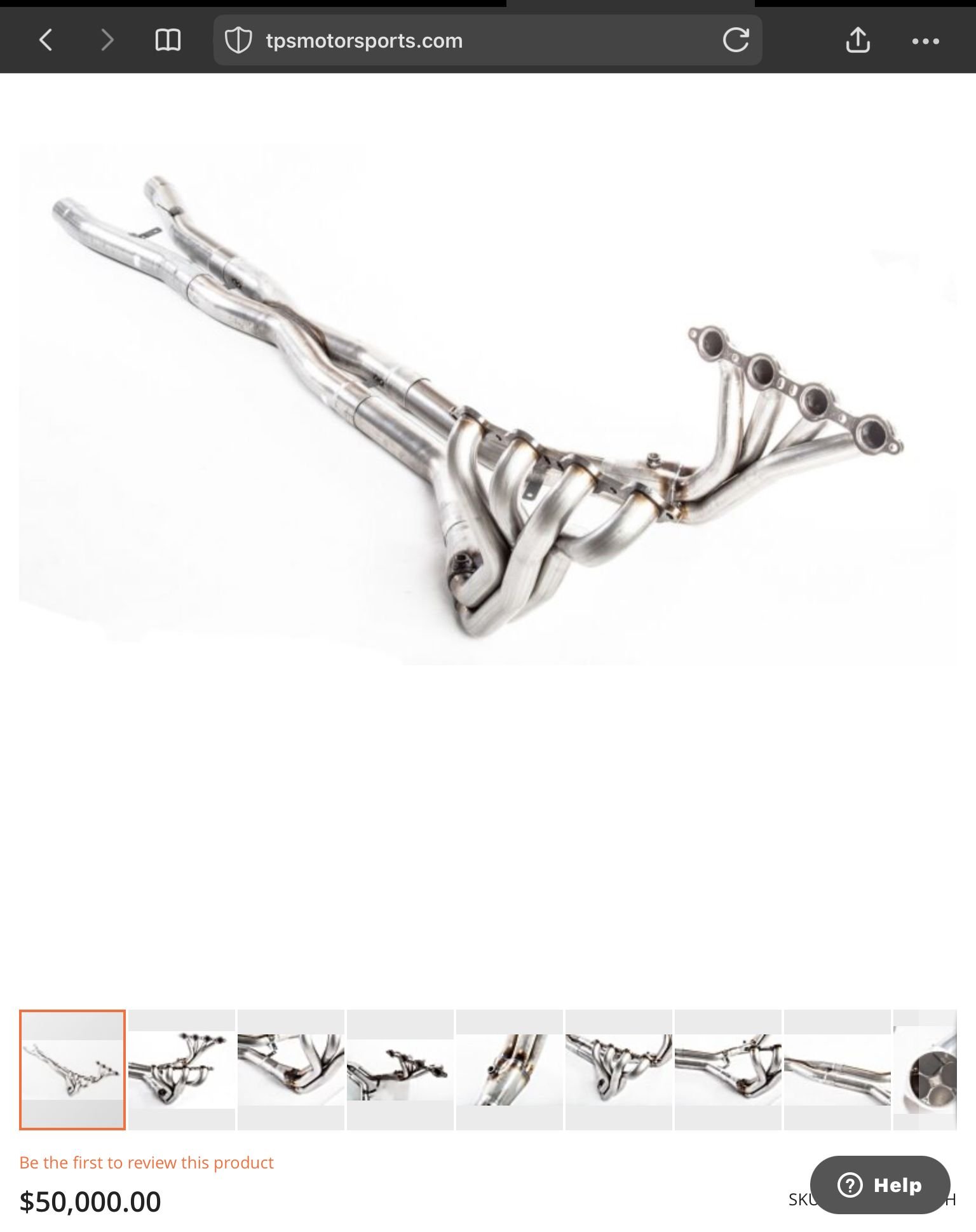

I went with TPS Motorsports headers (not Texas Speed, aka TSP). I've heard some forum members speak poorly of this company, but personally I had a very positive experience.all the way around , so I'm not sure why others may have had issues. Fitment was perfect, no issues with clearance anywhere. 1/2 the cost of ARH or Kooks. Been running them for 3 or so years now, no issues. Love the sound and added power. I also did a tune at the same time. Good luck with whatever you decide on, I'm sure you'll enjoy the end result.

Originally Posted by Mr. Marbles
I went with TPS Motorsports headers (not Texas Speed, aka TSP). I've heard some forum members speak poorly of this company, but personally I had a very positive experience.all the way around , so I'm not sure why others may have had issues. Fitment was perfect, no issues with clearance anywhere. 1/2 the cost of ARH or Kooks. Been running them for 3 or so years now, no issues. Love the sound and added power. I also did a time at the same time. Good luck with whatever you decide on, I'm sure you'll enjoy the end result.
$50,000…I don’t know man. Sounds out of reach.
