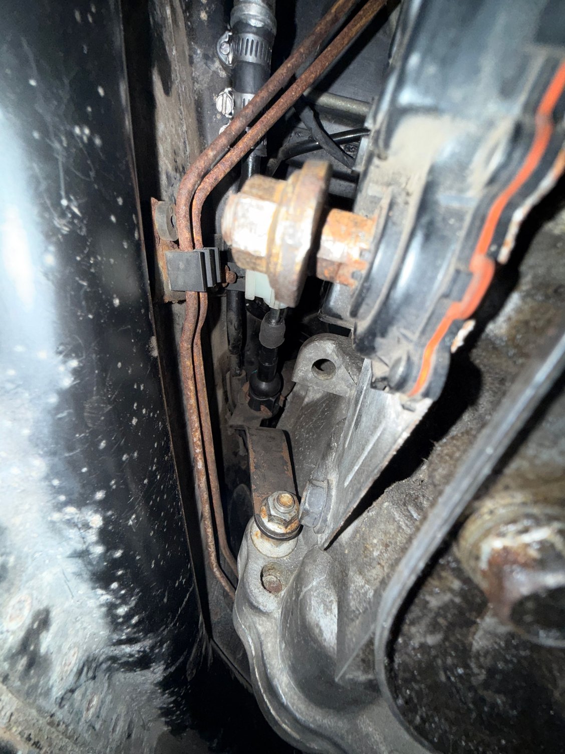

I have an automatic transmission on a 2000 c5 corvette. My auto shifter wont physically move all the way back to first gear shift selector but stops at 2nd. As if the cable is pulled too tense or something. Removing the console and slightly lifting up the whole shifter i can shift it back into first meaning my shifter mechanism isn't the problem. By lifting the shifter up i gave the cable more room to pull back but it won't do the same when the shifter is fully seated. I changed out the cable thinking it was an aftermarket one and is too short or something but that wasn't the case. The new cable still yeilds the same results and can't seem to figure out why it's causing my problems. I know the cable needs to go straight between the shifter and gear selector but seems to be directed upwards into the drive tunnel View of gear selector.

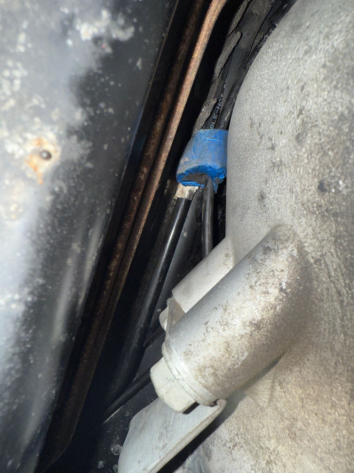

Blue tape around the cable foam thing. Wants to curve up and under the drive shaft.
