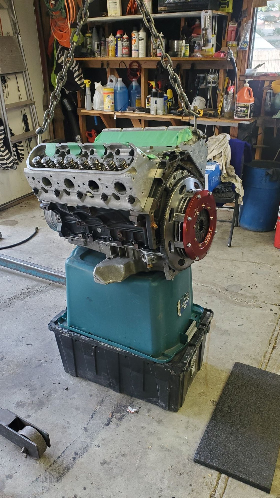

Like i said, i'm using all parts that came out of this engine to the new engine. Not touching or cleaning accessories.
Reusing the original stock crank from my 1999 this has 1000's of WOT, proved itself over and over why change, if it ate broke, This is my mentally with this build., stock rockers, stock 7.4 pushrods they have to be installed one way., Still going to use my stock Ls 7 lifters even though one is damaged. These were the good ones before all the fakes came out. Even though ones damaged, i do not trust any lifters made these days. All brands is a hit or miss. Not paying big money for junk.. Bought my ls7 from GM when they were $147 with tax. if i remember correctly.
Still going to use the F-1x but going to test the limits with maxing out boost. I was 32lbs but wanted to see what it will do beyond max, Per Procharge should not go past max impeller speed which is 72k and it will be unpredictable. All my blowers i pulled for max impeller speed. Why have a blower if you dont max it out. Don't get that but to each is owe. Well i had a pulley laying for at least 10yrs when i had my F-1c. So i said what hell lets see what will happen with 3.75 pulley compabled to my 4" so procharger calculation is 113k impeller speed that's pushing 41k over that threshold. ( : I cant tell how much boost i did. You guys going to have to help me there.

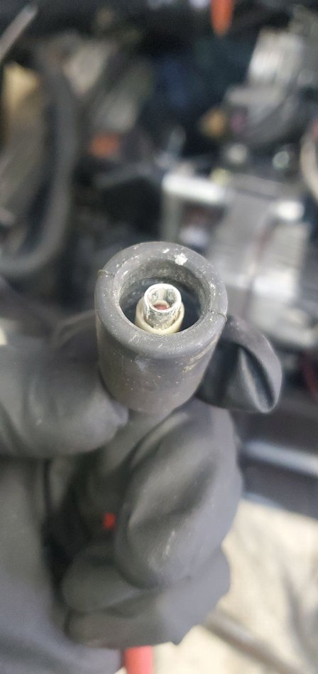

Iron 6.0 bored .030 over 10.25 cr
Stock wire plugs.
Stock ls2 intake and TB.

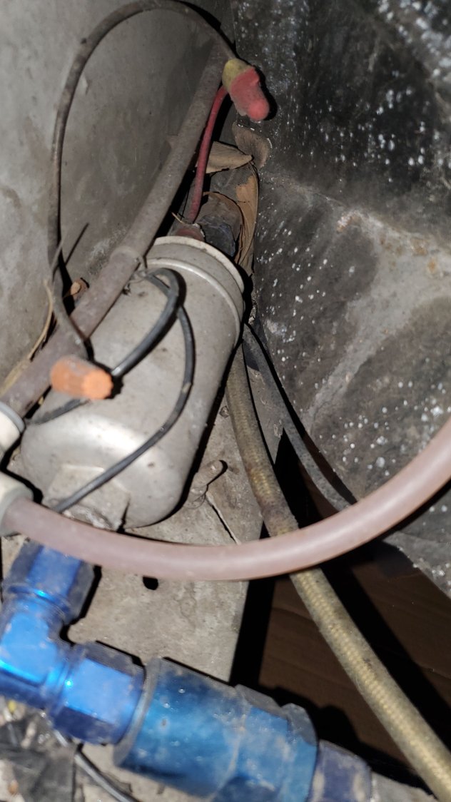

Still using my A&A external fuel pump set, I bought this when they first came out. Can't believe the pump still works.
still using my original Alky meth kit i installed 2010. I just rebuild it for the first time.
 Stock crank, not bad with only 4 oil changes seen 2004 after first build. somewhere around 90k miles. Machine shop couldnt believe it he said it didnt even need to be buffed but said go for it so you can say you buffed your crank.
Stock crank, not bad with a total of 8 oil changes seen since birth , somewhere around 150k ish miles. Machine shop couldn't believe it he said it didn't even need to be buffed but said go for it so you can say you buffed your crank.
I pasted on the buff when i saw this. LOL

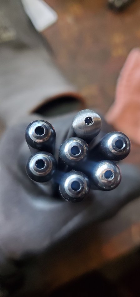

Special pushrods.
Special pushrods.

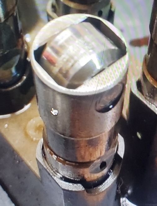

 Would you use this. rhetorical question.

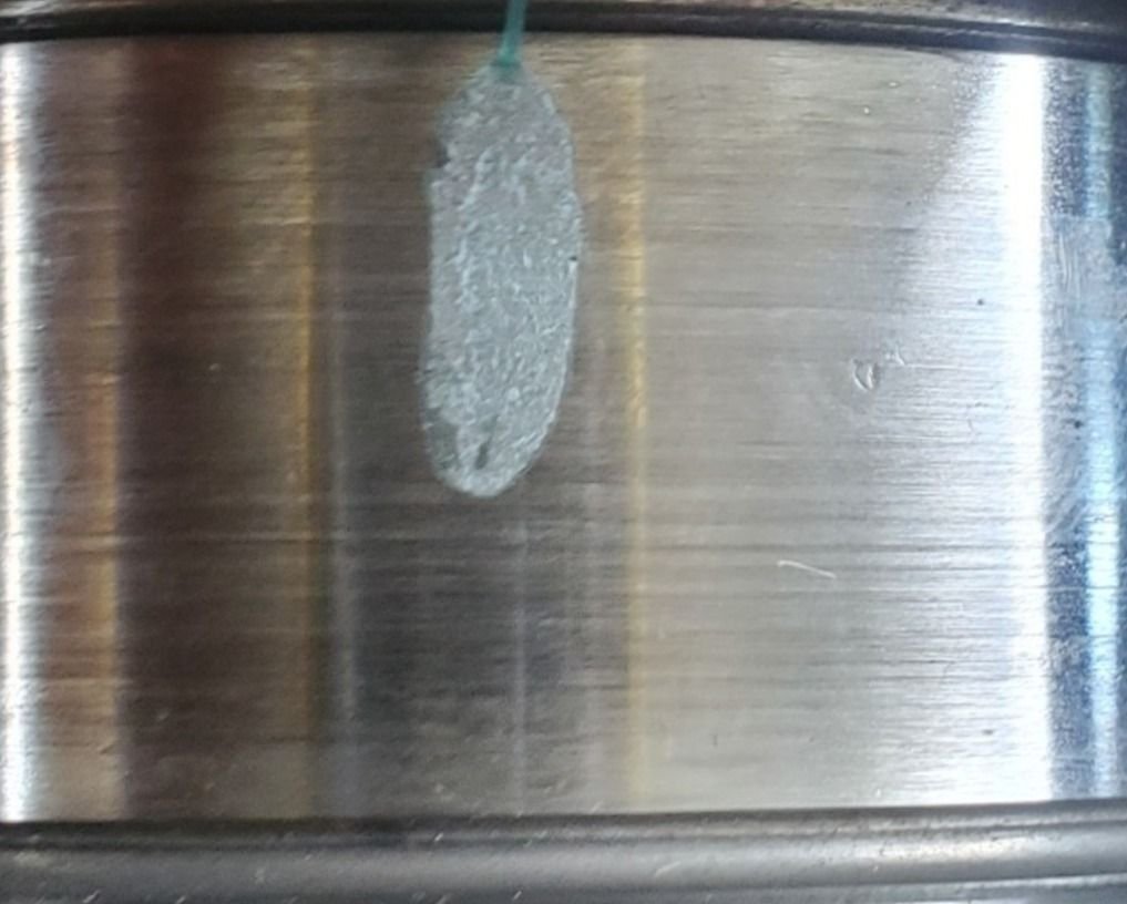

 And this is why. Didnt hear any unusual sounds. was pissed i was going to use the cam but i had to pass on this one.
And this is why. Didn't hear any unusual sounds. have no clue how this happen and did not destroy the lifter, but someone on here had the same issue with the cam with no ill effect. I was pissed i was going to use the cam, but i had to pass on this one.

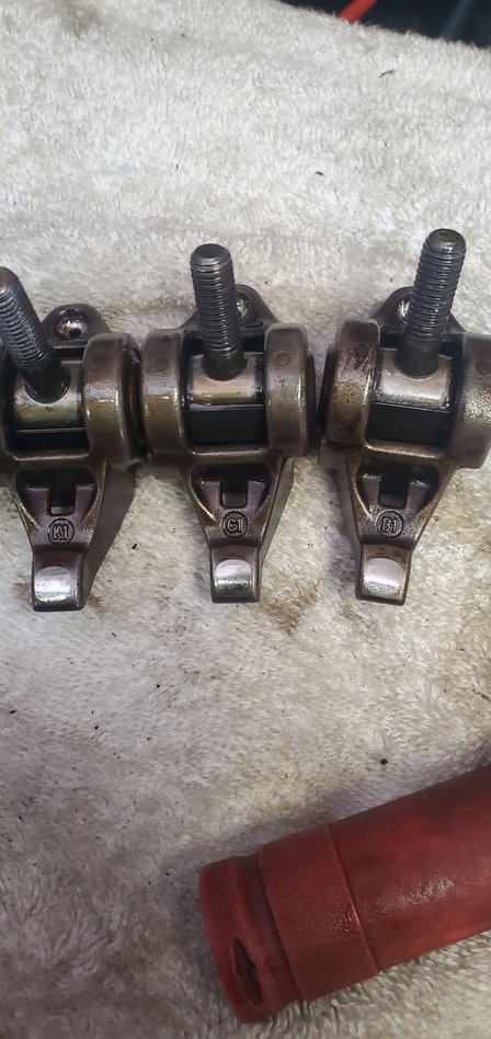

 Stock rockers,
Stock rockers,

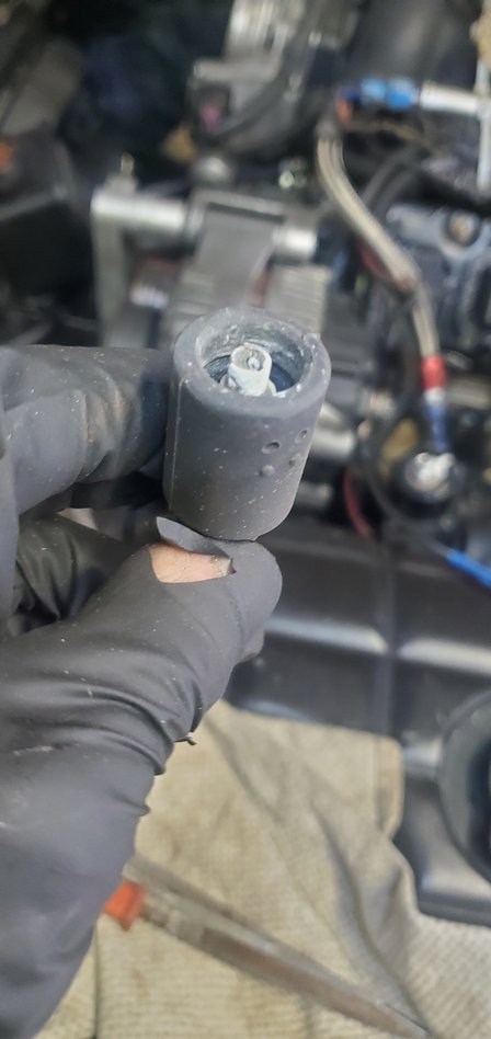

stock ls2
stock ls2

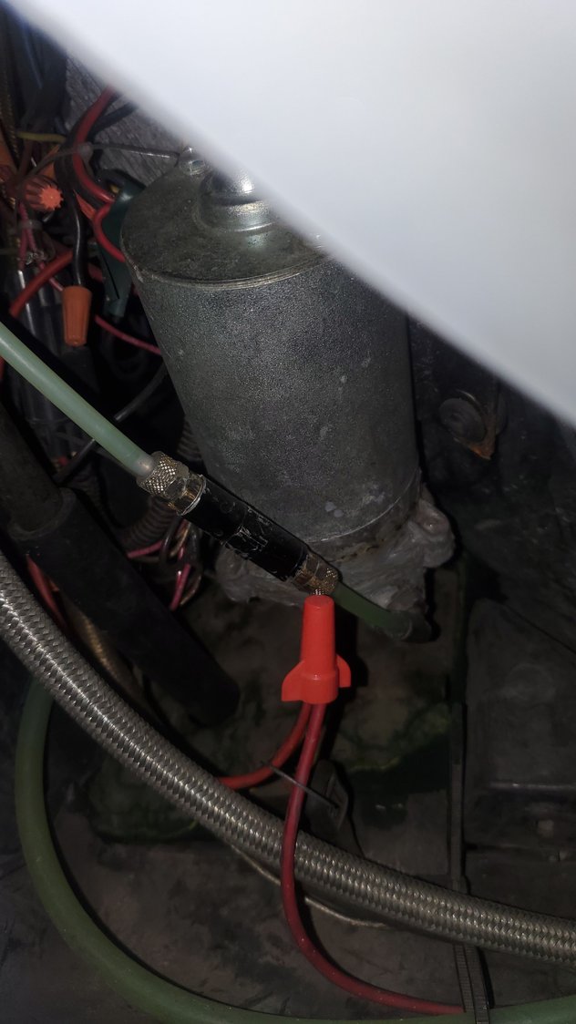

 They siad the pumps should be rebuilt every 3yrs. So i bought a back up. pump and it has about an inch of dust on it.
They said the pumps should be rebuilt every 3yrs. So i bought a back up. pump and it has about an inch of dust on it.
This is after the rebuild.
