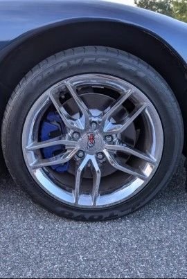

If I may pose a question about tires - it has these rims on it:
A Google search tells me these are C7 replicas. The tires that are on it are 295-35r18 and 265-40r17, which apparently are an odd size; I can only find one match on Tire Rack for $2K for the set. I was hoping I could go back to the OE size of 245/45 R17 and 275/40 R18, which are much less expensive. Trouble is, the rims appear to be 11" and 12", respectively, which it seems that the smallest tire I can put on that width rim is 265 and 295. I'm just wondering if anyone has these rims and can confirm what I'm seeing. If so, I think I'd be better off looking for a factory set of rims to return to the OE size.

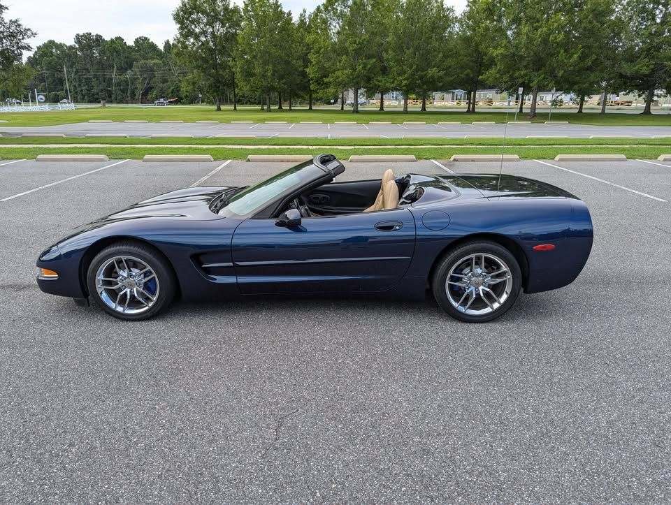

Here's what she looks like - super purdy, and oh so fun to drive! I'm smiling all the way to work these days...

Welcome and congrats on the new car! Those tire sizes are what the C5 Z06 has and they are difficult to find as a set. I would not run a factory size tire for a C5 on those wheels. You should be able to find a set of used wheels on facebook if you decide to go in another direction.

Congrats on the Vert purchase. As for your wheel and tire question, I seriously doubt those wheels are 11" and 12" wide but being replicas, are probably 9.5"-10.5" wide rears and either 8.5"-9.5" fronts. If so, there would be no problem going back with the oem 245/45/17 front and 275/40/18 rear sizes. Lots of excellent tires are available in those sizes and no, Michelins are not necessary unless you just have to have them.

You're 100% right, sir, thankfully. I realize my "through the wheel" measurement was to the outside of the rim, which adds at least a 1/2" on each side. I'm going to order the stock sizes, as I feel confident they will fit on these rims. Thanks for the input!

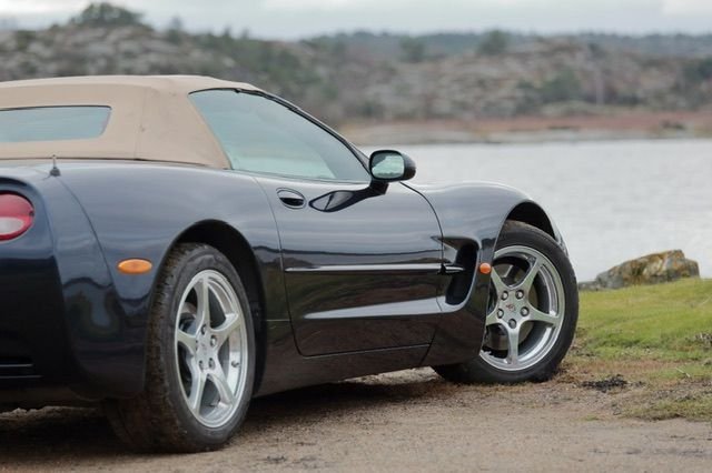

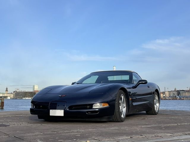

Welcome! I think I have her sister…. 2000 convertible NBMetallic.
Beautiful! I thought I wanted magnetic red, but this navy blue metallic is super sharp, especially with the tan top! Of course, topless is my favorite... 😉
Curious about your orange side markers... Is that something you added?
