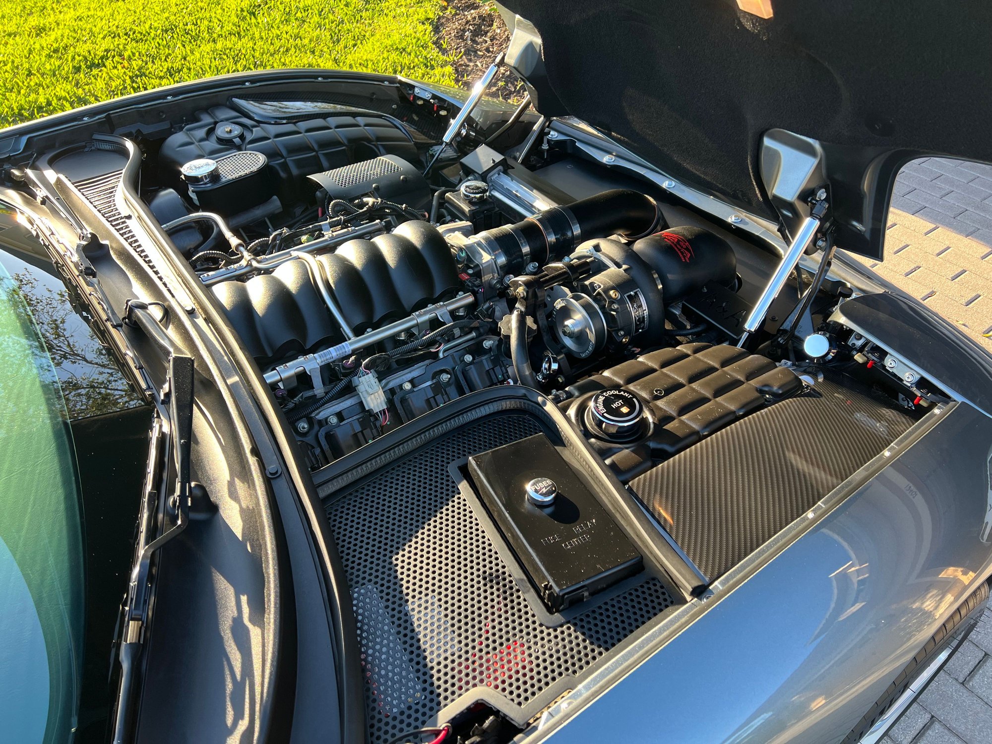

I drove and accelerated my supercharged LS1 through less than 6" of hurricane rain water due to an overflowing storm sewer less than one mile from my home resulting in a hydro-locked engine. Since the C5 is a bottom feeder, it didn't take much and the supercharger took in water like "a hooker snorting cocaine!" (Shop mechanic quote)
As a result, we dropped in a LS3 crate engine and re-engineered the A&A SC with a Stage 1 Texas Speed Centrifrugal CAM and Kooks headers. Car has 660 HP at the wheels and really bridged the gap from the stock LS1 to my C7Z supercharged LT4.
