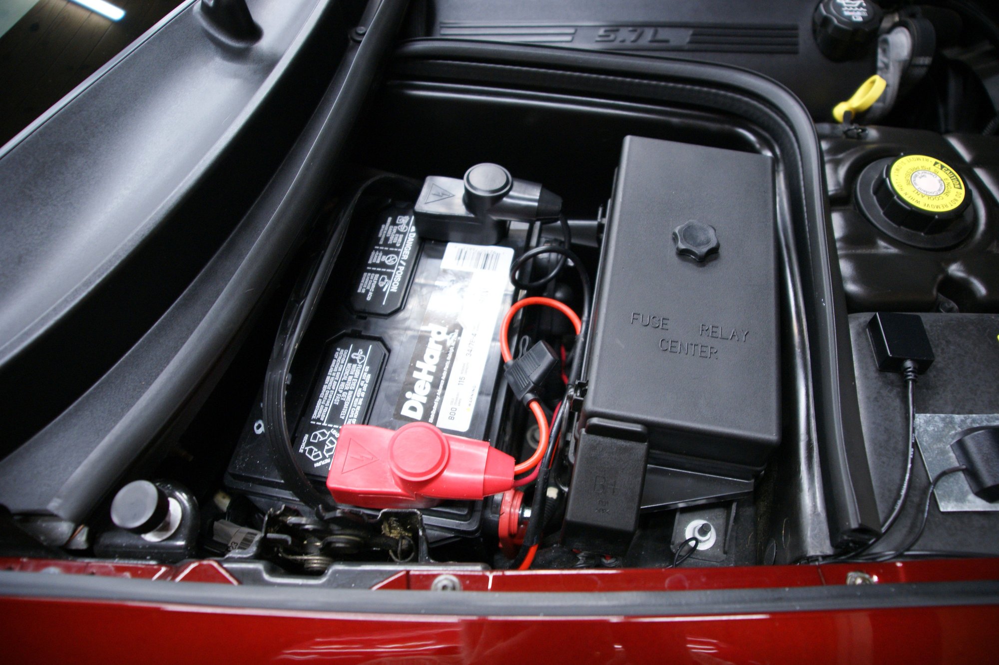

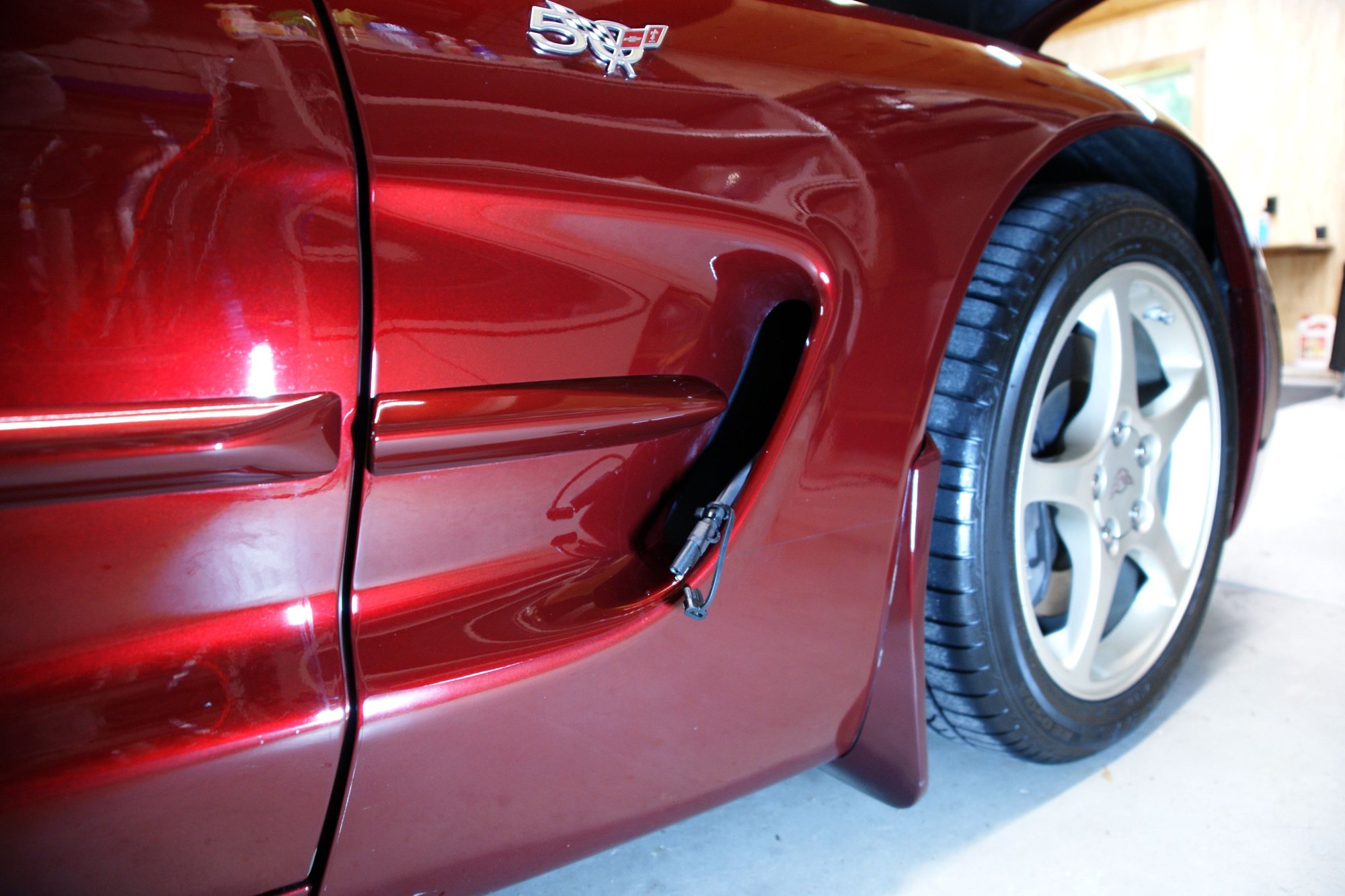

I went with a new DieHard 34/78-4 Silver battery with dual terminals (800 CCA), though the fit was questionable it fit just fine in the stock tray and secured down with the stock fastening block. Connected the stock power leads to the side terminals and my tender/stereo leads on the top posts. I ran the tender wires into the right-side cowling opening for easy hook-ups, and tucks away unseen inside the opening.
