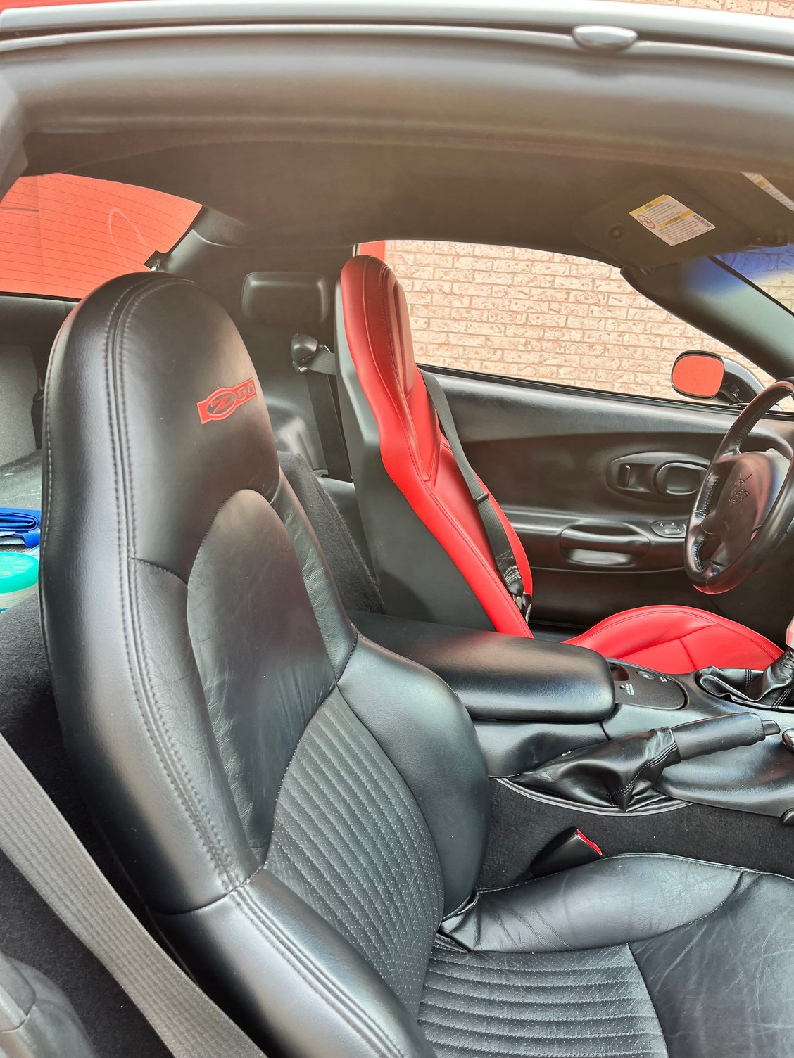

Old May 24, 2025 | 09:50 AM
captain vette's Avatar
captain vette
Joined: Dec 2015
Posts: 3,947
Likes: 1,407
From: Canada
I took that pic when I swap for C7 seats has you can see they are almost the same height although I’m 5’7 so no problem for me.
To C7 seats in a c5
