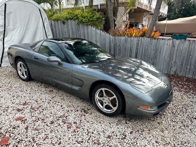

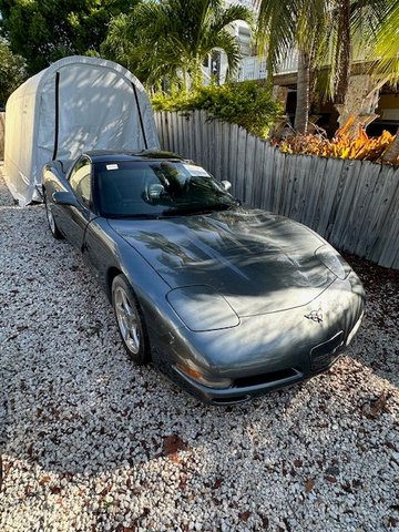

Hello all,
I have been a member here for a long time but haven't had a Vette lately.
I just picked up a doozy but should be an interesting project. I bought a 2004 Spiral Grey on black coupe with 22k original miles. The caveat is that it was flooded in spring of 2024 in West Virginia-maybe the prior owner is in here?
The car isn't running right now. It had fresh water up to about the crank bolt on the outside and maybe 1.5-2in in the floor boards (power seats still work 100%). After being at the salvage auction for almost a year it showed up and still had a hot battery and only a few things don't work. The car is in really nice condition albeit pretty dirty from sitting.
This weekend I am going to pull the seats and carpets and clean / lubricate everything and pull the BCM and fuse panel to determine if either needs to be replaced. Then go from there. I am also going to troubleshoot the no start as I can hear some clicking but not sure if it is activating the starter relay. or maybe the starter is bad.
I fix salvage cars for a hobby, did a salt water flood Mini Cooper S last year I have been driving ever since. I am hoping this one won't be TOO bad to get going.

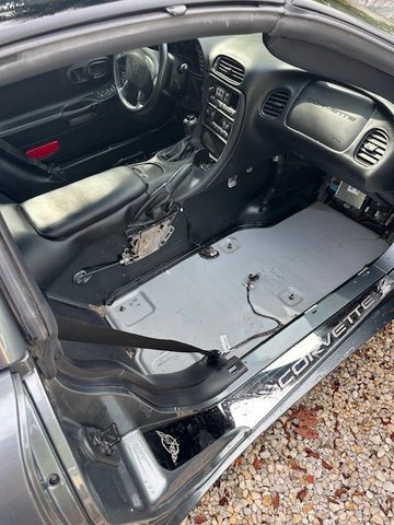

I removed the BCM (had water to the second plug on it) and the interior fuse panel. There was no visible corrosion on anything, just dirt. I cleaned everything and replaced all of the fuses and relays. I reinstalled the units and the car did less than it did before I worked on it. Typical. The DIC says no communication with the BCM.
I went ahead and ordered a reflashed replacement BCM from Dino's and a used fuse box from eBay.

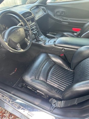

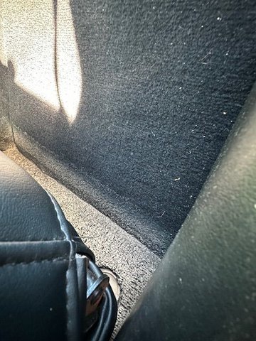

I took out the seats and front carpet, cleaned the inside of the car really well, cleaned the seats and tracks, and power washed the carpet which is now drying outside. While the seats are out I think I will put some sound deadening insulation on the floors and tunnel since I have a box here I am not doing anything with.
After that I washed the car, it is really in good shape-just a couple of spots that need to be touched up.

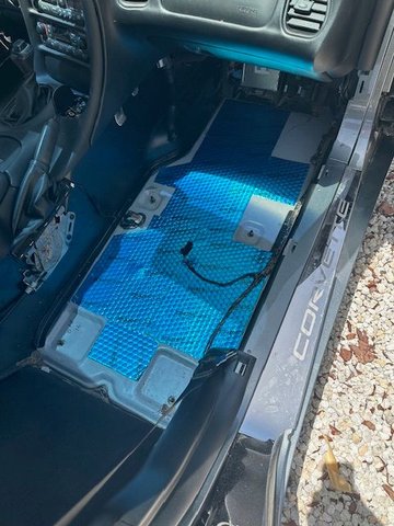

Some progress this weekend. I had some Amazon generic Dynamat type material from another project so I put it on the front floorboards, figured it can't hurt and the carpets were out anyway.
I got the carpet, seats, and trim back in and interior cleaned.
